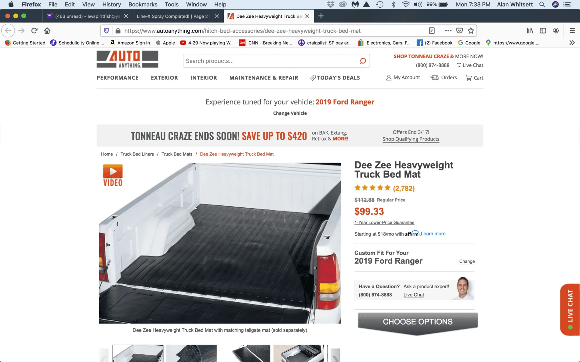

I followed your first link and this is what came up: "This Product Is Not Available For Your 2020 Ford Ranger. " I'll check Amazon... Thank you for the information...

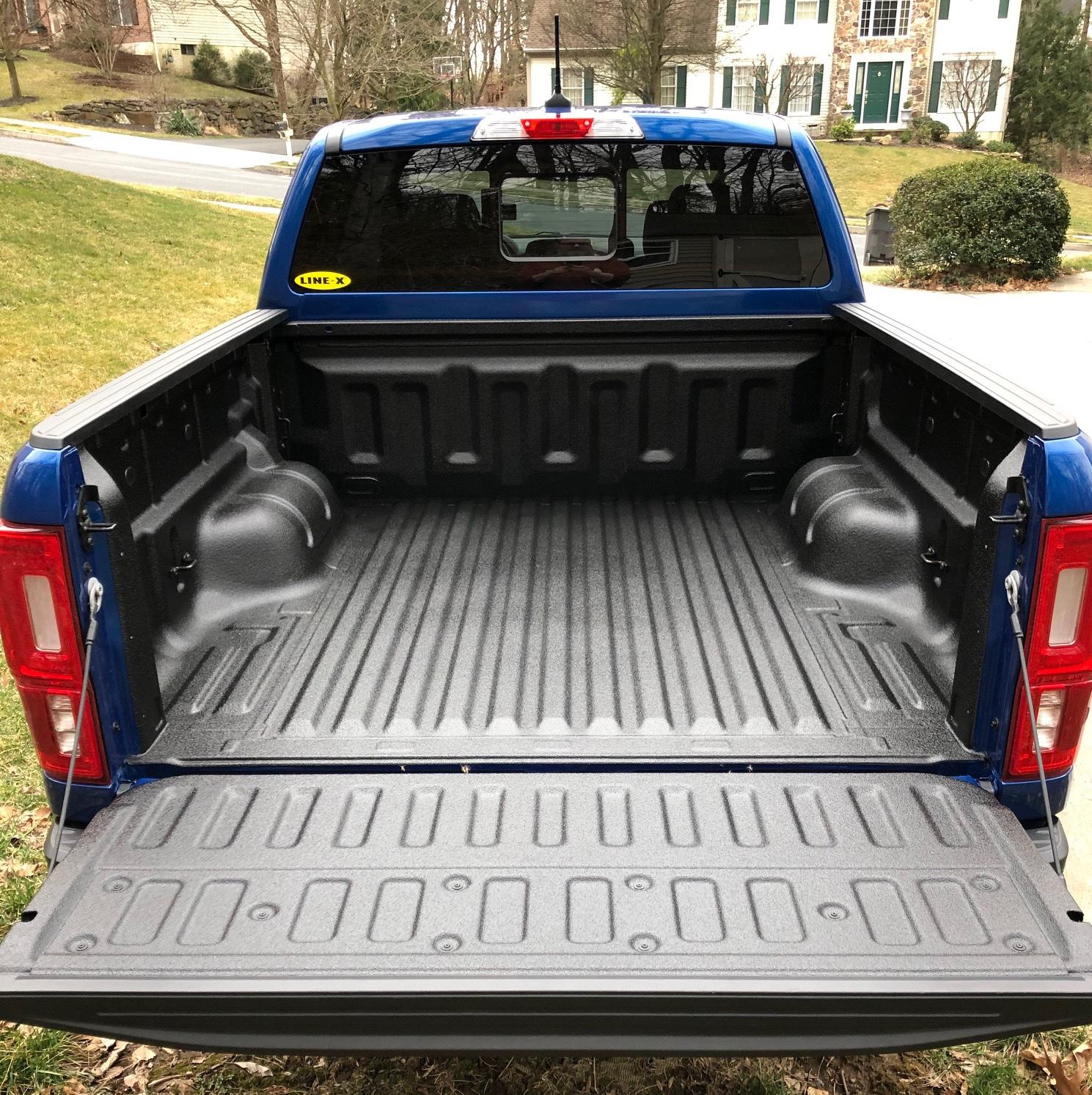

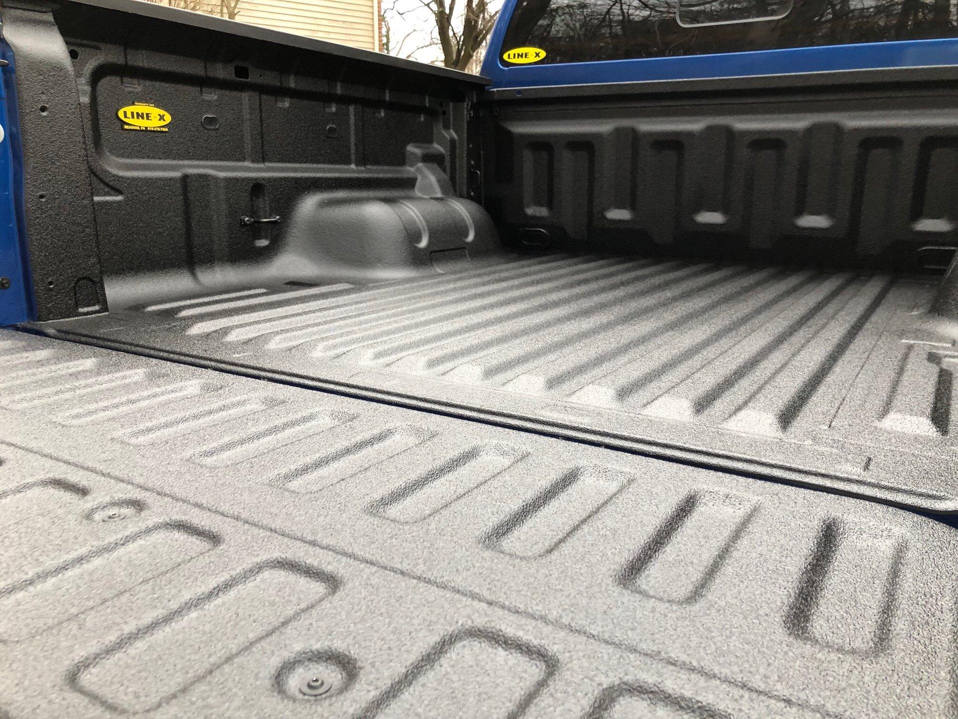

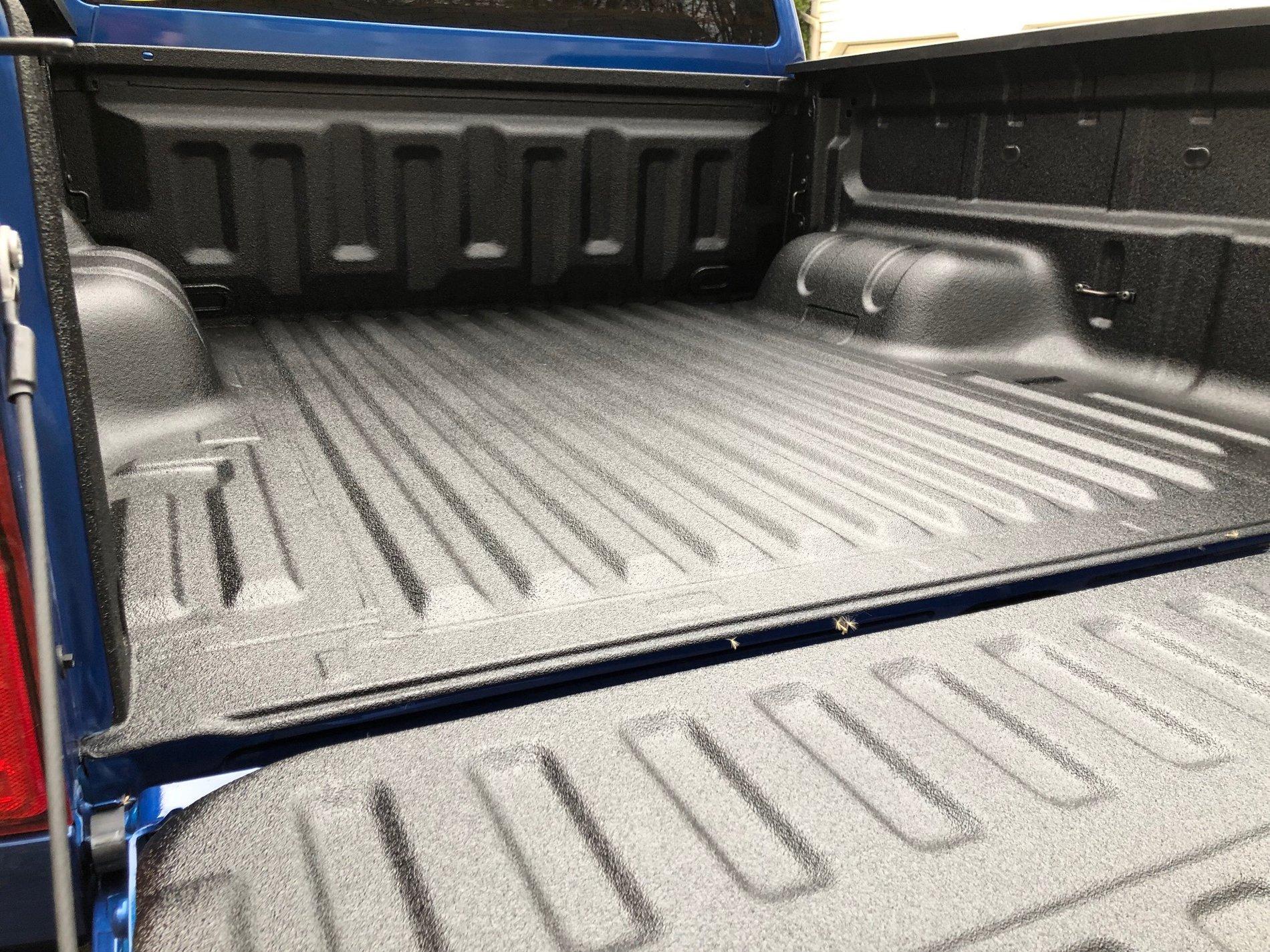

I'll be getting a Line-x job on mine in a couple of weeks. I'm not sure what is the best thing to do with the extra threaded holes for the tie down "U" s. In the pictures (blue Ranger) above it looks like they were simply sprayed over, I guess the bolts will clear the threads as they are screwed in after the job? Or run a thread chaser tap to clear them out. Maybe they were masked or plugged before spraying . the Tie downs don't look sprayed I guess they were removed before the job?
In the pictures it looks to me as though the rubber oval plugs in the side panels were not sprayed over maybe masked or removed? The plugs in the front wall do look sprayed over?
Any and all suggestions or opinions welcome. Thanks!
I'll post some pictures of mine once it is complete, the Line-x guys seem pretty busy! Good for them.

They definitely took out my tie downs when they sprayed mine, as they're not coated at all. If you don't have the tie-downs handy and they cover the holes, yes, a thread chaser should be enough to clean it out to use them again if you add in more tie-down. However, my rubber plugs at least in the front, were sprayed over and not masked/removed.

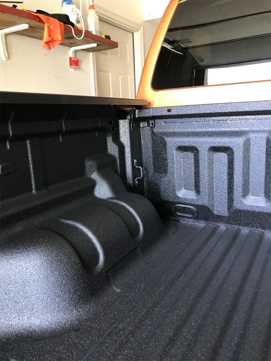

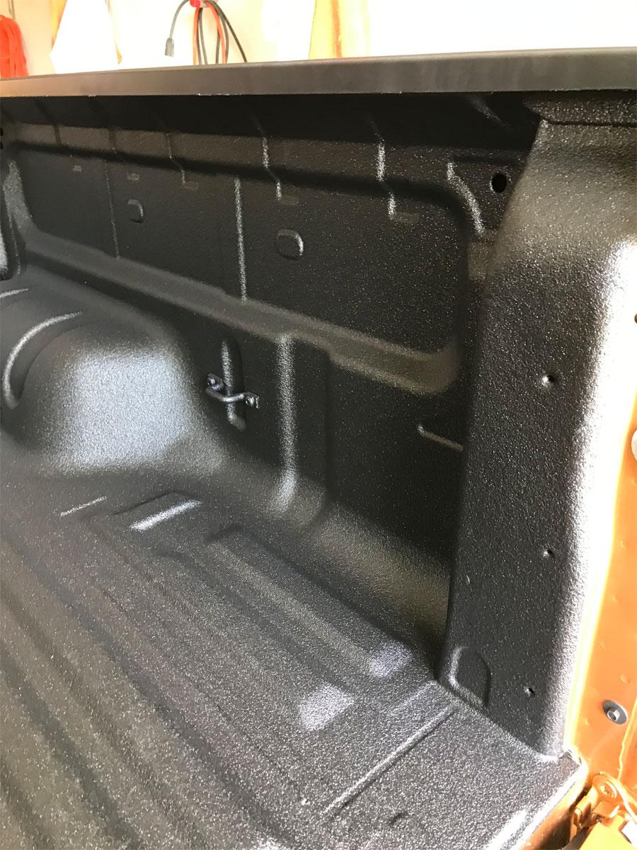

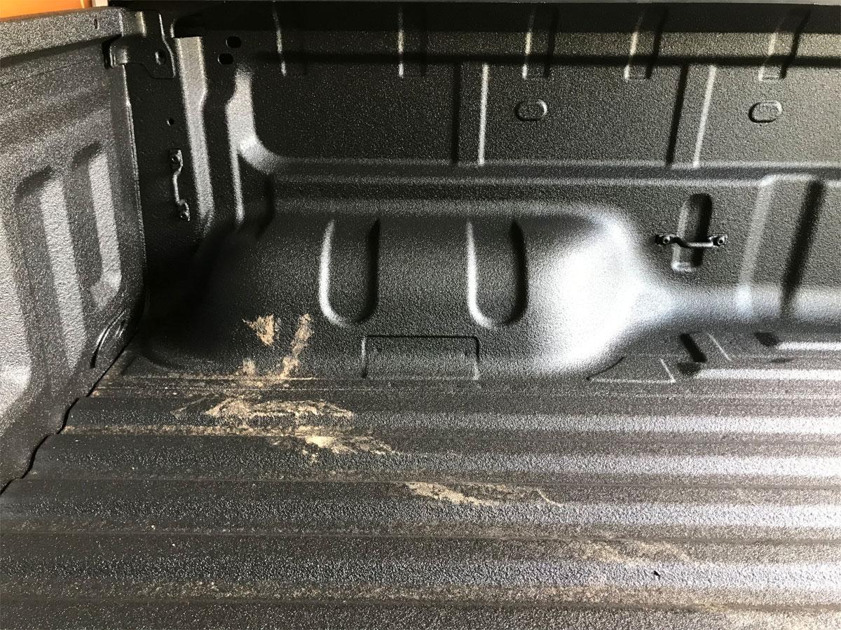

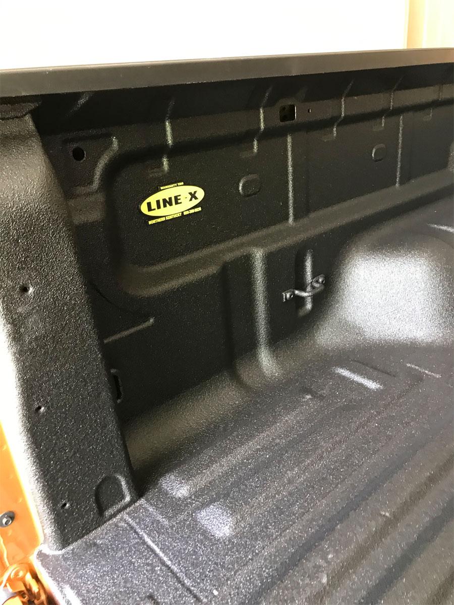

When I had my Line-X put in I made sure they didn't cover any threaded holes in the event I wanted to add something later. They gladly accommodated that. I had the middle tie downs but there are a few others threaded holes like near the side of the tailgate that I think are for accessories of some sort. I'm not sure but the Line-X installer seemed to have plugged them or something per my request during install as they are still open but with the liner coat around them.
Also they did spray my tie downs which is what I wanted. It will keep them from extra wear when using them and from the paint on the tie downs rubbing off and possibly rusting.
So just ask them to not cover any opening you think you need. As for the rubber oval plugs. I suppose they can be used for bull rings. But, as was explained to me they are not really meant for tying anything down of weight as there is no real support around the opening. I think maybe they are more to accommodate drop in bed liners. So I just had them cover them as I don't plan to use them. They did ask me first if I wanted them covered or not.
Edit: Here are some pictures of mine I just took. As you can see unused threaded holes are open and I don't think it would take much to thread a bolt into them if I need to. My tie downs are coated. The oval plugs as per my request are coated over. Please don't mind the dirt in the bed, I recently had something muddy in it and have not had time to wash it yet. :)
