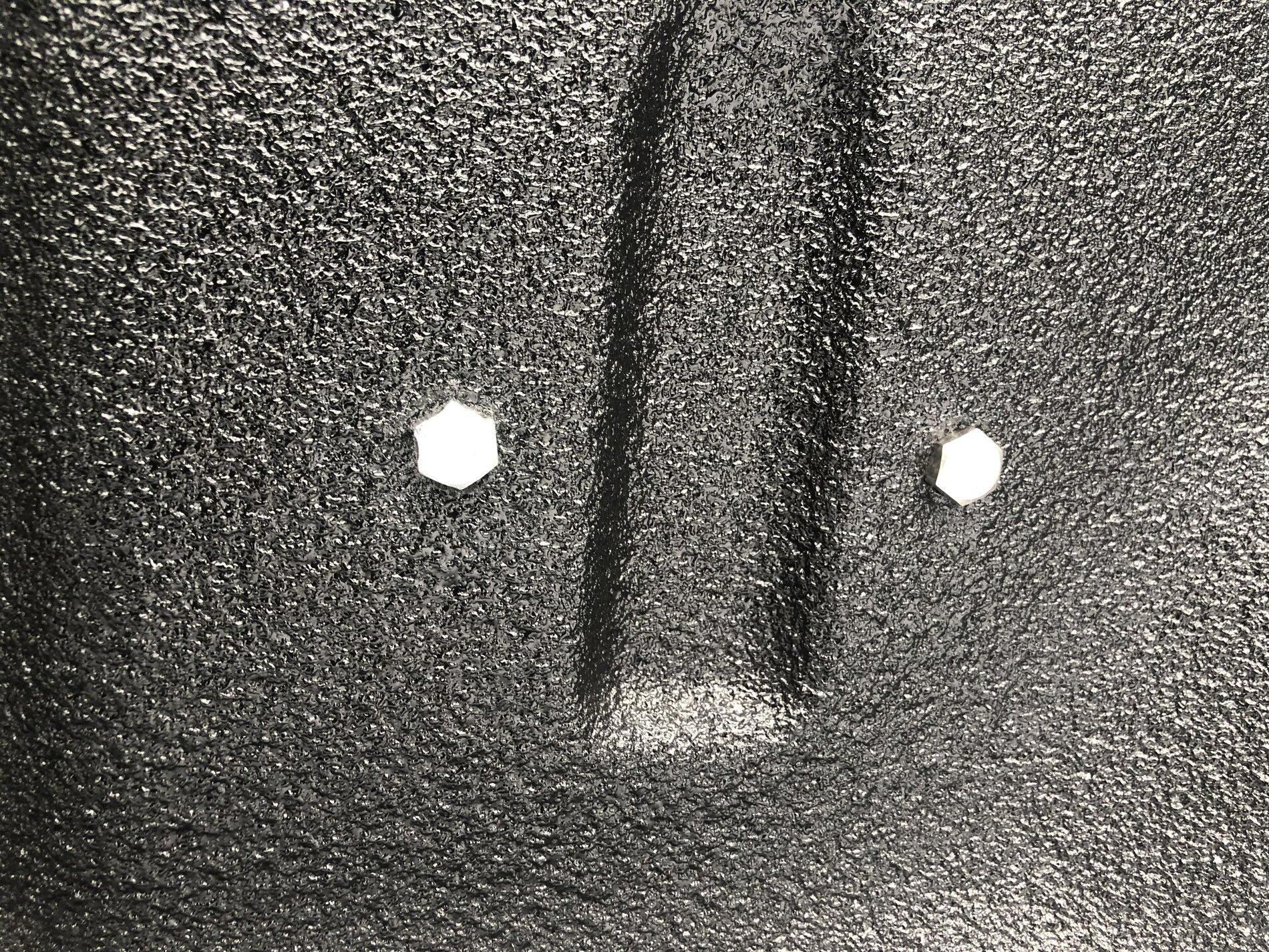

Yes, exactly. I am having a Line-X liner installed next week, and bought both sizes of bolts and insertd them in all of the empty bolt holes so they don't get filled up with liner material. Is that proper, or should I have the Line-X installer fill the blt holes with someyhing else before spraying?
7,084
37,221
Hi Noo,
Should work, but I would suggest you leave the bolt head out away from the hole so the LineX can coat the bed inner wall and not leave a hex of uncoated area around each bolt hole.

Thanks. That's what I was wondering. I think I'll screw the bolts out several turns and mention them to the installer so he knows why they are there. If he has a better technique, we can discuss it.

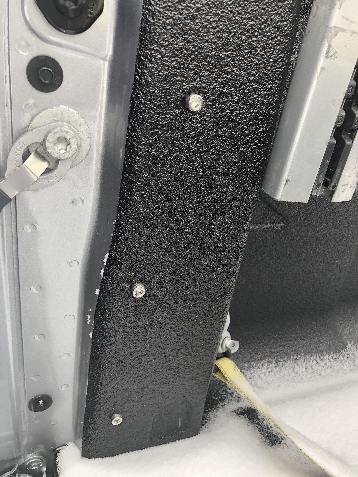

There are also some empty bolt holes along both sides of the bed just behind the cab. They hold 8mm x 1.25 bolts. The ones near the tailgate hold 6mm x 1.00 bolts.

Just get some Golf Tees and tap them in. When done with Line-X or Rhino, pull them out and replace them with Stainless Steel 6mm and 8mm bolts. That way you have them there whenever you want to add anything like a tie down D ring.

Yep. Had my Line-X liner sprayed in last week. The installer removed the bolts I installed and used golf tees to protect the threads. So now I have the bolts if I ever need them for anything. The Line-X liner looks really nice.
