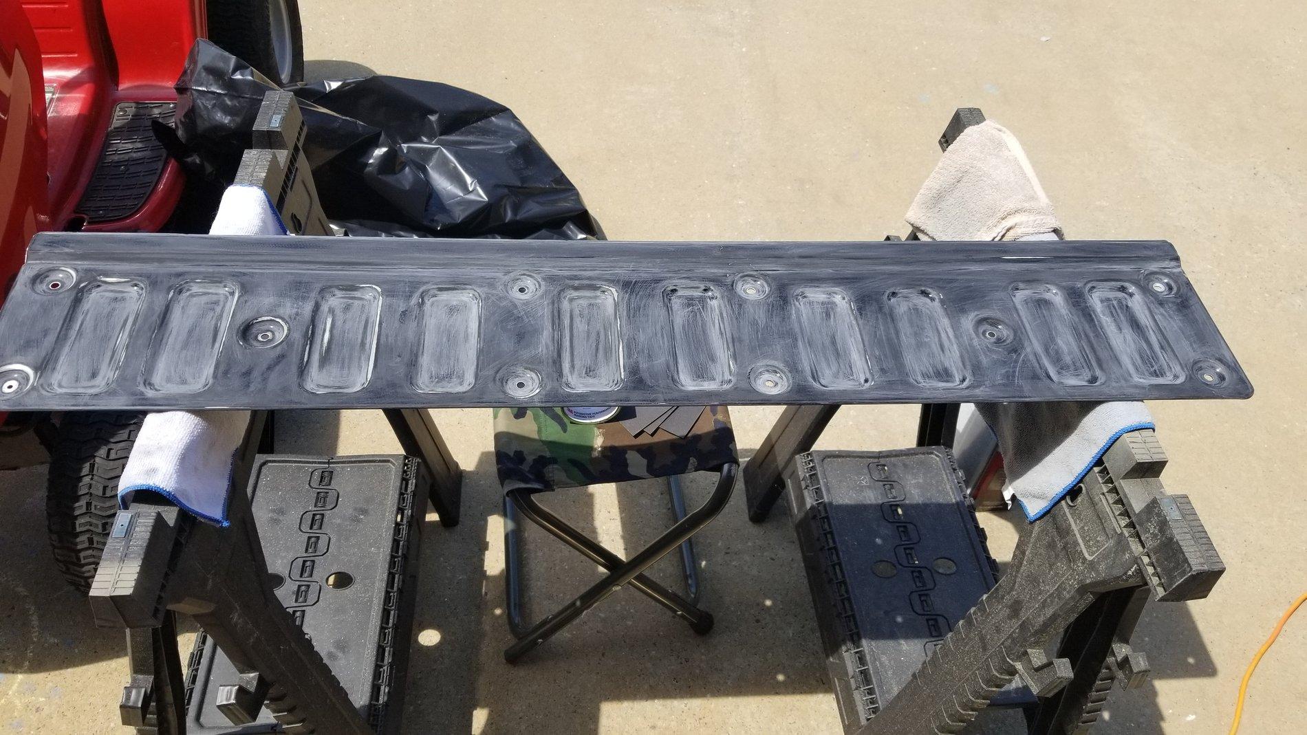

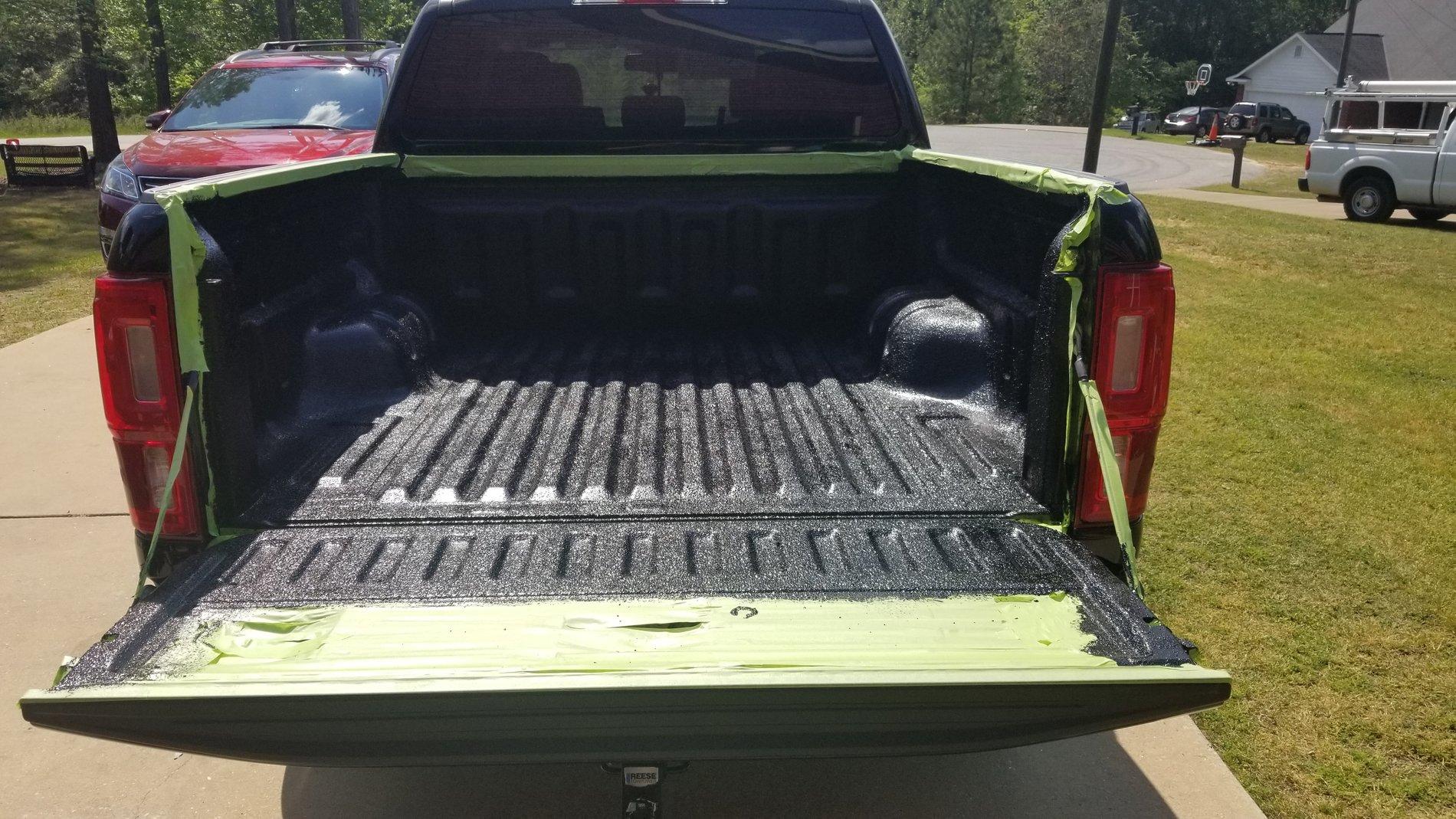

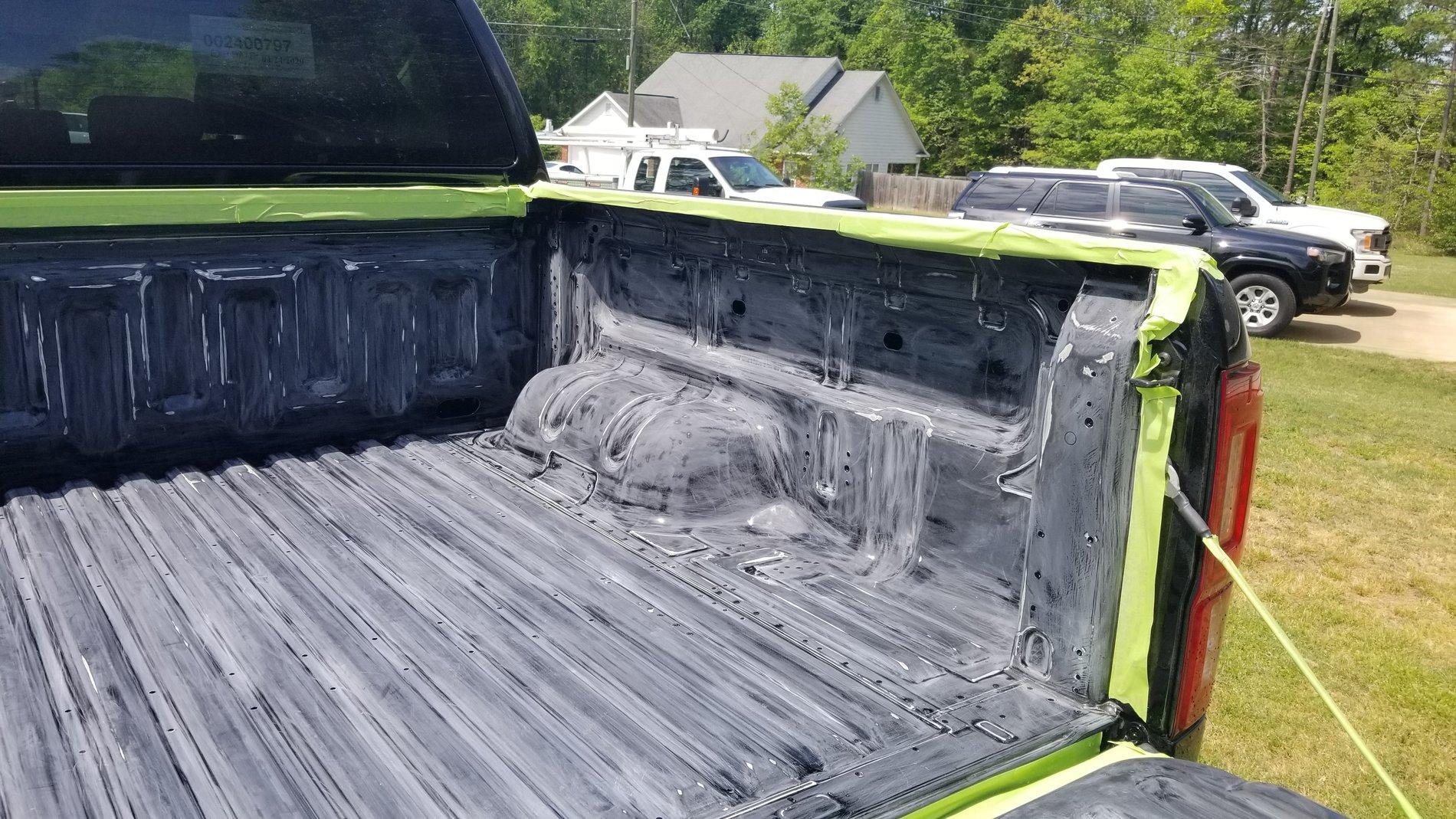

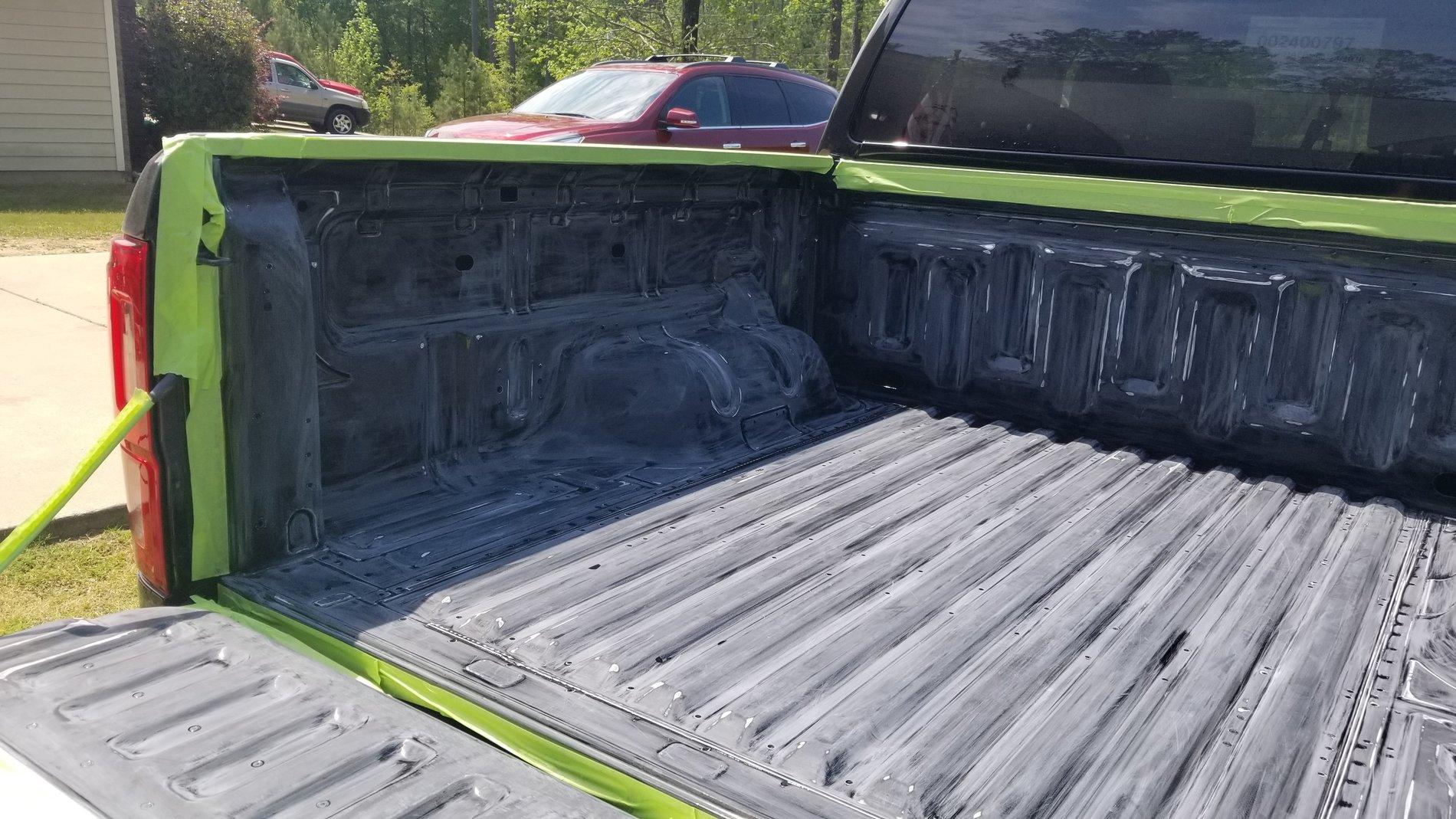

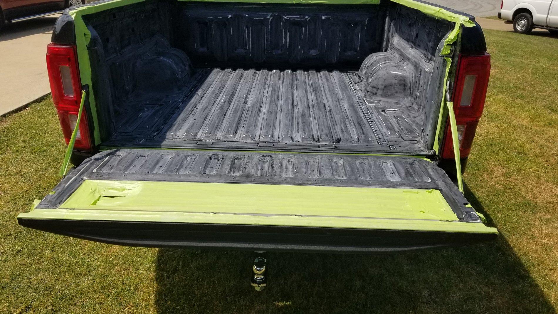

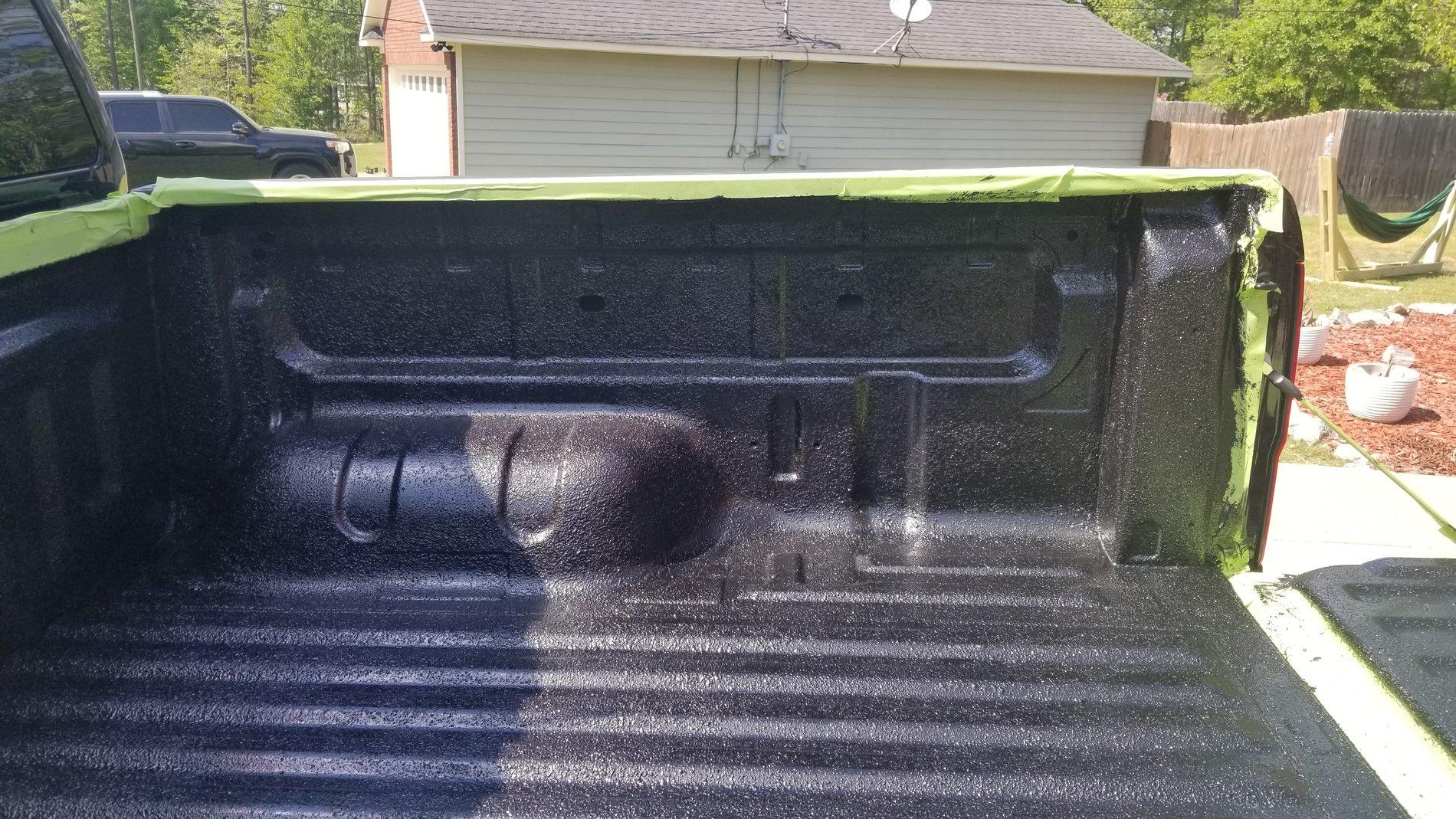

Did the Herculiner myself yesterday and today. Prep took me all of yesterday afternoon. A few points, the green scotch brite pad that comes with the kit to "scuff" the clear coat up so it will adhere is garbage...the only thing it was useful for was to help clean any of the liner off my arms that I managed to splatter on myself while rolling ?. The better the prep the better the final product is what everyone said, therefore I took my time. I used 180 grit sand paper and a ton of elbow grease and a few beers lol. The masking took almost an entire roll. I just finished the 1st coat now need to wait 1-4 hours until its not tacky to hit it with the second coat. Then re-install the tiedown hooks and factory 3 panel hard locking tonneau cover. It says its ready for light use after 18 hours. The kit was $89 bucks at autozone and I also picked up a gallon of acetone which hindsight was a bit to much but at least it was more then not enough!

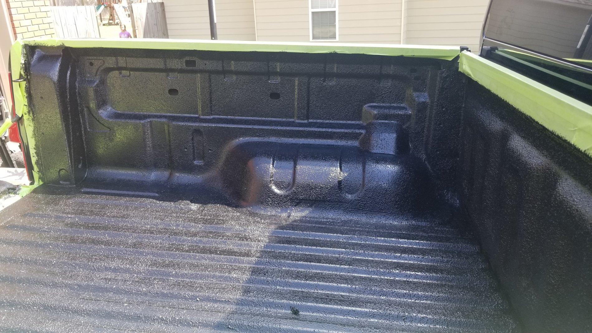

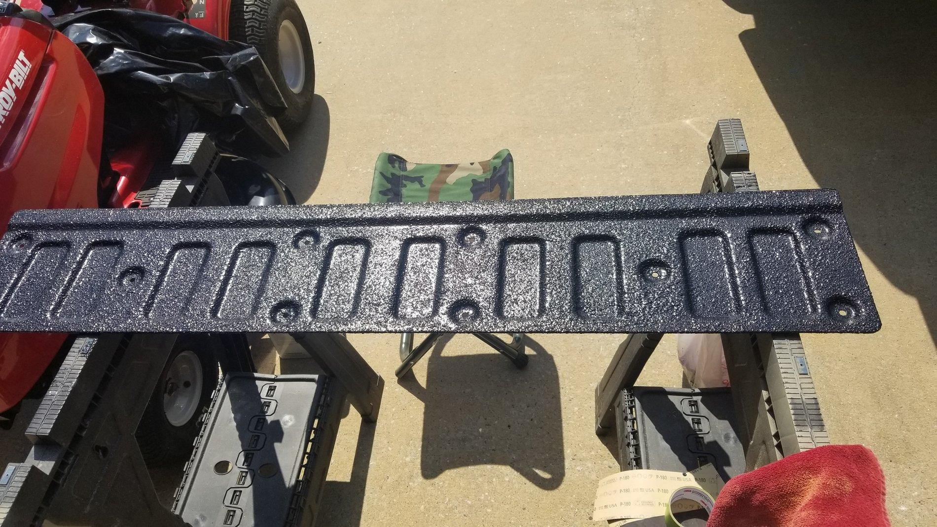

This is after the first coat. Its super thick. It comes with a brush to hit all the contoured spots that's tough to get with a roller but the roller did better then I expected. Ill post final pics tomorrow. I sanded it all really well with my sander as well as by hand everywhere the sander couldn't catch. I continuously blew it out with my air compressor and after i thought I was done blew it all out good, washed it out with regular dawn dish soap as my car wash soap has a wax additive in it, then let it dry and wiped it all down with acetone. After that was done I hit the spots that were still a bit glossy with more sanding and washed it out and used acetone a last time. Then started to apply. I bought an additional spray can of Herculiner as well for touch ups if I ever need it. So far so good. The application is super simple, its the damn labor of sanding as to why shops can charge 500+. It might be worth it lol but I did it for about 100 bucks and 2 days of labor as we "socially distance".

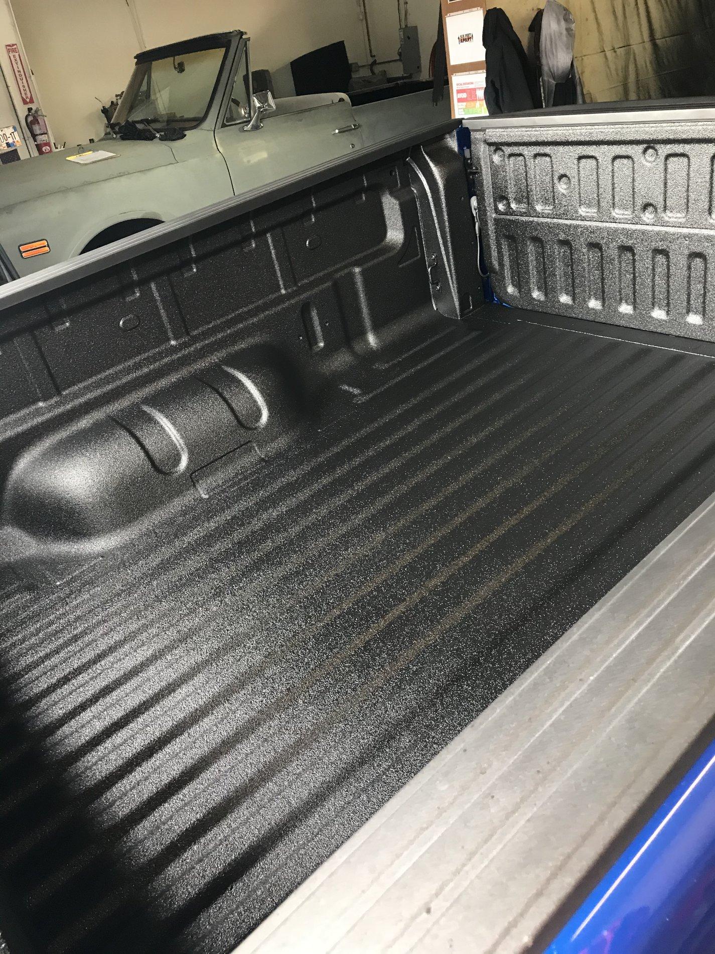

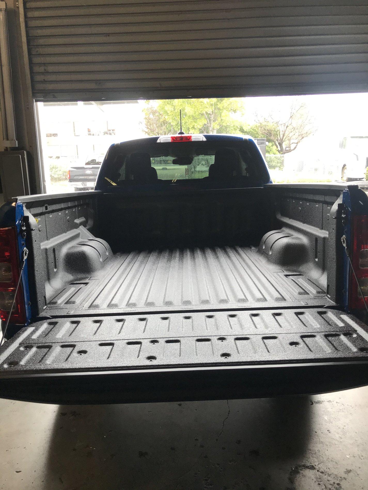

Got my liner installed today in San Diego. Said they were doing a special on the UV protection. Got that on the bedliner OTD for $516 for a 6 foot bed. I think they call it the “Premium”

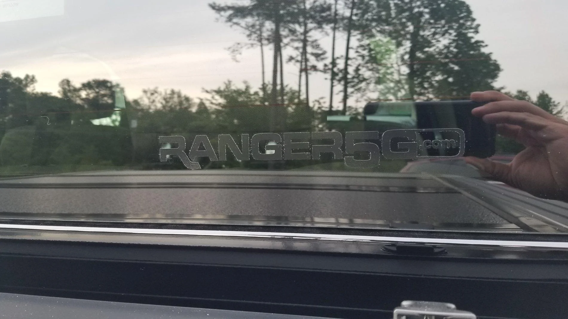

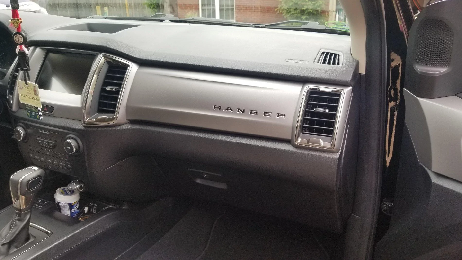

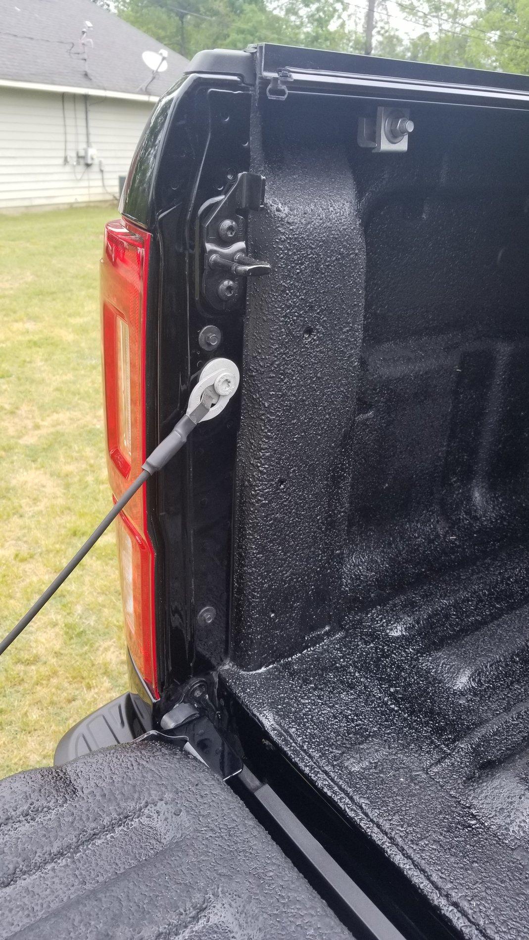

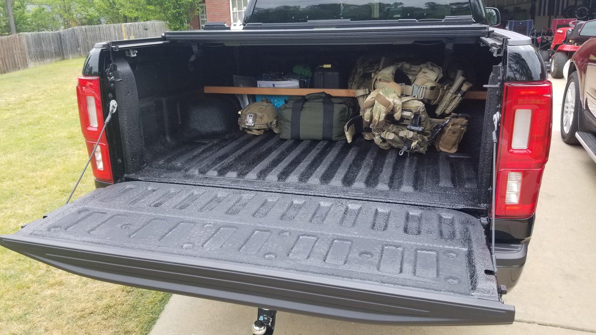

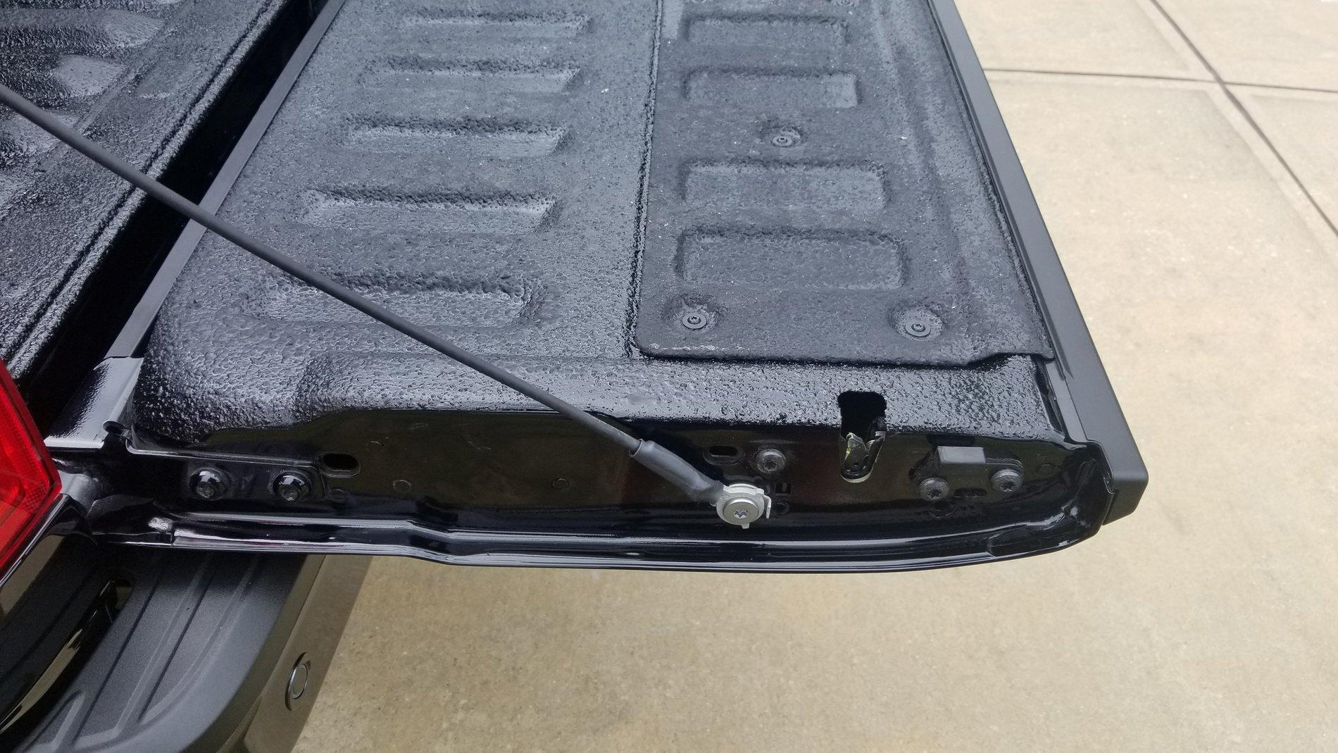

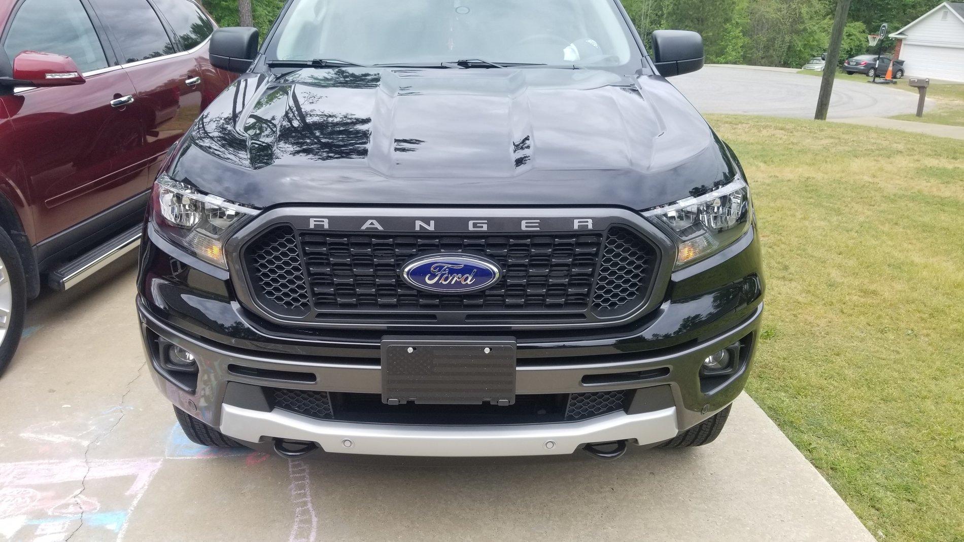

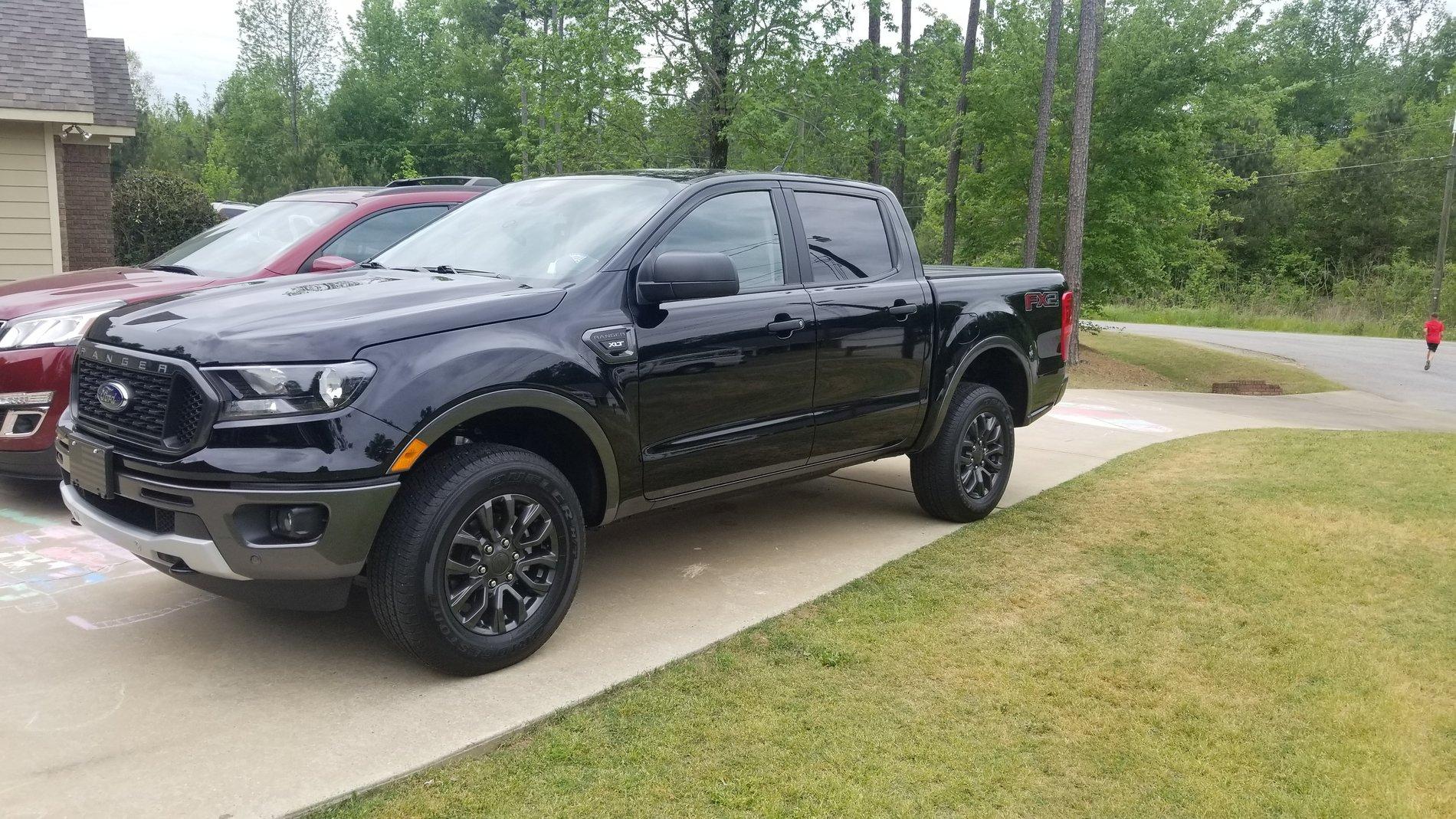

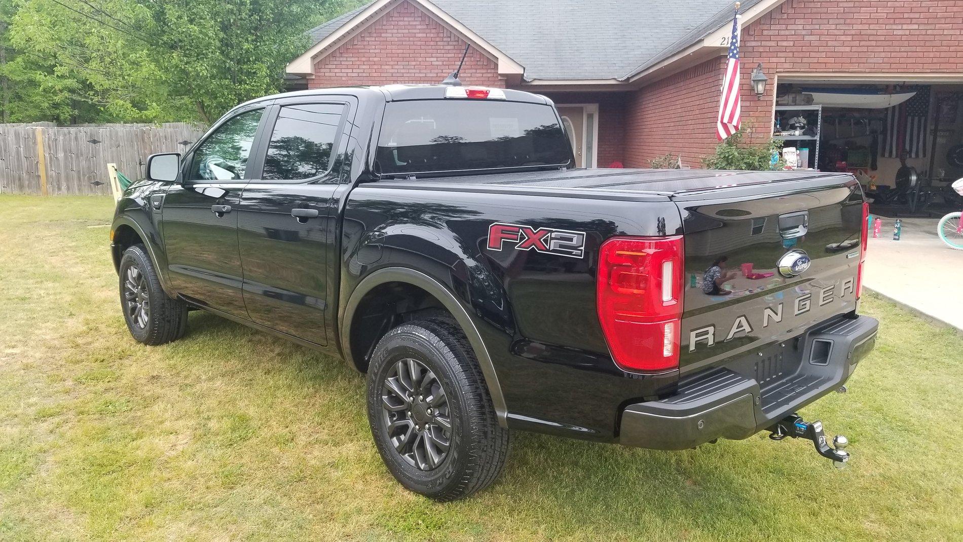

Here's the completed back in use pictures of mine, and a few extras. I added the metallic grey inserts in the front to match the tail gate as well as black metallic ones on the passenger dash. Black Nerf bars coming next week as well.

Nice truck!! Thanks for your service!! Cool helmet too

Man I'm telling ya, I did the Herculiner myself just for that reason. I called the dealer for linex and they quoted my over 600, then I called the linex place in town and they quoted my 535 and said yeah a dealer just called here for the same vehicle! I bought the kit for 89 bucks at auto zone and put in some prep work and elbow grease and I'm happy with the results! It's all about the prep work my friend.

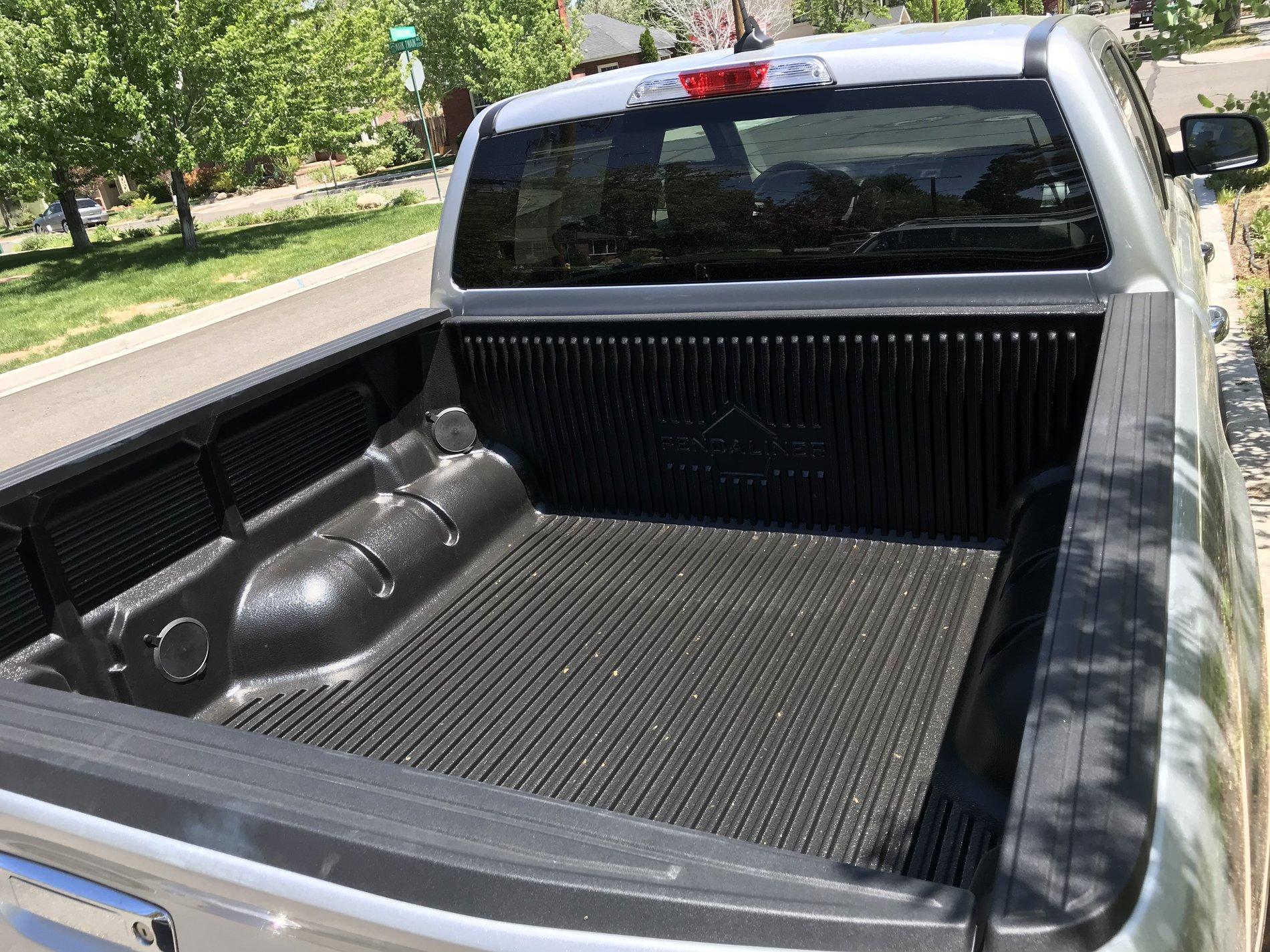

Yep, couldn't be happier. Identical to the Ford drop in liner except for logo. Took about 15 minutes to install.
