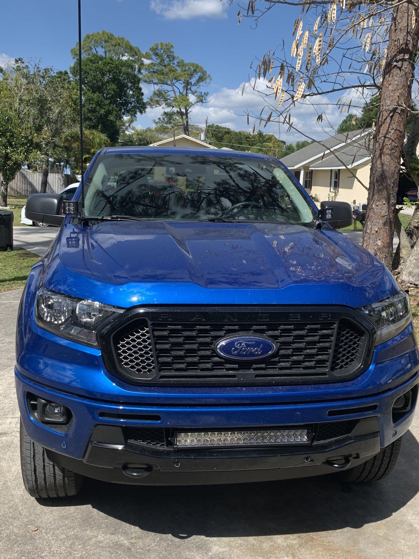

For the folks still struggling with light bar brackets in the front that cannot block the radar unit. I've had this on for quite some time with no issues. It's sturdy, comes in different sizes and multiple holes for different types of lights. I have a 30" curved light bar on mine from Rough Country.

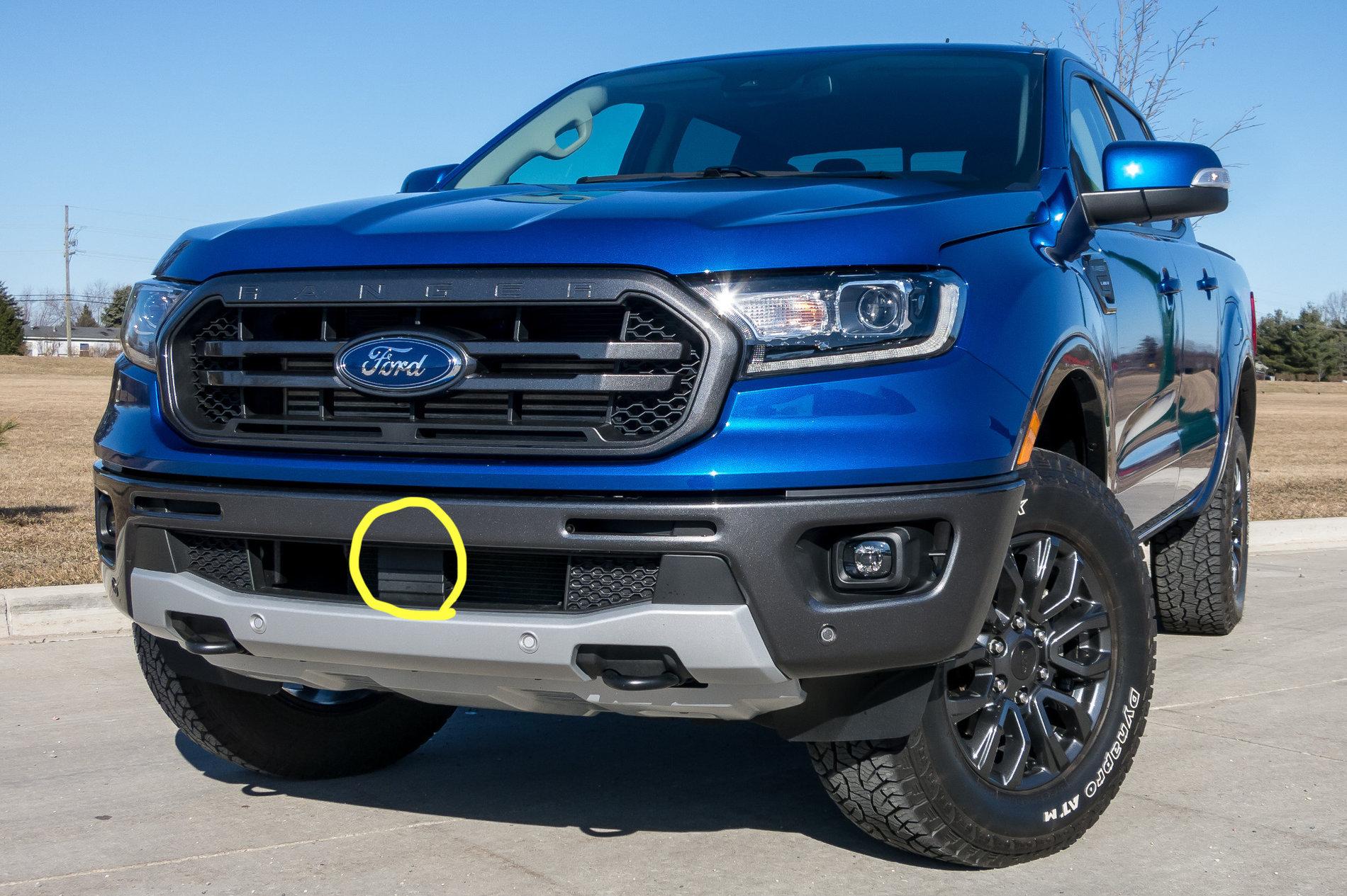

The Adaptive Cruise and the Pre-collision sensor are one in the same. I you don't have one then you don't have the other. It's simple, if you have the big black sensor in your font bumper opening then you can't fit the light bar. If you don't have the sensor then you can fit the light bar. It's huge, you literally can't miss it.

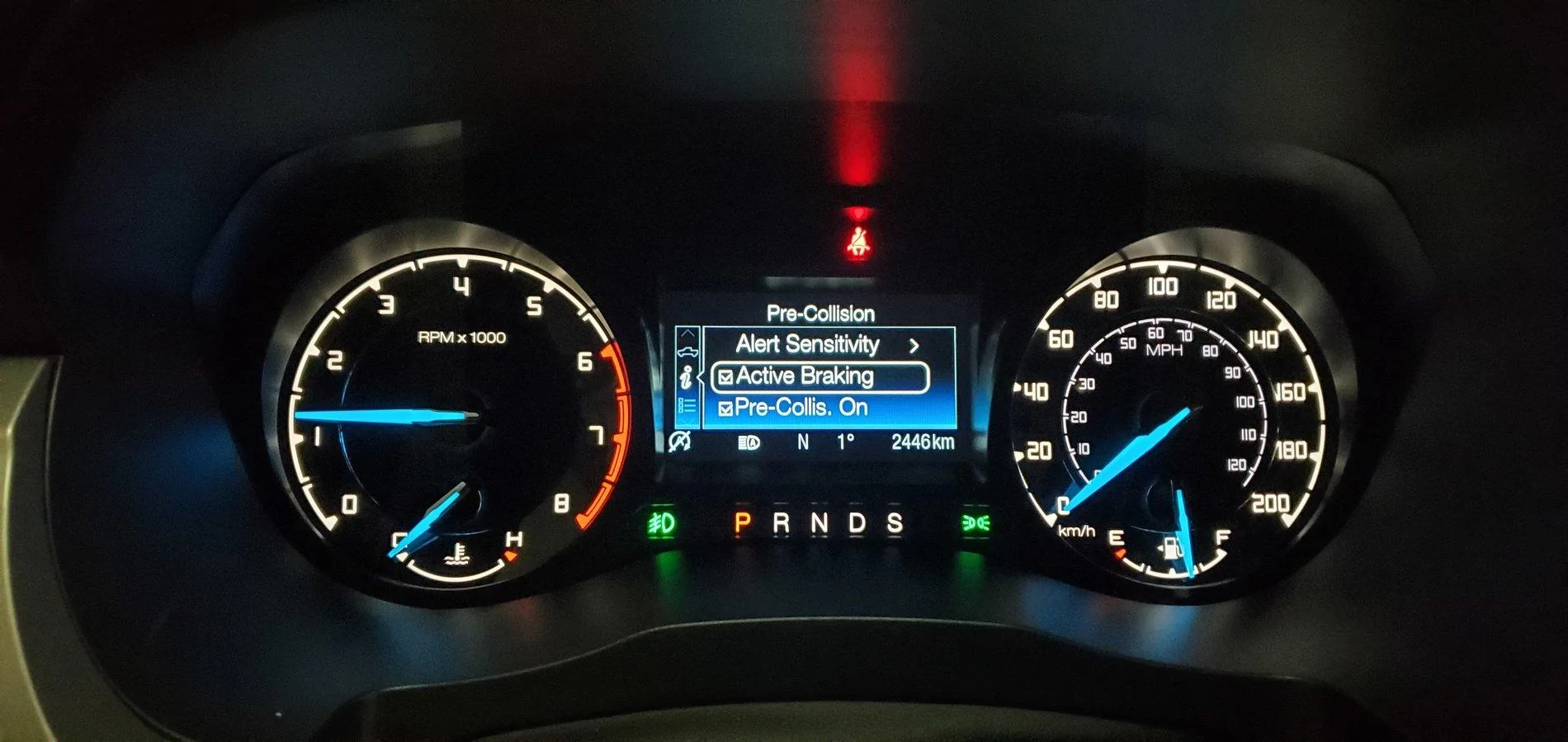

So I double checked and I definitely dont have the sensor down there blocking my future light bar.
But I do also have the pre-collision assist w/ AEB. This must be different sensors?

Well it must be in a different location if you don't have ACC. I'm going off my personal truck which has both. When I was installing my new bumper, I fired the truck up before I had installed the ACC relocation bracket and plugged the sensor back in. When I did, the truck lit me up saying that ACC and collision avoidance were unavailable. Plugged the one large sensor back in and both work again. Not sure where it would be if you don't have ACC, perhaps it uses the parking aid sensors in conjunction with the camera by the rearview.
