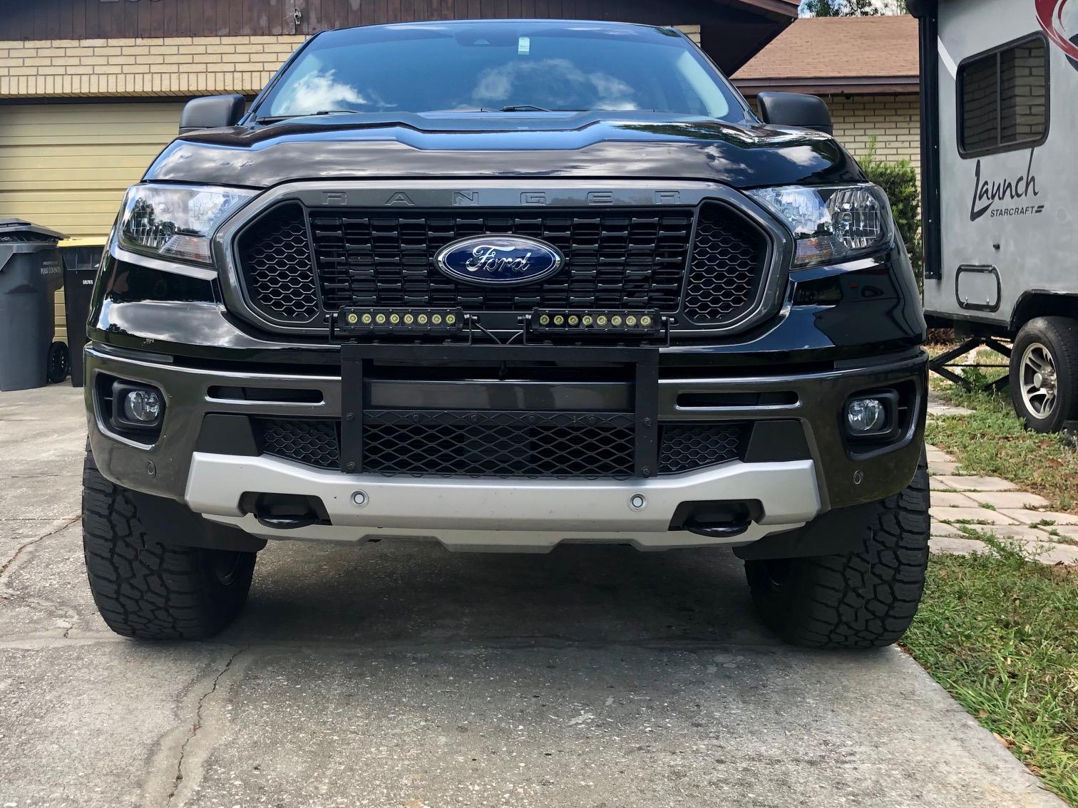

I made a small, low profile Bull bar to mount 2 high intensity 8 " light bars, and used expanded metal to cover the open area in front of my sensor to protect the radiator behind it from any debris that could get in there while driving.
Doesn't the metal affect the use of the ACC? I know they sell a plastic insert, but i thought metal would reflect and cause issues.

Expanded metal surface area is small and doesn't seem to interrupt the radar. I've used it to protect signal wave amplifiers in industrial applications previously. I installed this setup six weeks ago and has worked great so far, with no issues to date. If any issues occur, I'll be sure to post an update.

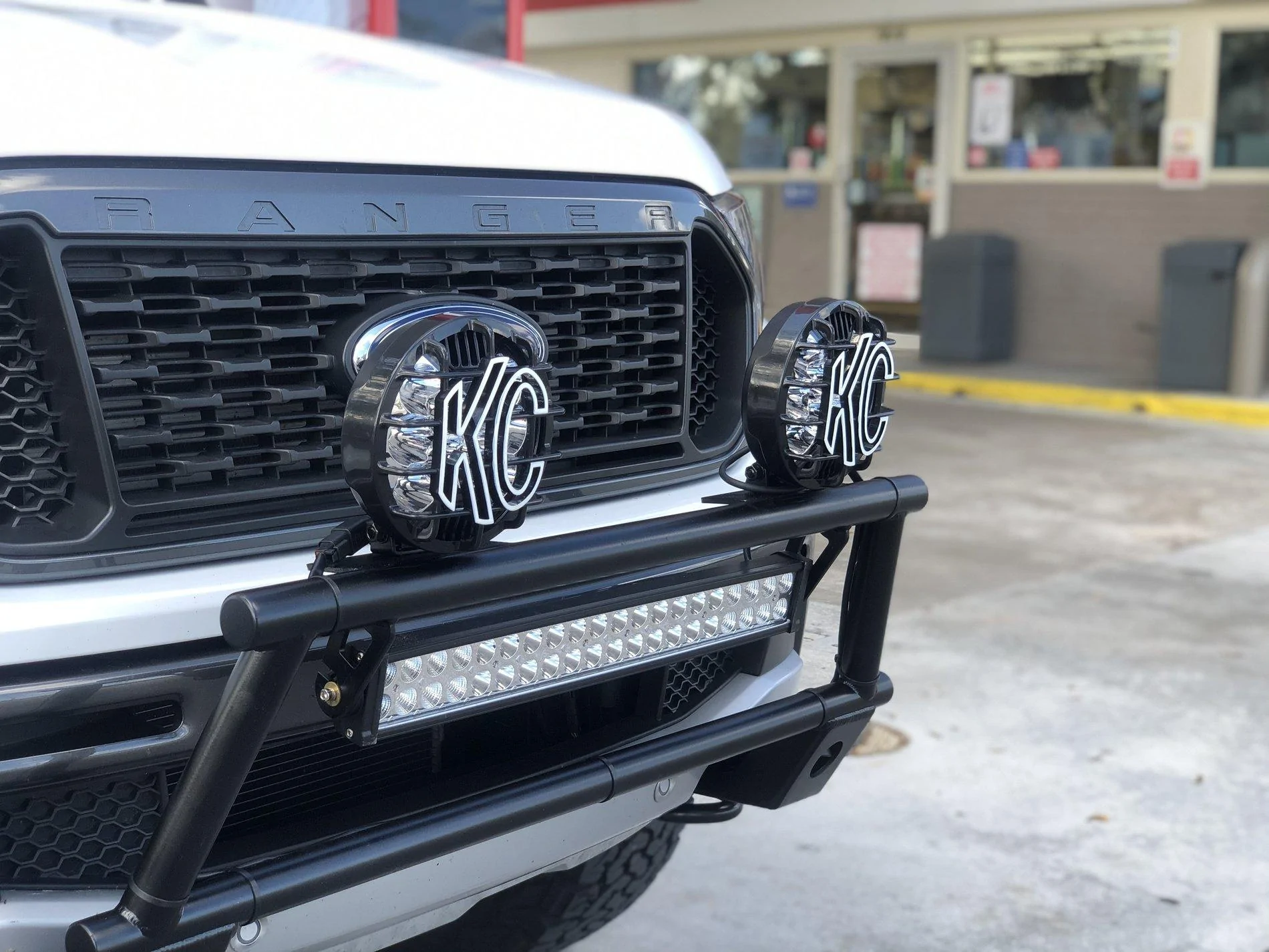

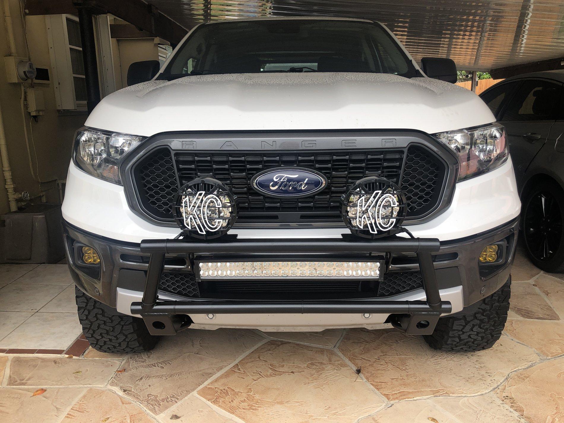

Anyone mounted lights on their ranger yet? Too scared/ don’t want to deal with the wind noise of a roof top light bar but I’m thinking about ditch lights, a small light bar in the lower fender area, and reverse flood lights.
Here's my Impulse Offroad light bar and its adornments. FYI, I hear practically zero wind noise.

I like this a lot, but it runs right in front of the ACC sensor.
Yes it does and I can’t say it hasn’t been an intermittent problem -occasional spurious beeps. I’m researching some potential solutions and will keep everyone posted here.
