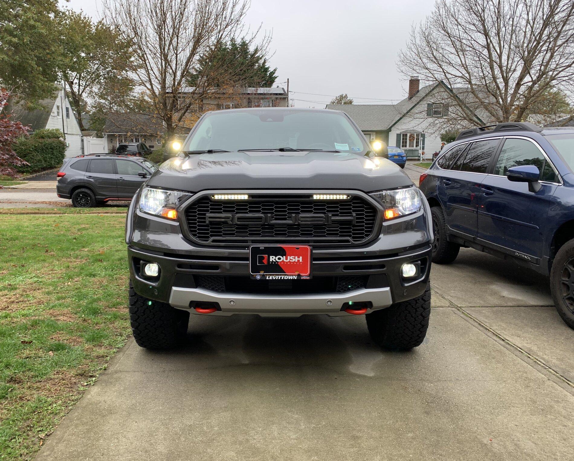

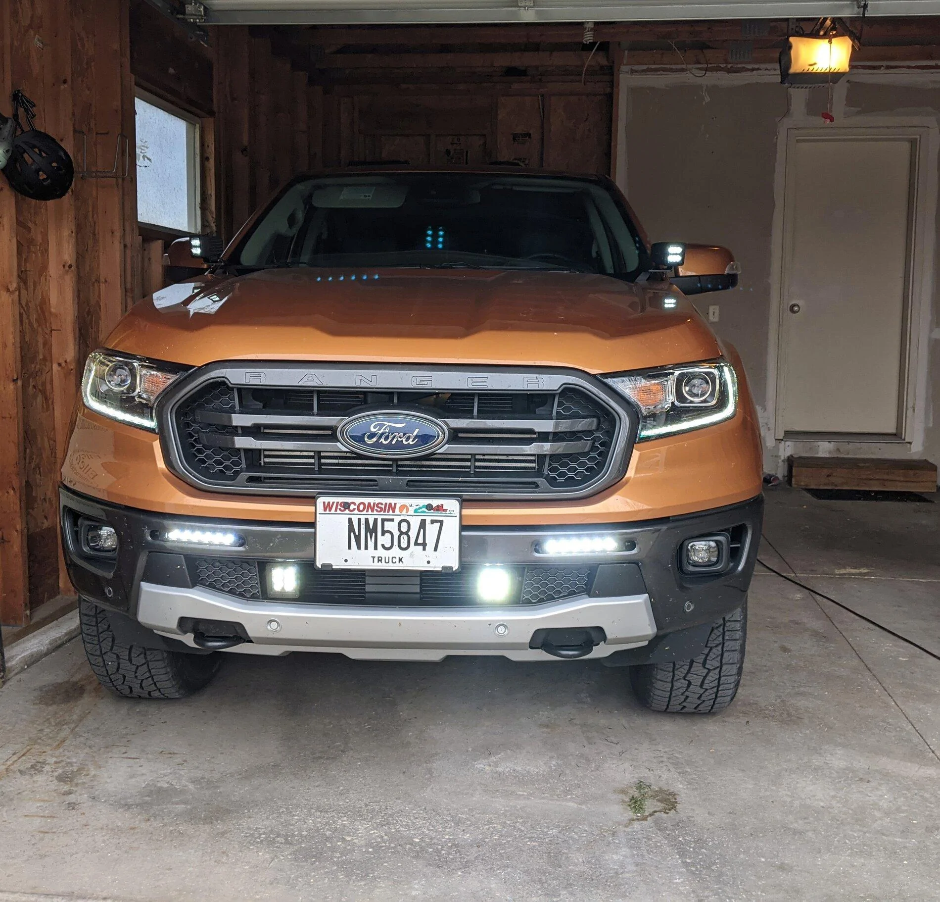

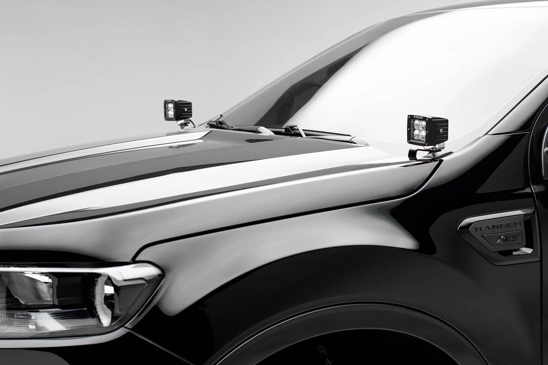

I'm pretty torn about going for ditch lights on the A pillar or not. I've already got two 6" light bars, and two pod lights upfront... so are ditch lights too much? I'm not sure they look that great since the ranger has such a round shape, I don't want them to stick out like a sore thumb. They look kickass on a Wrangler, or a Taco... but it might be too much on a mostly stock Ranger?
On the other hand, it's SUCH an easy install that it's really a low barrier to entry.
What say you Ranger 5G Forum? Send it or stick with the unassuming lights?
Picture for reference:

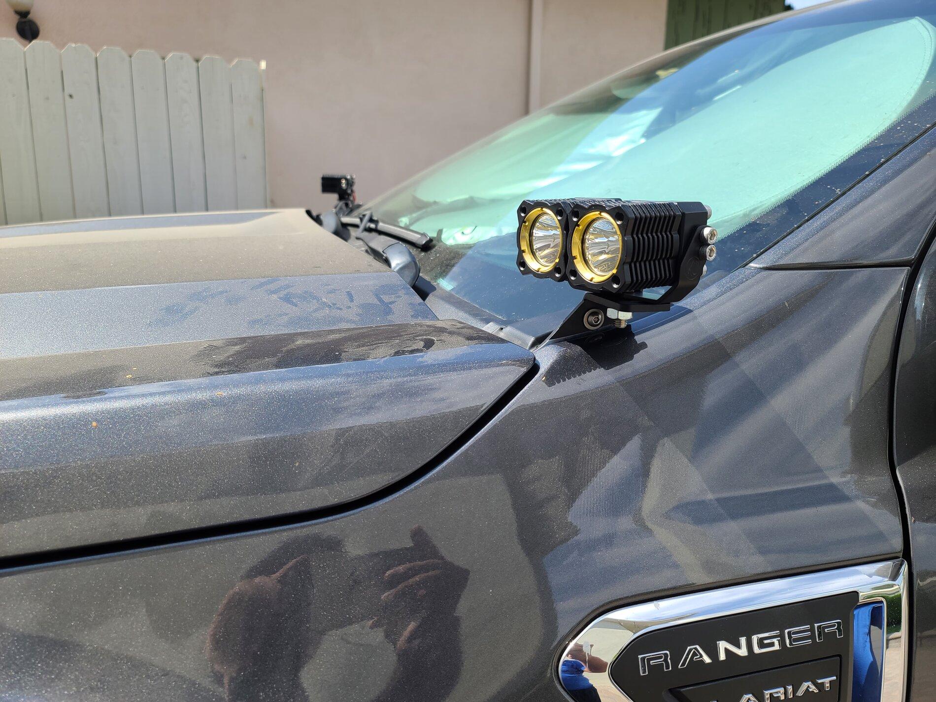

Lights are done. Level, tires and air dam removal next.

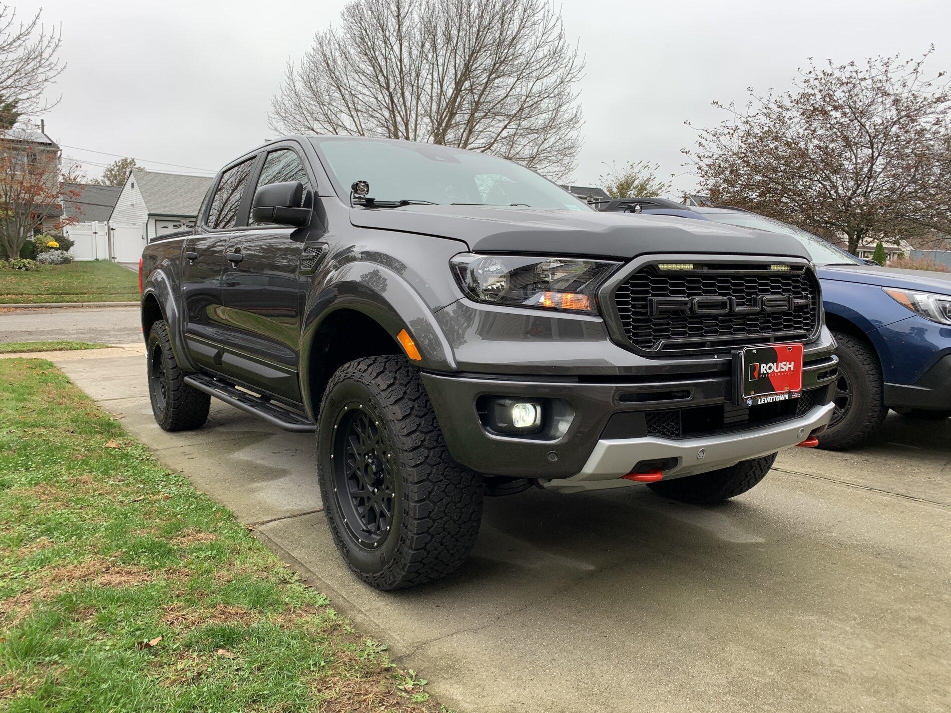

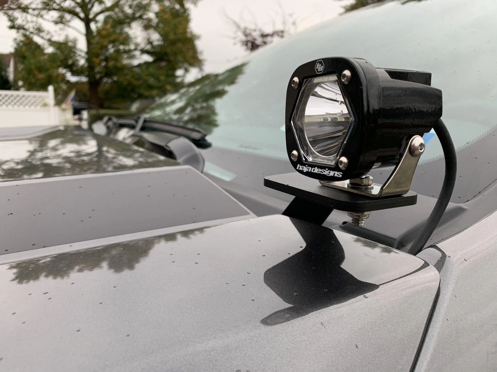

I like the low profile look, so I installed baja designs S1 led spot lights
with Diode Dynamics hood bracket.

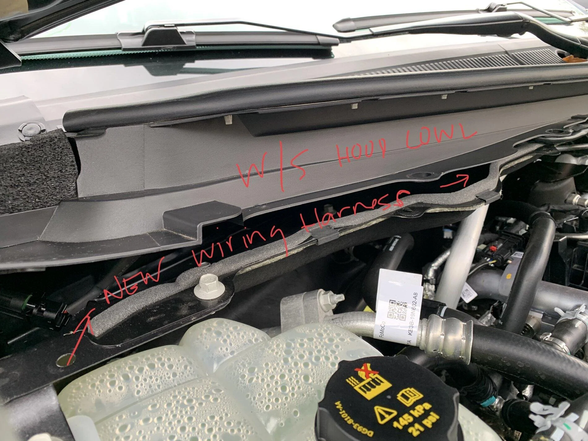

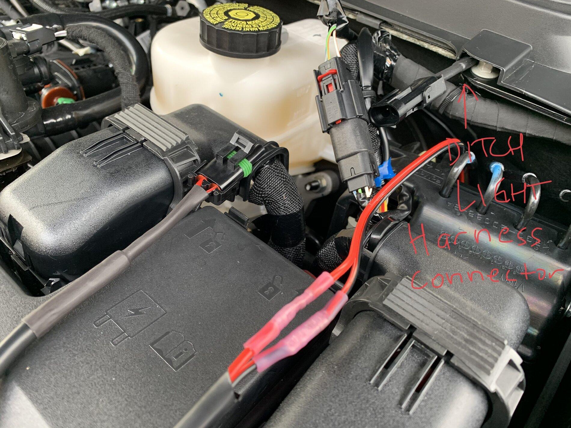

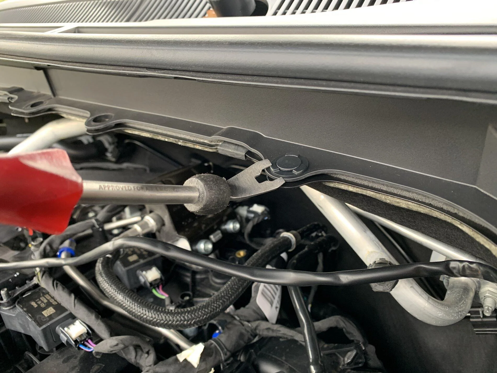

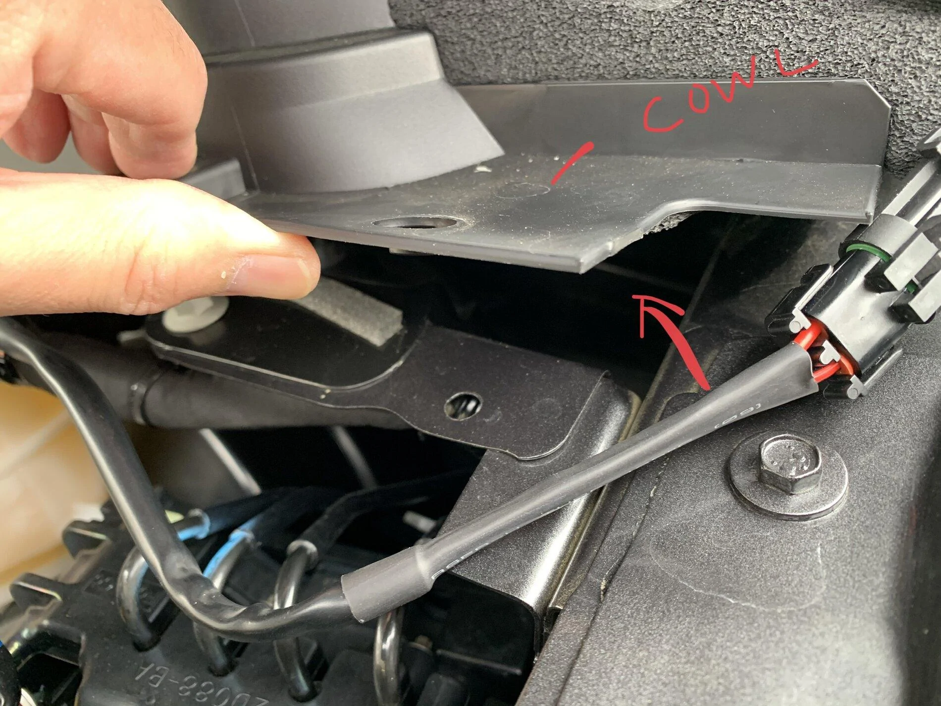

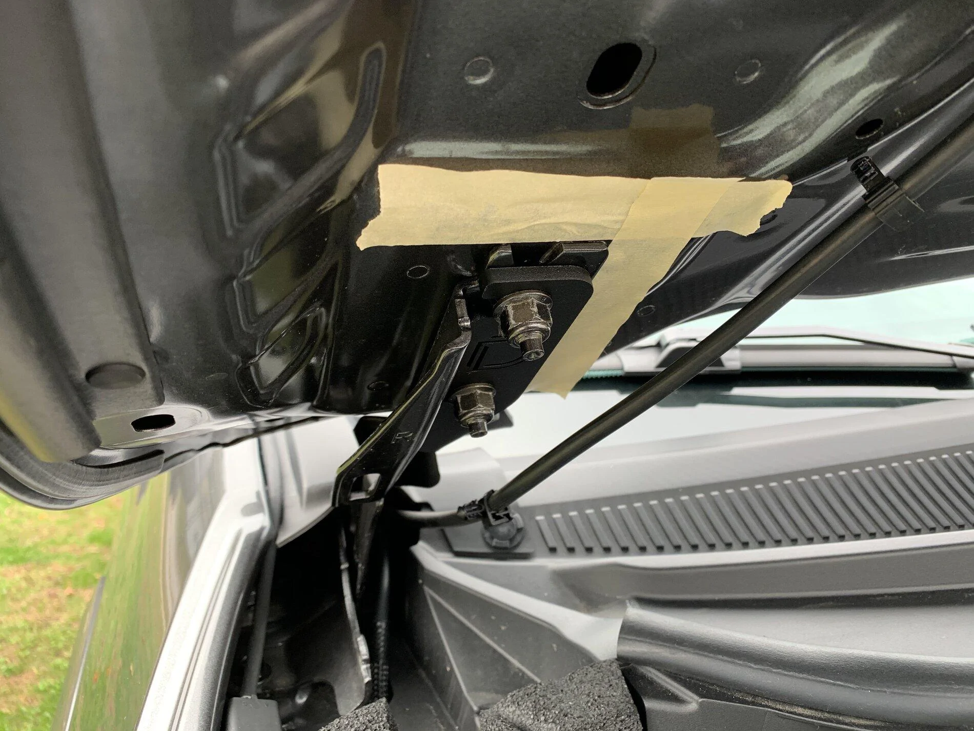

I didnt want to start a new thread...but here’s a few Tips on how to hide your wiring under the hood.
Using a trim tool, pop out the plastic trim clips holding the plastic windshield hood cowl. (hold on to them and dont let them fall, lol)
You can carefully pry and see that theres plenty of space to hide your wiring harness from left to right then near battery.
(see pics)
Re-install platic trim clips and then finish up your light hookup.
