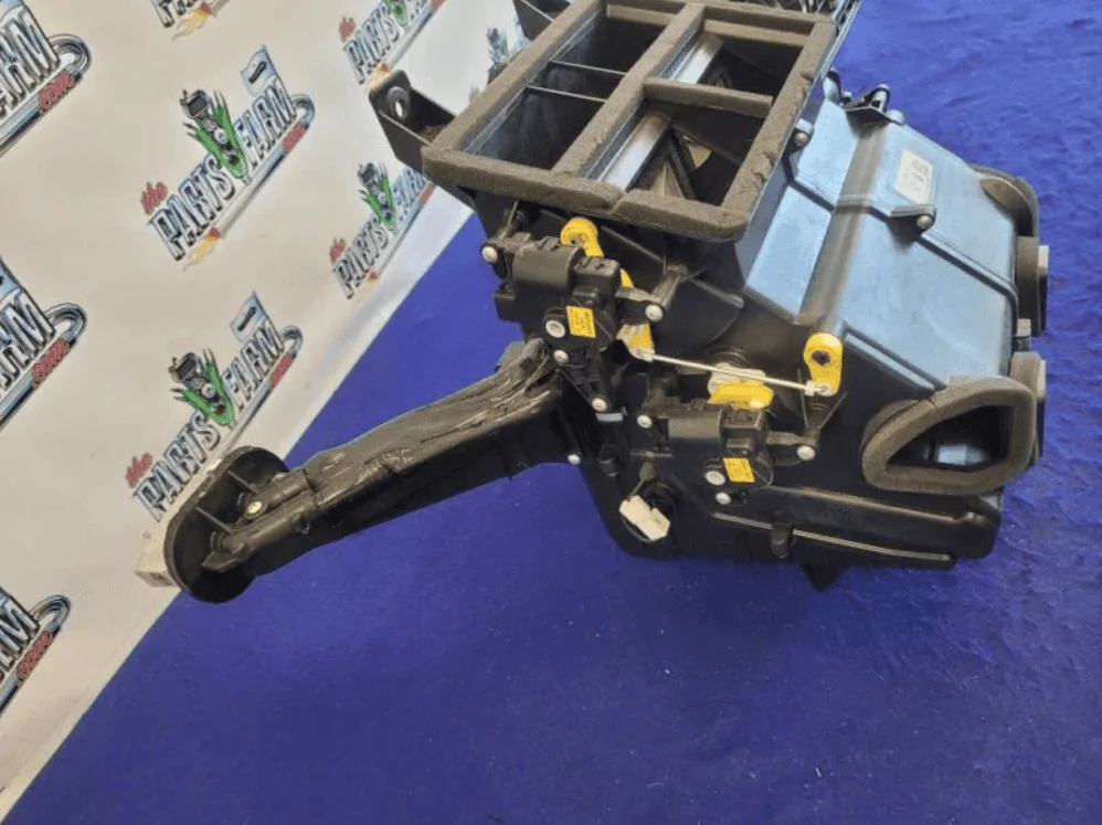

Looks like I'll be needing to replace my left A/C Damper Motor due repeated sensor failures indicated by B11E5:15-08 and intermittent weird temperatures from the vents.
I've got a dual zone system in my 2019 Ranger, so there are two motors on the left side of the HVAC Unit Case. Pretty sure one is the Left A/C Damper, and the other the Air Diverter control. Example attached.
Any idea which is which (upper/fwd vs lower/rear)? This section of the service manual doesn't appear to be on the forums so I'm flying blind.

That failure code is for the Drivers Temp Door - Actuator, the lower one.
The manual calls for steering wheel to be removed for access, however I think with some patience and small hands it can be done without doing that.
If you search for clicking in dash type noises, you will find many threads on this.
I believe another member, just manually moves this actuator (Summer-Winter) and disconnects the connector. IIRC - (Az Scorpion?)
The Upper, is the Blend Door Actuator = Moves air distribution to Vents, Floor Etc.

Thanks all!
@airline tech appreciate the ID on the correct position.
@Frenchy and @rang19ca I don't think its the deformed box in this case. The code is for sensor loosing signal (great video by fordtechmakuloco on why they do) and I'm not getting any mechanical noises from the unit. So hoping its just the controller not knowing what to do when it gets bad sensor data. Will check for freedom of movement when I pull the actuator.
@AzScorpion that video is exactly what I needed, giving it a go this weekend. Worst case I pull the actuator and just keep it set to full cold (Florida living). I'm not dropping $2500 into this thing over a stupid door.
