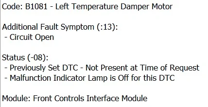

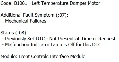

I happened to be in ForScan today adjusting a setting for my Ranger, and discovered a few stored codes in the FCIM: B1081:07-08 and B1081:13-08. This appears to be the dreaded blend door problem that these trucks frequently run into, and I understand that repairing/replacing that motor requires complete removal of the dash.
Ugh.
I'm a big do-it-yourselfer, but I'm *REALLY* not looking forward to doing this job myself. My truck is over 40,000 miles though, so out of the bumper-to-bumper warranty.... so I'm either leaving it alone, fixing it myself, or paying thousands in labor to my dealer.
I have not noticed any problems with temps not being what I want/need.... I've got a Lariat, and I just set the temp to what I want and the truck more or less does what it should to keep me comfortable.
TL; DR: Should I bother replacing this motor yet? Is there other stuff I should do while I have the dash out if I go ahead with replacement now?

Cracked open ForScan and looked for those PIDS. Unfortunately, the FCIM does not expose any PIDs at all to ForScan, so I'm not able to graph them. However, I was able to clear the codes and then run through testing the system - I always get what is commanded by either the physical buttons or the touchscreen... cold, hot, upper vent, foot well, defroster, dual zones set to extreme hot/cold with various combinations of vents etc... it *all* worked perfectly, and the codes did not come back.
Leads me to believe that the duct work itself(i.e., the plastics where these blend doors are mounted) likely warps in either extreme cold or extreme hot, which makes the tiny little blend door motors unable to swing the doors, and throws the code.
I assume if this happens enough times the motors simply give up / burn out / strip gears / mechanically fail permanently.
I don't recall when the last time was that I scanned the truck for codes, so these may have been stored a long time ago. Over the late summer and early fall I did wind up parking my truck out in the driveway overnight as my son was using the garage for major engine work on his VW R32... the truck wound up sitting out there through some pretty extreme temp swings some days we'd be in the 80's and then drop down to the 40's at night. It was out overnight for at least a few nights when the temp dipped down into the 30's or around freezing. I suspect that's probably when these codes were thrown.
For now, I'll keep my eye on the hvac system, but I'm hoping that Ford will have to issue a recall for these stupid systems before mine actually completely fails.
