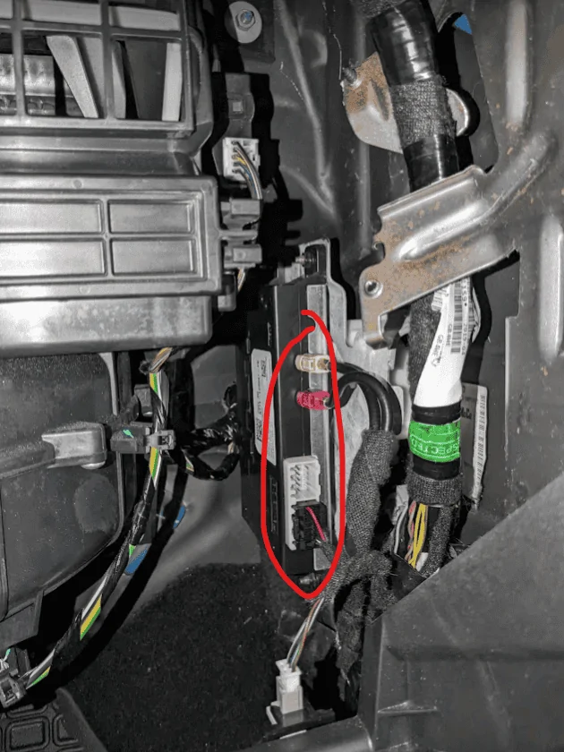

2) Disconnect the single electrical connector and two coax connectors from the telematics control unit. The coax's each have a little tab you push in on the colored section to release, then pull out.

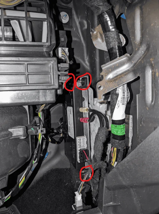

3) Remove the three nuts holding the TCU in place (8 mm socket). Remove the TCU and set asside.

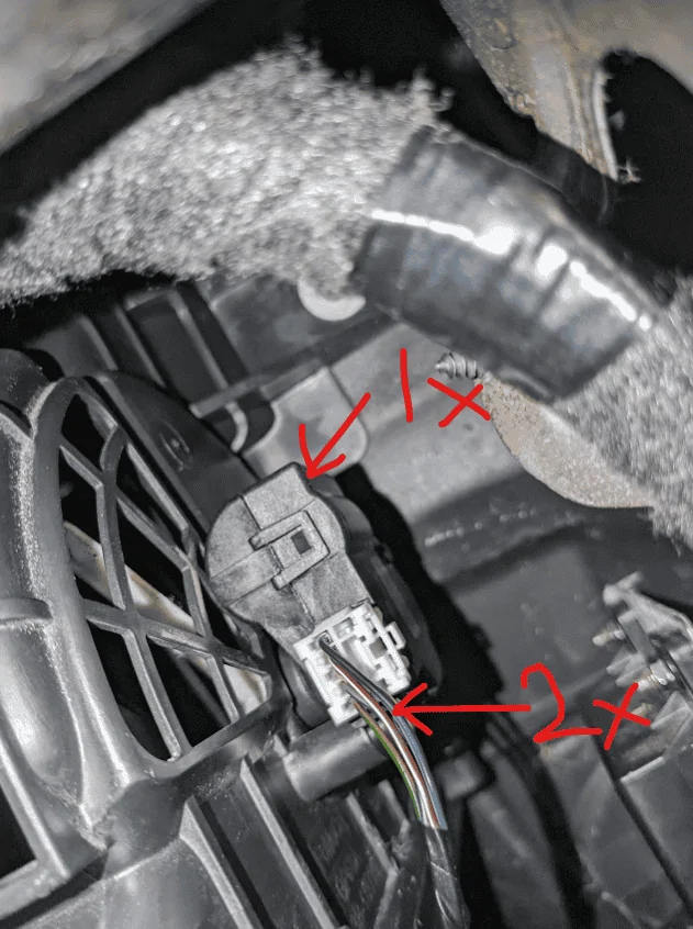

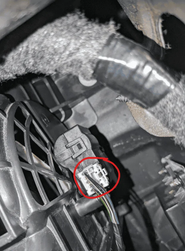

5) Disconnect the air intake damper connector.
6) Remove the three phillips screws holding the damper actuator in place. Pull the actuator out from the intake case.

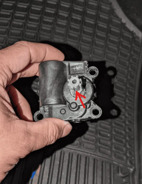

7) Insert the new actuator. Note that the shaft has one spline missing to align with a corresponding feature on the damper. You'll have to rotate the actuator to get them aligned, then push in, then rotate back to mounting position.
