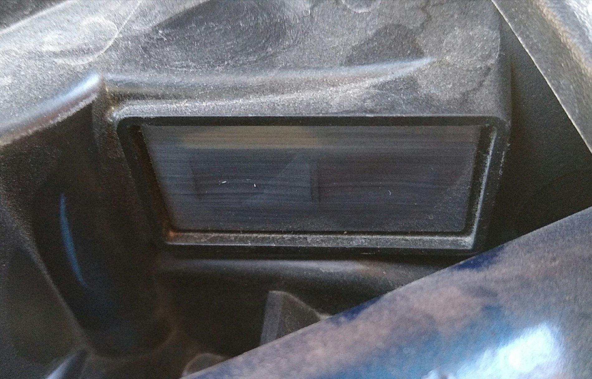

After reading thru this thread and gathering data/Intel, this appears to be facts about LED lights in the Ranger reflector housing.
- max advertised lumens should not exceed an advertised 12k lumens for low beams
- max heatsink size should not exceed 35mm diameter and 24mm depth/height
If you go over the 12k lumens, be prepared to reaim your headlights. If you exceed the heatsink size, expect your dust caps to not fit properly, if at all.
If you're concerned about heat and the fans inability to cool, consider that ambient air flowing over the headlight will lower the inside temp. If that doesn't put you at ease, you can look into adding a filtered breather vent to the housing, like this https://www.theretrofitsource.com/bolt-on-breather-vent.html. I do not know a suitable location to place it though. Upon inspection of the housing, it looks like it may already have a vent (see pic).

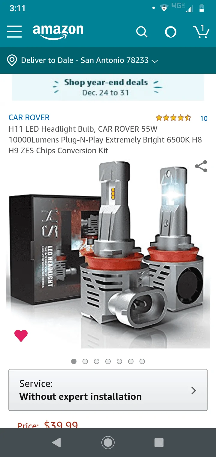

CarRover made me a deal to try out a new set of bulbs they just came out with. I'm super impressed. They are in the 1:1 format (no extra box). I was initially skeptical about how well they would work due to the lack of being able to rotate them, but I guess I was wrong. Holy crap are they good! Nice focused tight beam. They installed super easy and clear the dust caps with ease. They are also really quiet. I couldn't hear them with the dust caps off! I think you guys will be really impressed as well. The only downside (and it's not really one) is they I'm going to have to aim my lights again. I had to turn down the headlights due to the old LEDs, but these are going to have to go back up. Probably back to where the halogens were by the looks of things. Here's a link if you want to check them out:
https://www.amazon.ca/gp/product/B07XD8SLNV/ref=ppx_yo_dt_b_asin_title_o00_s00?ie=UTF8&psc=1
This may be a dumb question but which ones did you buy. I am looking and don't see the h11.
