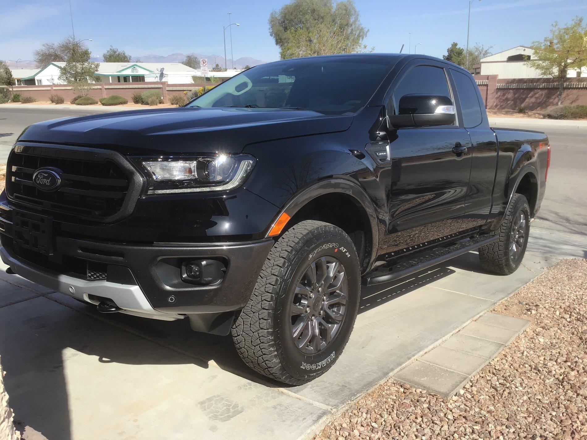

The Lariat today comes with 18” standard. My 2021 Lariat has the sport package and that changes to the 17” magnetic wheels.

The sport package it color matched bumpers with great fenders up front along with the Sport specific wheels. Oh and a sticker that says Sport on the side of the bed if it doesnt have the FX4 package

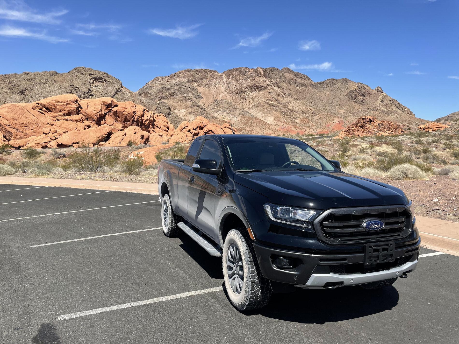

Wild. My (FX4 Lariat) bumpers and fenders look just like Megawatt's but with the 18" wheels. His bumper isn't color matched. So strange but cool nonetheless!
The inside dash in front of the passenger and grill are magnetic colored also in the sport package. Sorry OP for getting away from the wheels thread.

The dash in front of my pax seat is also Magnetic. Couldn't speak about the grill as mine came with Raptor grille preinstalled.
No worries about the thread detour. I'm intrigued now. I seem to have all the Sport goodies minus wheels. The plot thickens...
