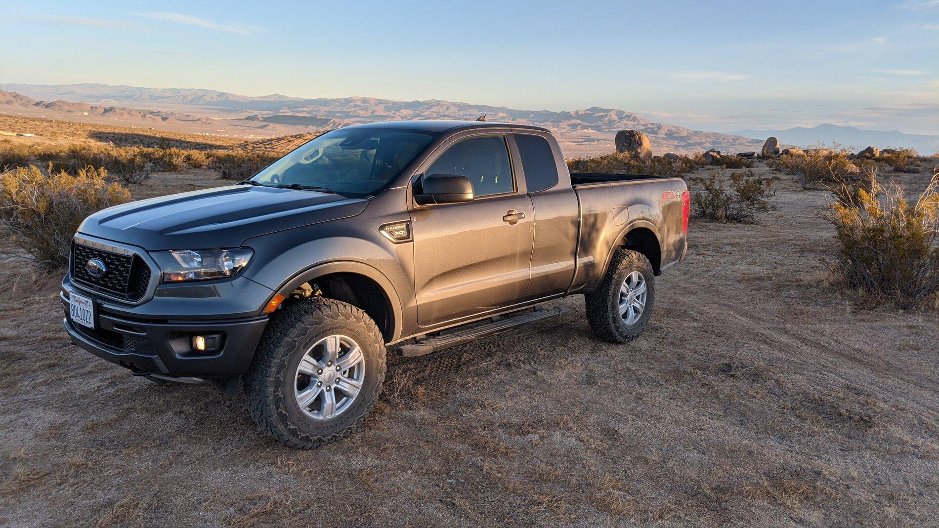

I have the following setup...
275/70/17 General Grabber A/T (32.2”) - pretty much a KO2 twin
RC 2-1/2” Level - no rubbing and crash bars are in tact but I am very close to the rear bars (1/4”), even after loosening the bolts and pushing the bars back as far as they will go. I will likely rub under hard braking or compression when I’m off-road. I am installing ReadyLIFT Anti-Intrusion Beams as a precaution. I also have to re-calibrate my speedometer becaose of the increase in circumference.
From my experience and what I’ve read on here, 275/70/17 is better suited to a slightly larger lift/level - 3”. It really is pushing things to the edge on a 2“ or 2-1/2” level.
265/70/17s (31.6”) will fill your wheel well just as nicely and give you a nice wide profile. They are less than 1/2” narrower and about 1/2” shorter but your bars should be fine. There are plenty of rigs on here with 265s and they look great - just check some of the Showcases.

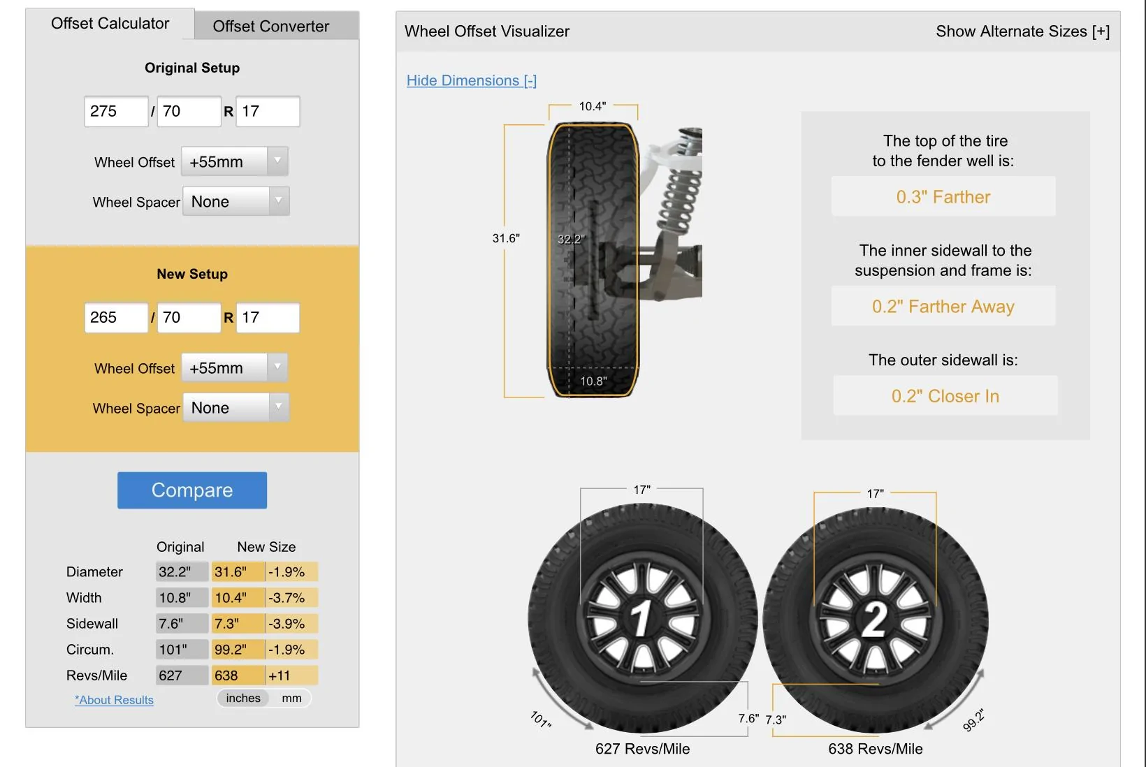

There is a handy offset tool here. You input your tire size and offset (+55 for stock Ranger) and your proposed setup size. It will tell you (and show you) how much further in or out your tires will be based on new tire size and wheel offset. It is also good for comparing the 265s to the 275s on your stock wheels - see image below.
