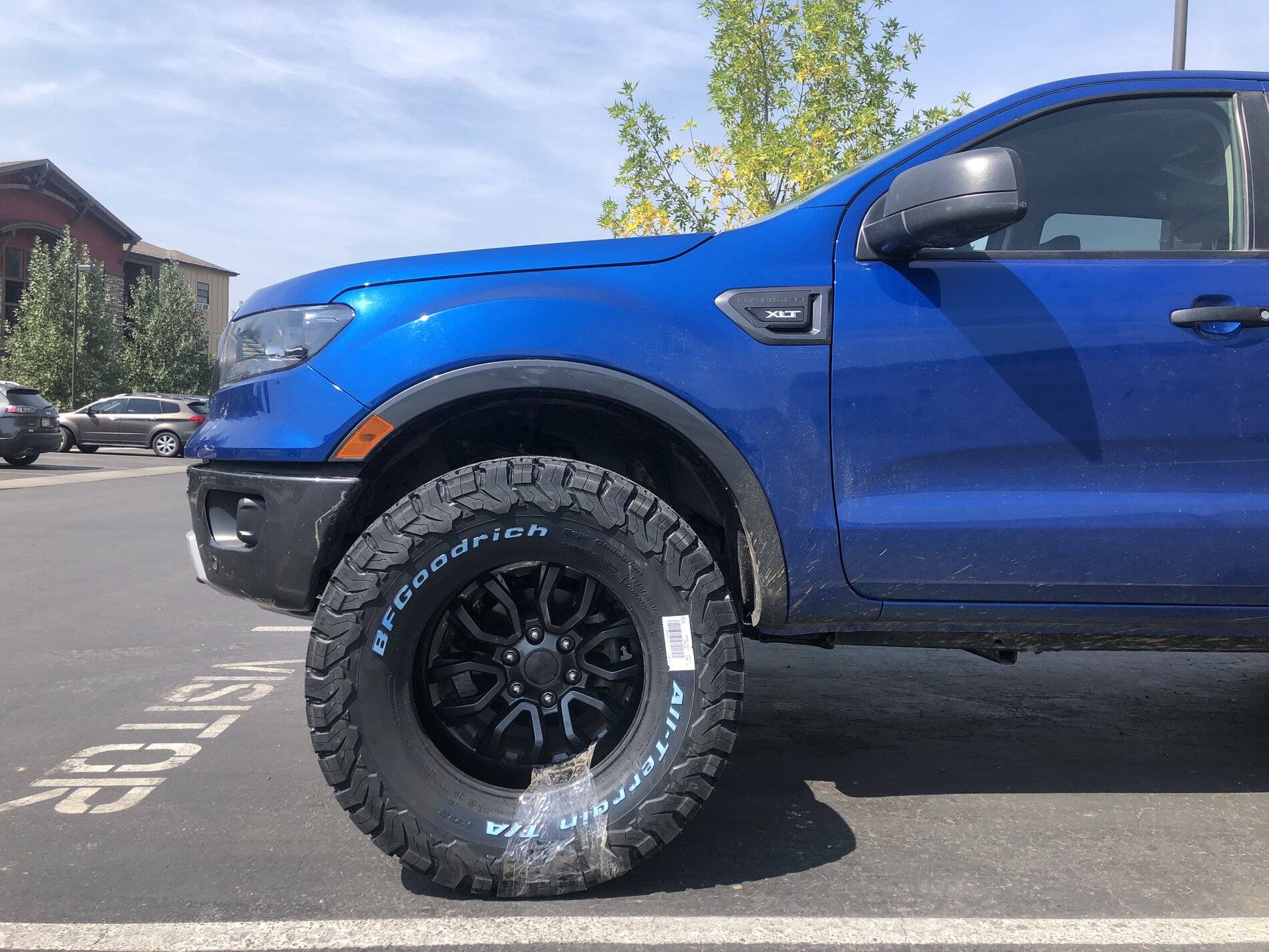

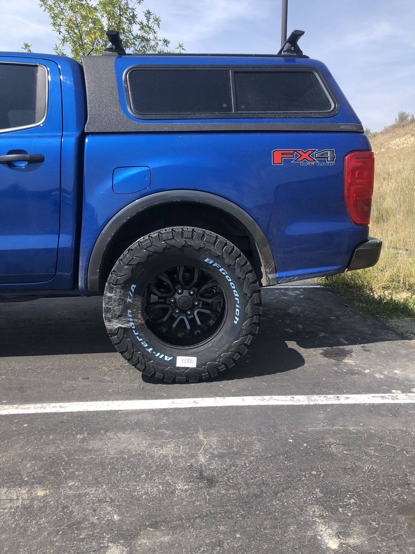

I’ll be putting on 275/70/17 KO2s in about a week and a half. Will let you know how they perform. I live in the mountains of Colorado and just about everyone raves about the KO2s in snow.

Looks good, 2" level ?
Fox 2.0 coil overs. I increased the preload a bit before install so it’s more like 2.5”-3” of lift up front. Rear unchanged but did add 2.0 shocks. It ended up more front lift than I was expecting so I guess rear shackles or new leafs are in my future. One upgrade begets another!!
Very nice . . .it sure is an endless cycle, but at the end you will have an awesome truck and a nice hole in your wallet . . .at least if your like me lol

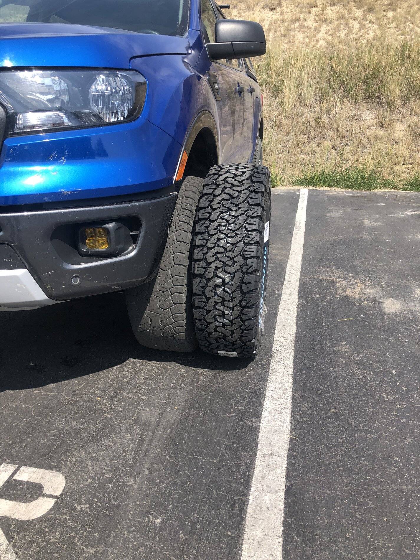

You put them on 17" stock wheels with a 2" level? This is what I want to do but was unsure of clearance.

I have 1” spacers to get more clearance from the spindle when aired down. It’s supposed to clear with stock offset but it’s very very close. Will see if the spacers complicates crash bar clearance. I’ve read on here that I should be fine. One week and I’ll know if I need to buy modified crash bars.
