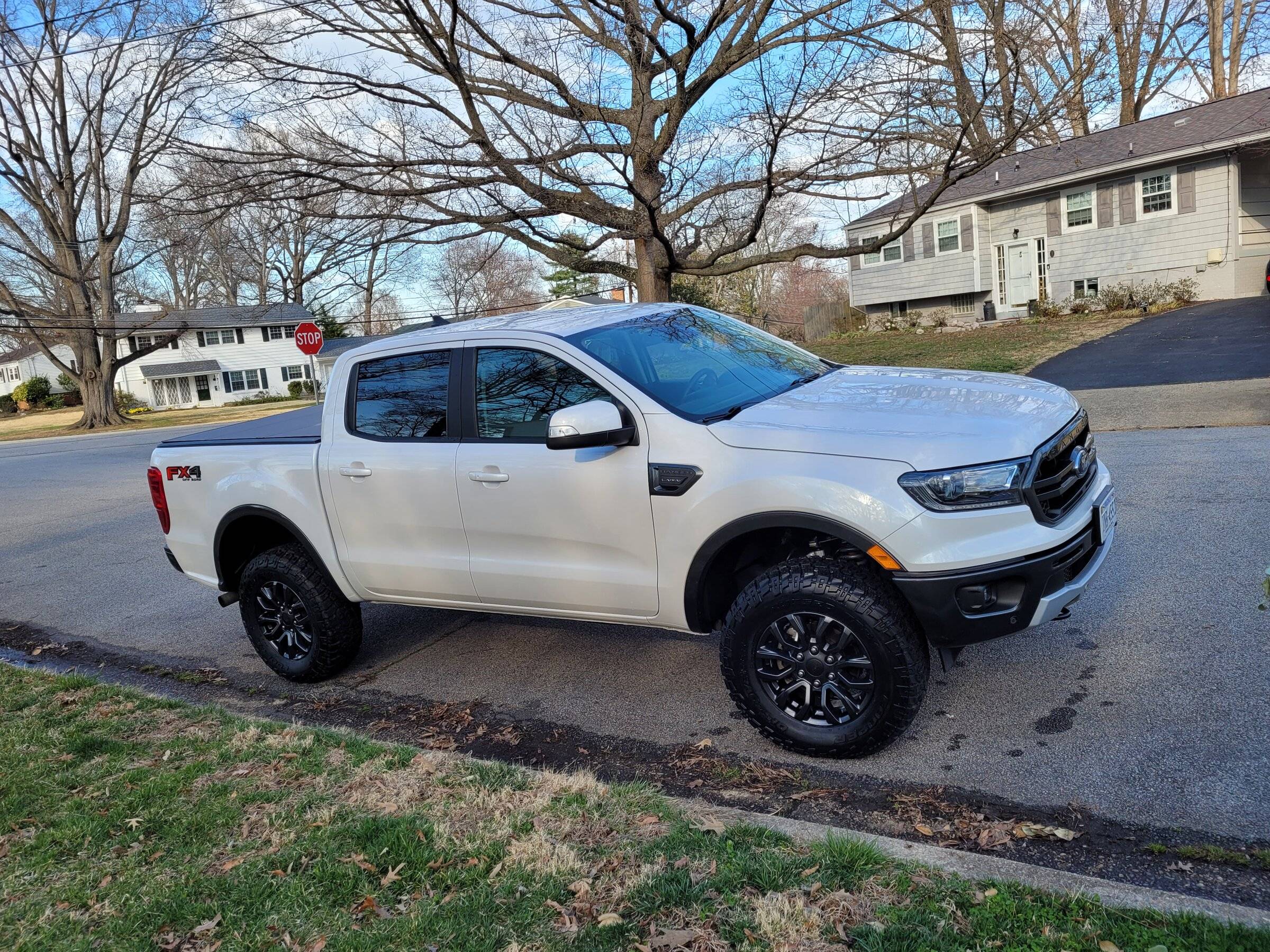

Not much of a build lol. Originally its a 2019 Lariat fx4 tech, tow, sport, tri metallic platinum/ bone colored leather supercrew and a 3 year lease. I only added weather tech floor mats, con agra trifold bed cover, Rhino spray liner bed spray and bed rug for the first 2 years.
Realized I loved the truck and bought it so I upgraded the suspenion with Eiback 2.0 coilover and extended shocks with 1" blocks in rear. 2 1/2" front and 1" rear lift. Icon UCAs, Cooper Wild Trek 265/70/17. Just recently upgraded the fogs with Diode Dynamic amber pros which Im totally in love with.
Hopefully soon my Rocky Road Outfitter sliders with kickouts will be here soon that I ordered in January and once welded to the frame and rust under coating I will be done....maybe?
I will have no doubt it can play follow the leader with any stock Tremor offroad.?
That said I would have bought a Tremor package had it been available and in Platinum in 2019.
Sorry for lenghty post but it is relevant to the OP
