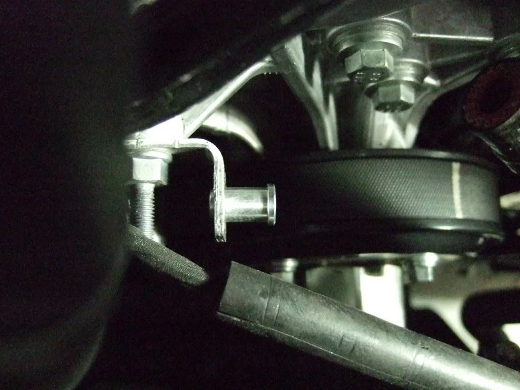

OK, I took my new hose off the stud and snapped a picture. I think that sharp ridge combined with a cheap hose is our issue. I think the silicone hose that I used will last, and most likely reinforced fuel line. But not a vacuum hose like the one that come from the factory.
Again, I could very well be wrong here.
- T
That fits with my experience as the hose on mine fell apart right on that ridge when I just touched it. The other side seemed fine to me. And, the rest of the hose, while still cheap, seemed fine when I just clamped the shortened hose back on for the trip to and from work the following day. I do think a more rounded flare and a reenforced hose would go a long way to preventing the failure.
I also wonder, as postulated here by others, if the failure is the hose breaks, it's not noticed and the sensor just freely moves around until the fan or clutch is able to catch the wire and rip it apart.
- T
Wondering also if you could just chamfer/ round the edges of the “T” and replace hose with HD/silcone ?
I agree, the sharp edges are bad, not like it sees a lot of pulling stress. Also going to silicone probably will help life, as that little bracket gets quite hot, being bolted to the engine block.
