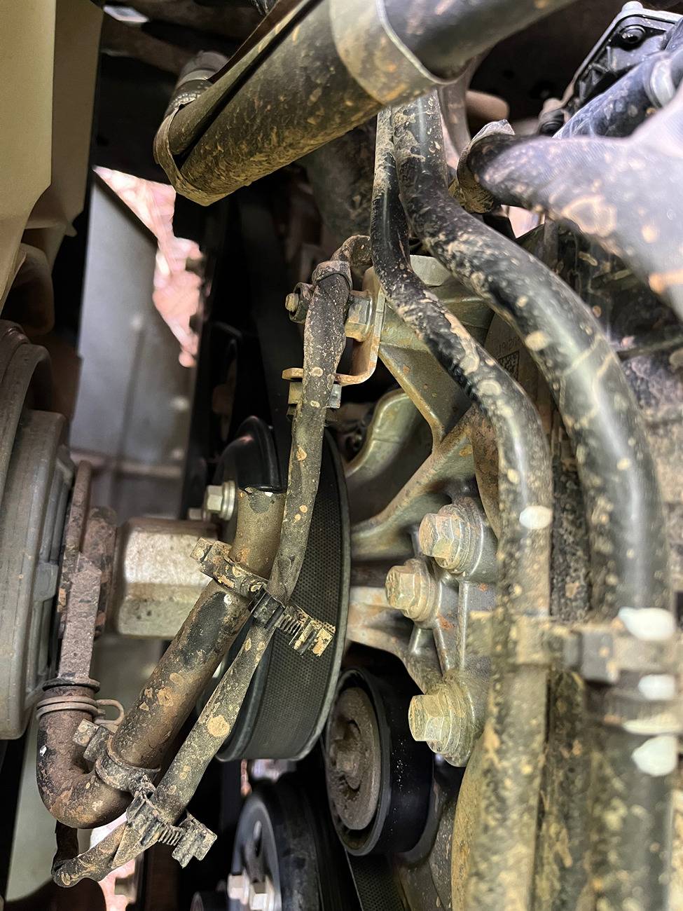

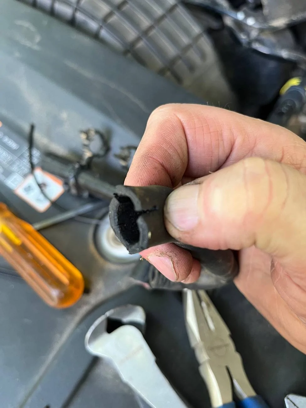

Well, Lookie what I found today.
31k miles.
Completely broken on one end.
The end had deteriorated into a black goo.
Many thanks to @TJC . I fortunately had the silicone replacement hose handy.
Disaster averted it appears.
And I'd just driven it 200 miles to the airport and back.
Very glad it didn't leave me stranded.

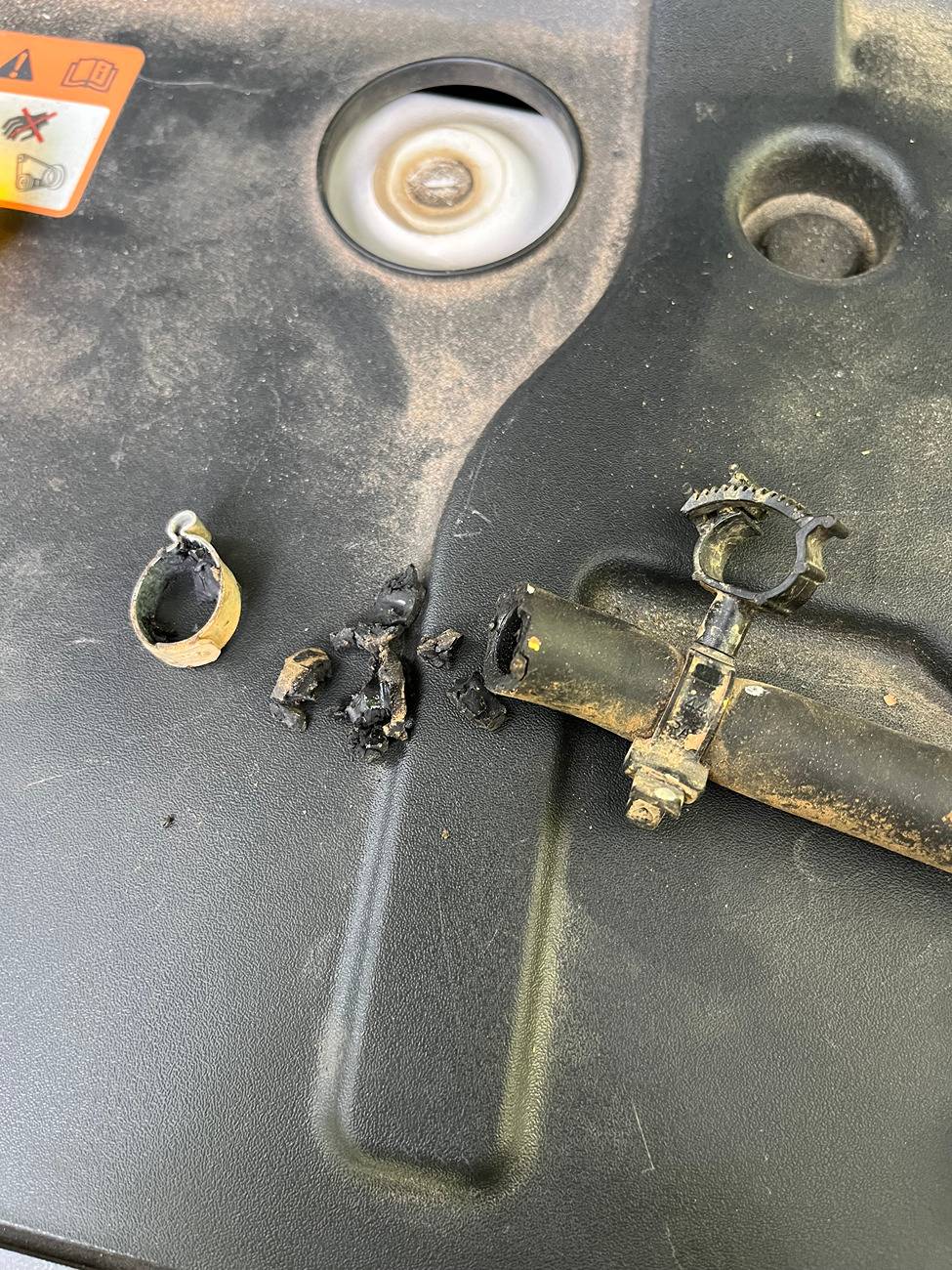

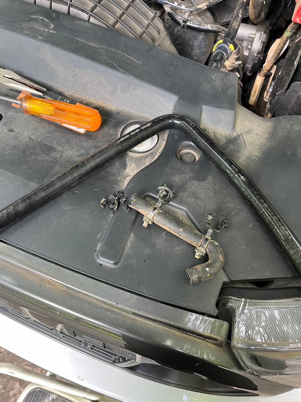

Double post for visibility. This is a key issue for anyone who has a 5G Ranger. I was under the hood today and found the hose broken:
I went with some fuel injection hose, reused the factory standoff for the wiring and replaced the hose/clamps:
EVERY 5G OWNER NEEDS TO PREPARE FOR THIS INEVITABILITY.
