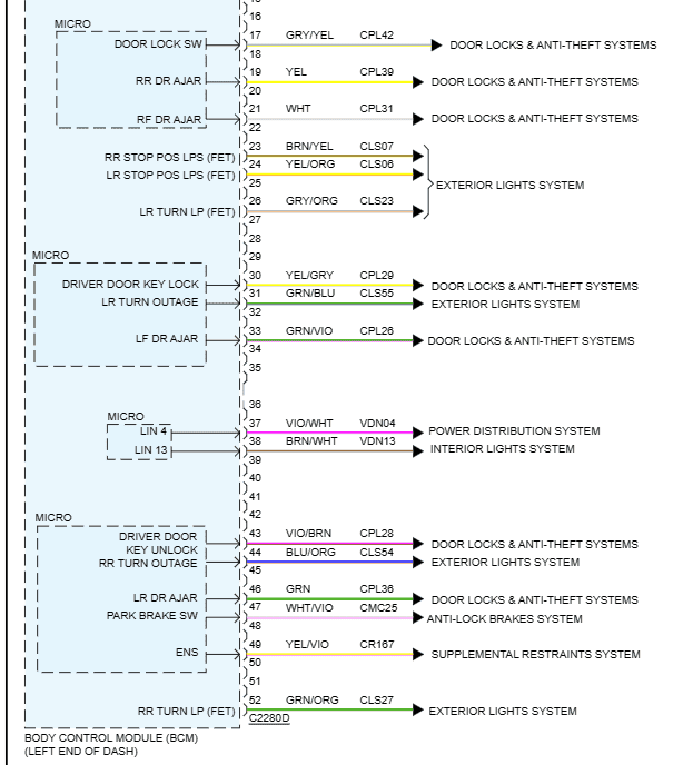

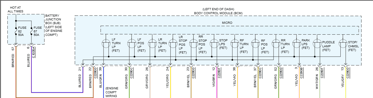

It would be nice if we could find the inner workings of the BCM to find the spec on the micro controller inside the BCM. (On the PCB)
The Micro Controller with associated resistor is a current sensing controller and has a min/max wattage (current flow) to trip the Turn-Outage (Hyper-Flash)
By swapping to LED lights, this creates a trip on the (Min) side of the controller, sensing a Turn-Outage - thus the need for adding a resistor to simulate factory incandescent bulb resistance.
By adding extra lights to the circuit, you are affecting the (Max) side of the Turn-Outage.
I don't know what the Min/Max Specs are but if we had a breakdown of BCM internals and get the resistor number we could better calculate add on lights.
So, for this specific issue and light bar, the question would be which is tripping the hyper-flash Min or Max?
and would adding a resistor (Min) fix the issue.

Yes, by using a FET - (Field Effect Transistor)
I do not know the specific specs it monitors but it is a separate micro controller in the exterior lighting circuit (Inside the BCM) that monitors excessive amp draw (shorts) and shuts down the circuit. It will reset with a key cycle and return if not corrected.
This will generate a message on the dash and also a fault code.
If enough FET trips occur the BCM is bricked and requires replacement as it cannot be reset anymore
So, basically the FET protects the internal circuit of the BCM for each individual lighting circuit.
For, clarification the Hyper-Blink indication is only on the Turn Signal circuit and the (Max) load within that circuit would not be sensed as a short but as an example would be a dirty light socket or connection thus changing the resistance in the circuit, and by adding lighting (lightbar) is adding a draw (amperage) on the circuit and adding more resistance (Through the Light-Itself)
This is using the bare minimum description from the manual.
Now being that the manual does not specify that the Turn Outage will also monitor extra load. I used other sources for how the Turn-Outage Micro Operates, as this would explain why adding lights creates the Hyper-Blink but does not trip the FET and shut the circuit down.
Ref: This online find as an example, note it is not for the Ranger, but it is used as a Reference.
Tear down BCM (fixing hyper flashing with LEDs) | Gadgets for my MX-5 Miata (ND)
(mx5things.blog)
From the Manuals: (Below)
Field Effect Transistor (FET) Protection
The BCM utilizes an Field Effect Transistor (FET) protective circuit strategy for many of its outputs, for example, lamp output circuits. Output loads (current level) are monitored for excessive current (typically short circuits) and are shut down (turns off the voltage or ground provided by the module) when a fault is detected.
A Field Effect Transistor (FET) is a type of transistor that the control module software uses to control and monitor current flow on module outputs. The Field Effect Transistor (FET) protection strategy prevents module damage in the event of excessive current flow.
Output loads (current level) are monitored for excessive current draw (typically short circuits). When a fault event is detected the Field Effect Transistor (FET) turns off and a short circuit DTC sets. The module resets the Field Effect Transistor (FET) protection and allows the circuit to function when the fault is corrected or the ignition state is cycled off and then back on.
When the excessive circuit load occurs often enough, the module shuts down the output until a repair procedure is carried out. Each Field Effect Transistor (FET) protected circuit has three predefined levels of short circuit tolerance based on a module lifetime level of fault events based upon the durability of the Field Effect Transistor (FET). If the total tolerance level is determined to be 600 fault events, the three predefined levels would be 200, 400 and 600 fault events.
When each level is reached, the DTC associated with the short circuit sets along with DTC U1000:00. These Diagnostic Trouble Codes (DTCs) can be cleared using the module on-demand self-test, then the Clear DTC operation on the scan tool (if the on-demand test shows the fault corrected). The module never resets the fault event counter to zero and continues to advance the fault event counter as short circuit fault events occur.
If the number of short circuit fault events reach the third level, then Diagnostic Trouble Codes (DTCs) U1000:00 and U3000:49 set along with the associated short circuit DTC . DTC U3000:49 cannot be cleared and the module must be replaced after the repair.
