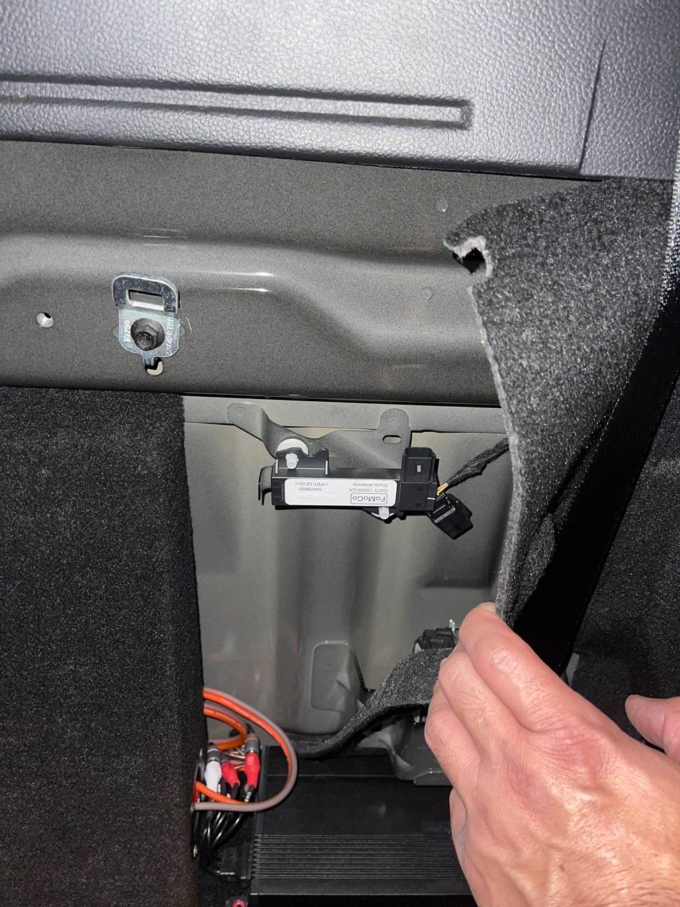

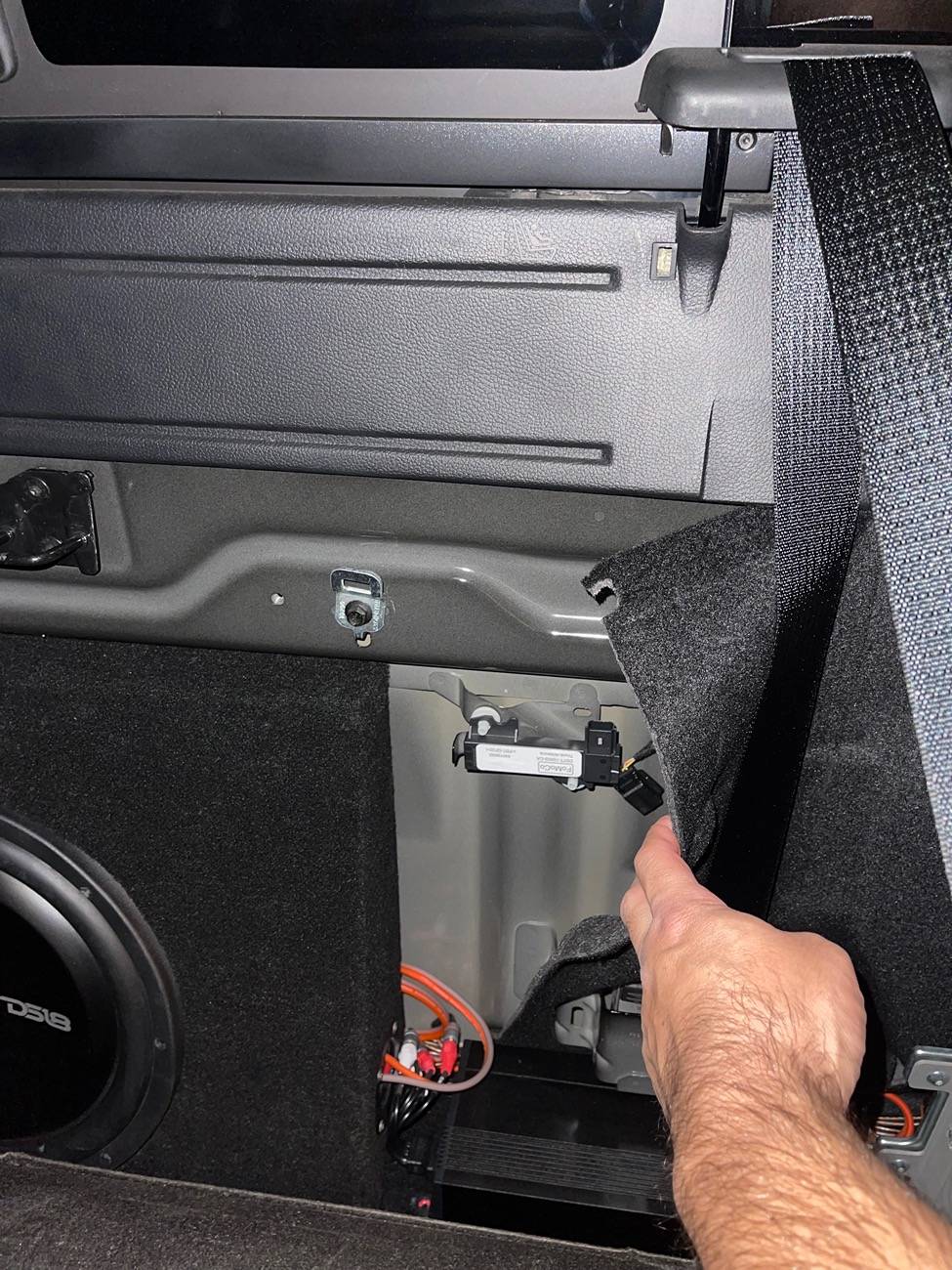

if you fold the rear seat forward and lift the carpet off the rear wall right in the center you’ll find a sensor disconnecting turns off the fake engine noise. I did this problem solved. Trucks runs great no problems

That part has Nothing to do with the Fake Engine Noise - that sound enhancement is strictly software. The part you have disconnected is the Rear Antenna for the Pats system (remote entry)

My question is, what website directed you to disconnect the Rear PATS Antenna, it has NOTHING to do with the Fake Engine Sound - PERIOD.
The Remote will work as it comminates to the TCU, the rear antenna picks up perimeter approach from the rear with the FOB on you, it also ties into when you go to start the truck the antenna along with the other 3 antennas - validate the FOB frequency and allow the truck to start.
So specifically, it is dual function Passive Entry (rear approach) and Anti-Theft for the transmitter validation to allow a start.
The truck has 4 - Each Door Handle, Center and Rear - PATs Antennas.
The Center Antenna being the Primary (as this is the backup start location -placement)
PATS
The PATS function is controlled by the BCM, the PCM and the ABS module.
When the START/STOP button is pressed, a signal is sent to the BCM. When the BCM detects the START/STOP button is pressed, it begins the key initialization sequence by activating the PATS center antenna, the PATS rear antenna and both exterior doors handle keyless entry antennas. Each antenna transmits a low frequency signal with an approximate range of 1 m (3 ft). The passive key activates if it is within range of the antennas. The BCM is able to determine the passive key location (inside or outside the vehicle) based on the input from the antennas.
So, to test the operation, place the FOB in the back seat, and you may get a - No Key Detected Message when you attempt to start the truck.

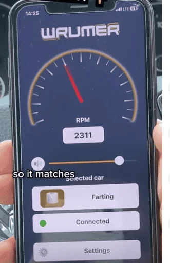

I say ADD MORE SOUND! Only $39.90!
With this: https://us.wrumersound.com/
Including farting, perfect for dump runners!

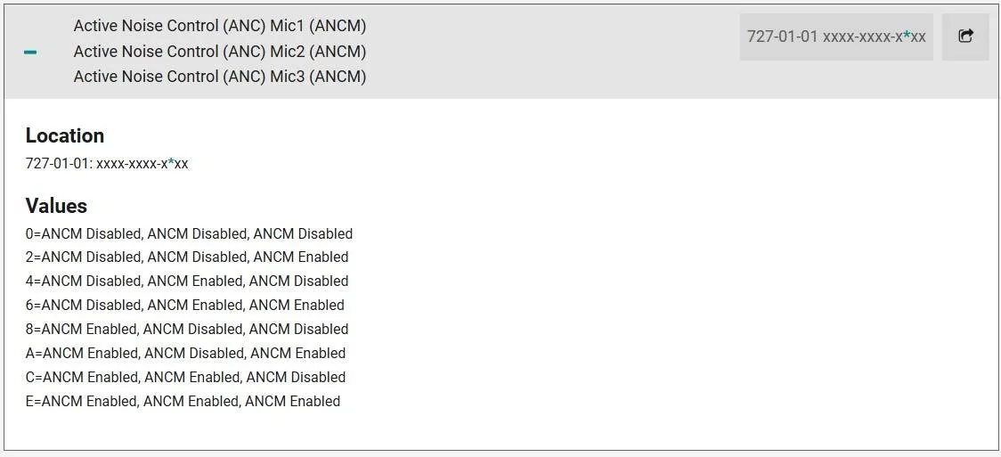

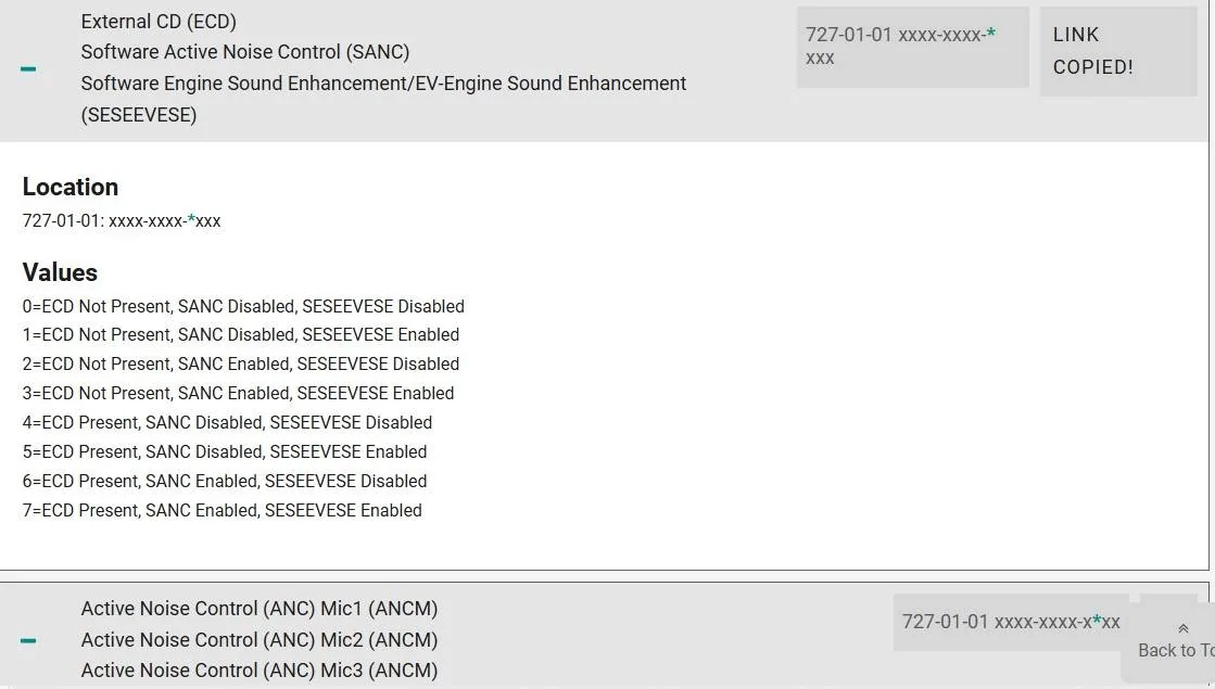

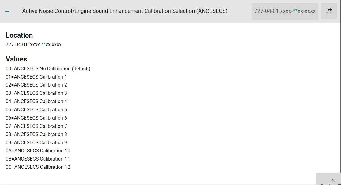

Here is the ACM - Hex Code Breakdown (As-Built Data)

Rudy
Jul 21, 2024
Lakewood,Ca
21 ranger lariat tremor
Ok guys so all key fob features still work on the truck including remote start same on my ford app through my phone. Truck still Auto Unlock’s when I walk up. I did test opening doors from inside without my key fob inside the truck while locked and the anti theft didn’t go off. Something I can ask a stereo/alarm shop about. I do know that I noticed the fake engine sound when my truck was completely stock it was subtle so I didn’t mind at all but after having my speakers replaced sub and amp added it was very loud on full throttle and sounded horrible. It is gone now but I’ll figure this other thing out now.
