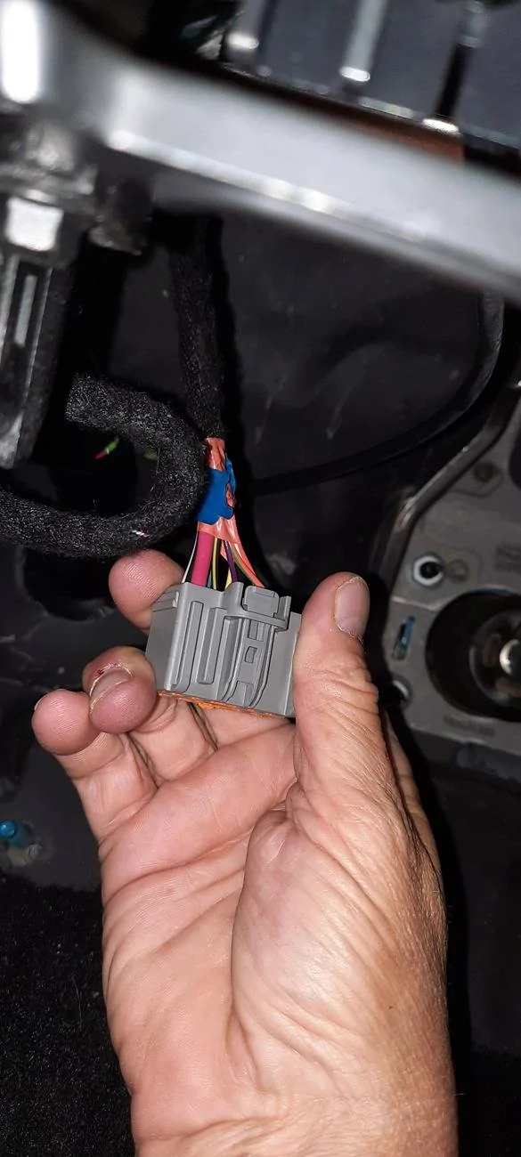

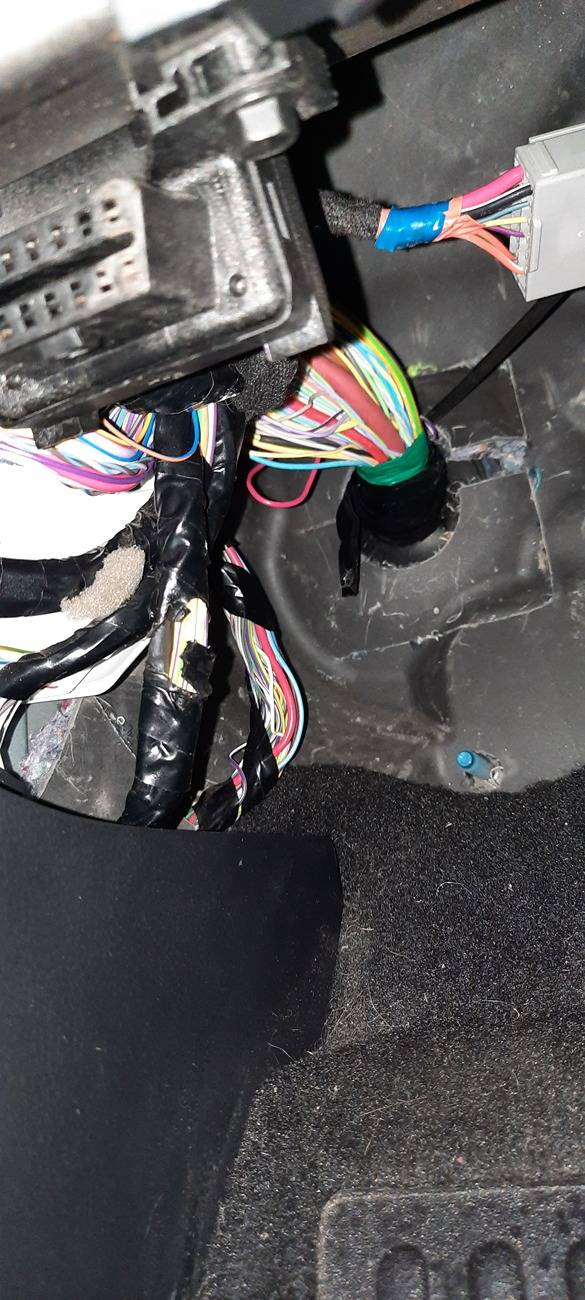

Im looking for TBC wires and only found a gray harness with blue tape. Any clue what this is?

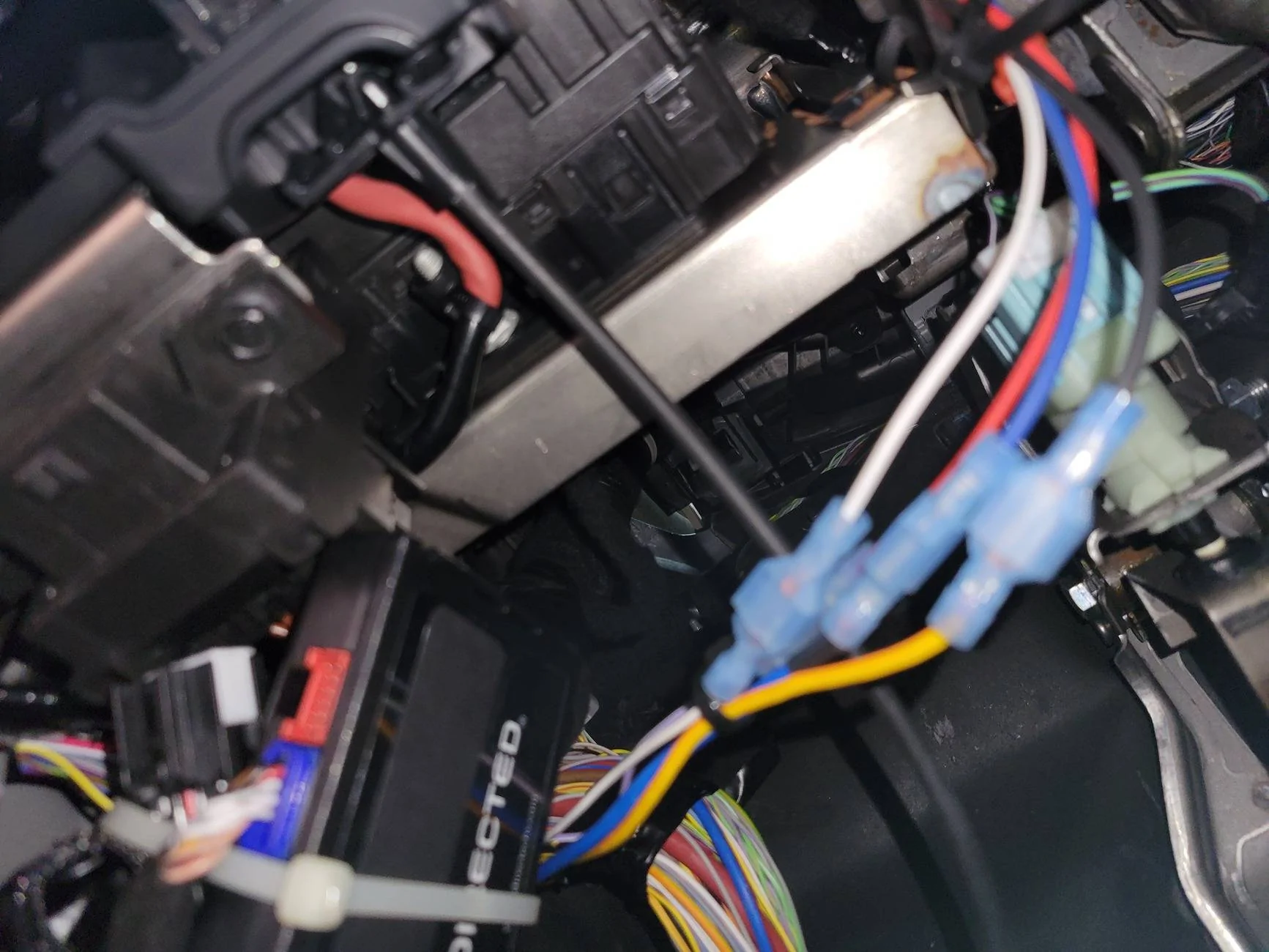

It appears you are pre-wired for the Perimeter Plus Alarm System, taps into the backside of the DLC (OBD Port)

I just looked through my 2021 Ranger electrical manual and I think that connector may be C2239 for Direct Current/Alternating Current (DC/AC) Inverter.
Bingo - Nailed IT
Pin
Circuit
Gauge
Circuit Function
Qualifier
Terminal Part Number
1​
HYA01 (OG-GN)​
18​
CTRL MOD. - DC/AC INVERTER # ALTERNATING CURRENT OUTPUT A (AC A)​
97BG-14474-BBA​
2​
Not Used​
N/A​
3​
Not Used​
N/A​
4​
Not Used​
N/A​
5​
CBP23 (BN-YE)​
20​
FUSE - 23 OR CIRCUIT BREAKER​
97BG-14474-BAA​
6​
SBB81 (RD)​
10​
FUSE - 81 OR CIRCUIT BREAKER​
XF2T-14474-DA​
7​
HYA02 (OG-WH)​
18​
CTRL MOD. - DC/AC INVERTER # ALTERNATING CURRENT OUTPUT B (AC B)​
97BG-14474-BBA​
8​
Not Used​
N/A​
9​
VDN04 (VT-WH)​
22​
CTRL MOD. - LIN BUS # 4​
97BG-14474-BAA​
10​
LYA03 (YE-VT)​
22​
CTRL MOD. - DC/AC INVERTER # LED INDICATOR +​
97BG-14474-BAA​
11​
RYA03 (BU-BN)​
22​
CTRL MOD. - DC/AC INVERTER # LED INDICATOR -​
97BG-14474-BAA​
12​
GD285 (BK-WH)​
12​
GROUND - INSTRUMENT PANEL STRUCTURE # 5TH POINT​
97BG-14474-BCA​

Reading more, you could drop F81 in the Battery Junction Box (BJB) from 40A down to 30A, then use that red wire in place of the yellow-orange. Run your own blue wire to the 7-way's TBC pin.
On the braking input, you could do like the Ford EBC and use the brake light output as the trigger, or maybe see if you have a violet/white wire you can tap from BCM-C2280H at pin 13 for brake pedal activated (not advised with adaptive cruise or emergency braking systems). Looks like either of those will be +12V when activated, so if your controller wants a grounded brake pedal input, you may need to use a relay to reverse that.

The harness you have pic posted is for the DCAC Invertor Module, it is used for the AC Plug in the back seat (console) if equipped.
From the pic, the wire pinout is exact including the wire gauge size.
Ref: Your connector and the Pin Out of that connector and then look at the connection point of the unit - All the alignment tabs - Line-Up
It would mount here:
100%, that plug is for the DC/AC Inverter.

If referencing the (Dead End) Connector that is part of the factory wiring harness.
The only connector in that general area with a noted (large gage wire) is C2239 and that feeds the DCAC Inverter (If optioned) with the Rear Console (AC-Power Port) the inverter will be installed.
So it appears you do not have the (Option) but Ford left the connector on the harness or its just simply disconnected from the Inverter (If its installed)
