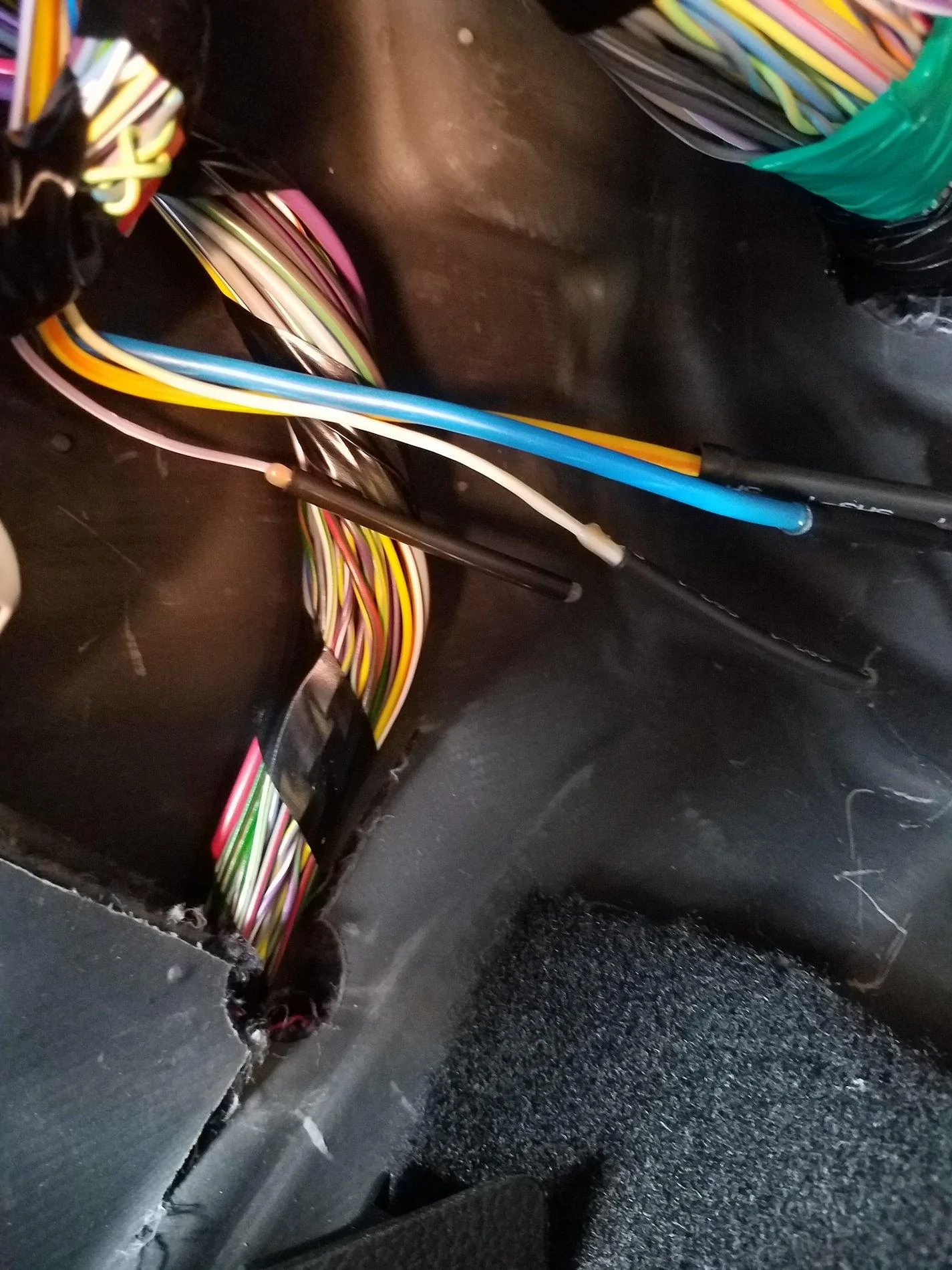

Has anyone created a how-to for XL model owners who want to install a TBC (either aftermarket or Ford authorized Redarc)? I'd just like to know where best to tap into for each component what would normally be accessed on XLT+ models with the 4 wires under the dash.
I tried searching around for a bit and didnt see anything very illustrative and comprehensive. Any direction/guidance would be appreciated.

The wires are there.

I can tell you my 2019 XL did not have the 4 wires under dash that other Ranger's have. Dealer did not believe me so I brought it in. Shop foreman couldn't find them. Wound up paying four hours of shop labor for them to find tap/splice points and run them to dash. Really pissed, and wrote two letters to Ford demanding they reimburse me for the missing components they failed to provide. No resolution as yet, so I might have to sue/arbitrate.

There's literally a plug by the frame by the drivers seat that you plug in the trailer package to. Don't have them splice crap into your wiring harness, just order the parts and put them in yourself, or pay the hour or two of labor to have them installed correctly.
If your truck had the trailer package on the window sticker, then they will have to install it for free if it's absent.
This thread shows the part and part number.
https://www.ranger5g.com/forum/threads/trailer-wiring-and-connector.2903/page-3#post-122995

Thank you, however I was referring to getting the trailer brake controller tied into the vehicle. XL model owners seem to be screwed with regard to getting the TBC integrated easily, even if their trucks have the trailer tow package.

Doesn’t the harness I posted the link to contain the four controller wires that get routed up under the dash?

YES It is a 2019 XL. The wires are NOT under the dash, but on the left side. They are SHORT, so hard to get to.
Oh interesting, so they are in a different place than on other models? Apologies as I am not a current owner, rather a prospective one and just making sure what is or is not there, as I've read a few posts that make it seem like a daunting task if those wires are not present.

They were NOT in my XL.

It is my understanding that the 4 wires are available on ALL models. Both with and without the tow option.

Thank you, I'll have to take a closer look behind the left kick panel area. Seeing some owners on this forum rip apart their trucks to find those wires had me anxious. Could be a tow vs non-tow package thing too if t4thfavor is correct about the harness. I'll look near the driver's seat and LH frame area too next time I'm around one.

For clarity, that harness is under the truck, not in it.
