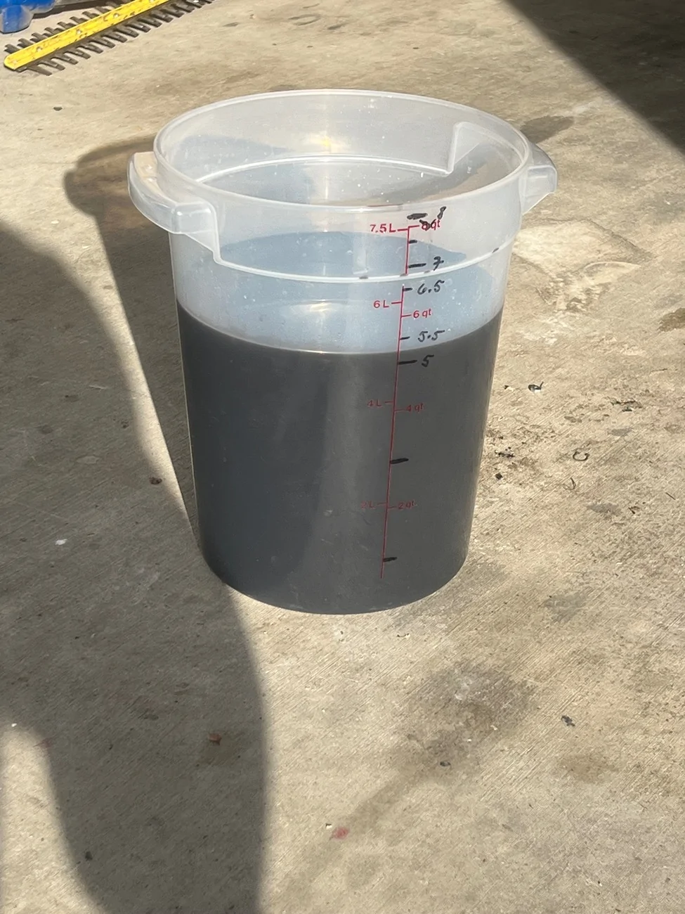

OK…so I bought a Mishimoto pan and filter last year…and kept putting it off. I finally decided to change it today. I bought a Harbor freight pump…the time was too big…so what.
I used a Costco black tote as my drain pan. Plenty big enough. I just started pulling the bolts…as it started draining I made sure the tote was in position. I then poured it into a big measuring cup to ensure how much came out.
I changed the filter, fluid and pan. No big deal.
if you are on the fence about doing this…DO IT!!! My truck has 53k miles and I could not believe how dirty the fluid and the filter was.
I also replaced the transfer case and the diff fluid.
Not hard. Just take your time and follow the torque settings.
This is a pic of the fluid that came out.
