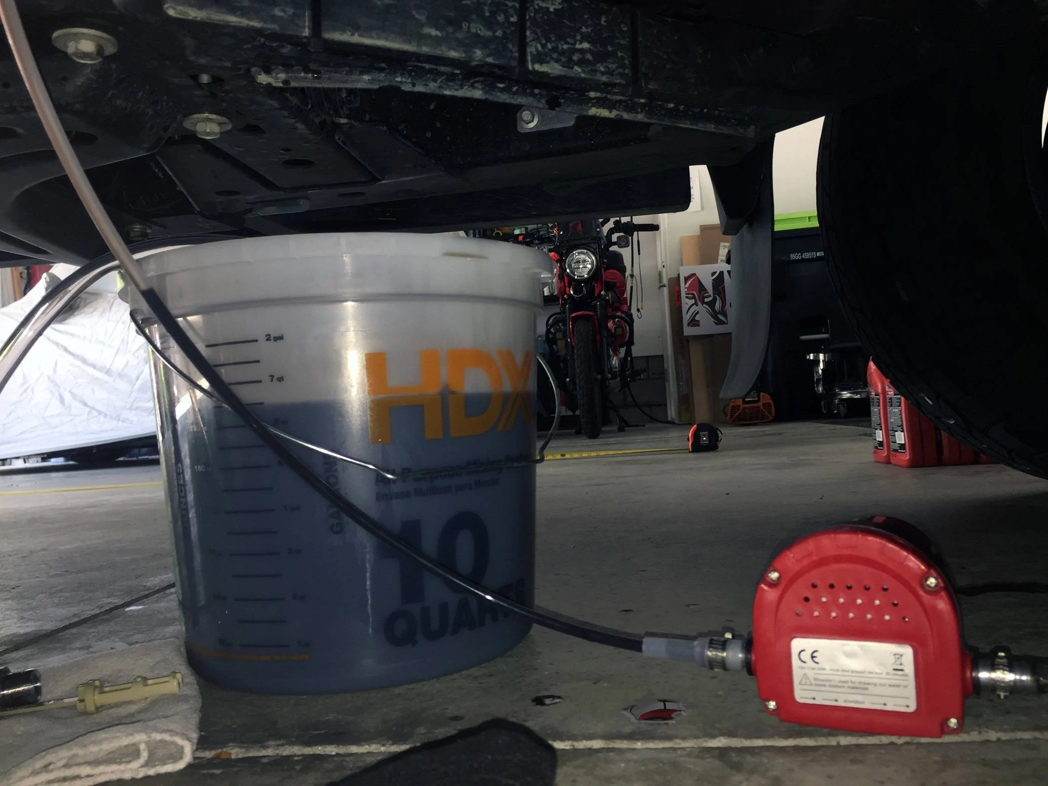

Buy the $25 pump. Pump fluid out via the stock dipstick location. Then pull the pan leaving one end loose but still connected. Whatever is left in the pan will pour out through the lower end of the pan and can be easily captured.
Any other way and you are going to get very dirty with ATF.
Once you add a pan with a drain plug things will get simpler. But I think I still prefer to suck what I can out through the MBS dip stick. I can get an accurate measurement of what came out.
