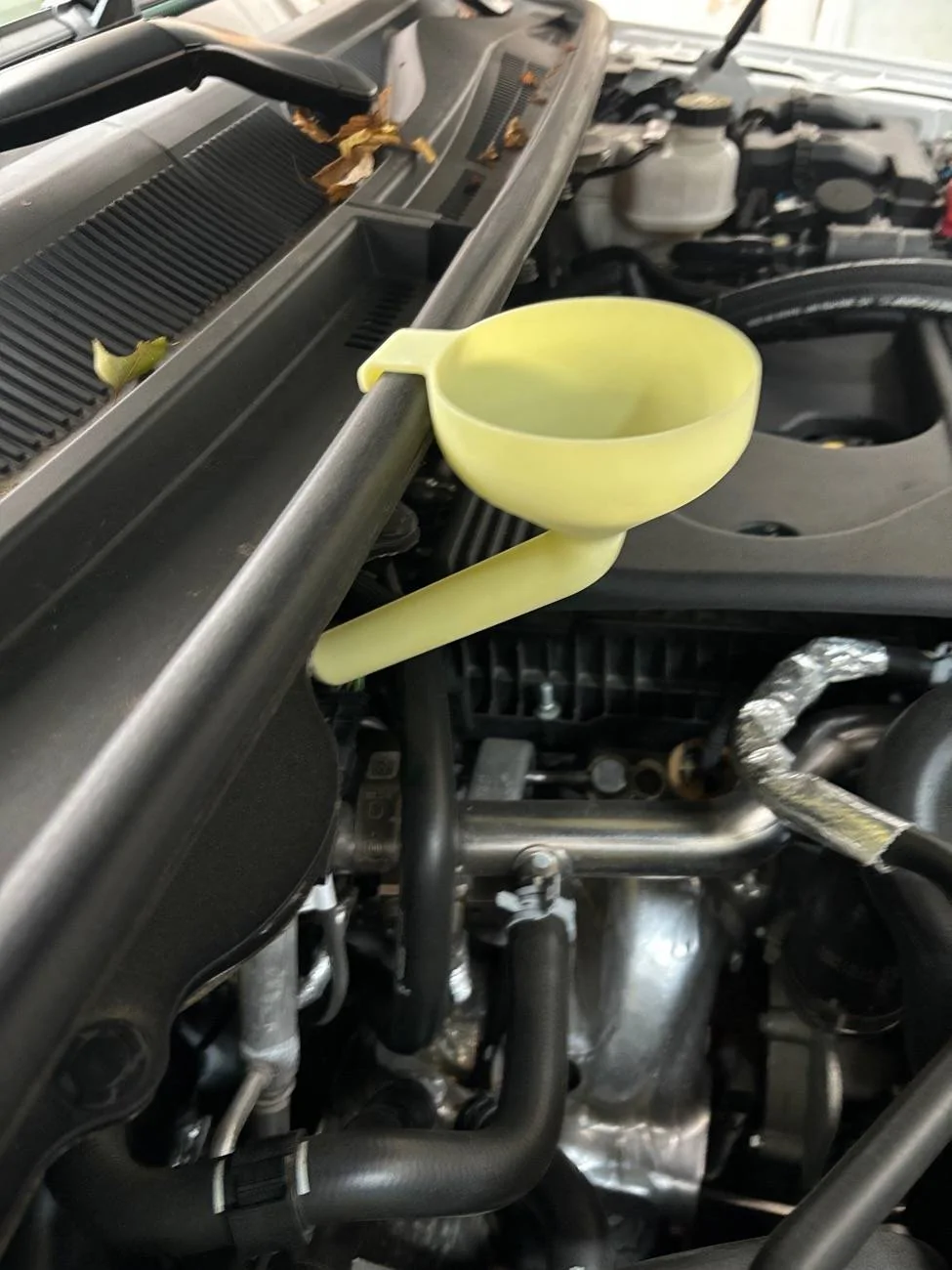

If any body looking for a trans dip stick for there ranger
Buckbull
Nov 9, 2023
348
1,396
Illinois
Software Architect
Someone recently mentioned the transmission fluid sale at NAPA so I bought a dozen quarts. Will be installing the PPE pan I bought from a forum member a few months ago. I'm interested in the funnel too, will put it to use really soon.

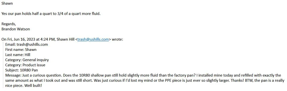

Don't forget that it holds about 1/2 - 3/4 of a quart more than the OEM pan. In case you were doing the 'measure what you take out to get close' thing.
RedlandRanger
Nov 14, 2018
42
5,124
11,158
I know there is an extended pan, but the "regular" pan holds more fluid than the stock one?
I've been contemplating installing one of the aluminum pans with a drain plug - there is some conjecture that some of the CDF issues have to do with weakness in the whole transmission housing due to the pan being plastic. Between it nice having a drain plug and this got me thinking..... I'm still on the fence but leaning towards buying one. At this point, I really don't see me replacing my 2019 for quite some time and I want to try and make sure I don't encounter transmission issues.

Yep, asked PPE directly some time ago:
RedlandRanger
Nov 14, 2018
42
5,124
11,158
Thanks - I will keep thinking about the PPE pan (don't need the extra capacity for sure) - maybe in the next 10k miles or so I'll do another fluid swap and add the pan. I do have the pump now, so removing the pan next time won't be nearly so messy. Once I install a new pan I won't have to worry about the mess.

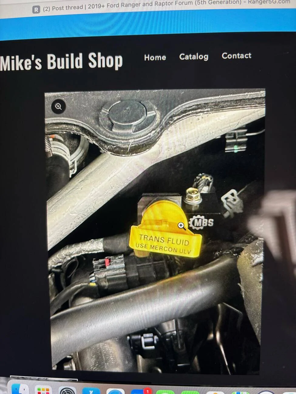

Yep, it and Mikes stick make it a no-brainer to do frequent-ish fluid changes.

If I'm being honest, the trans is the ONLY thing on this truck that I'm worried about. Mine shifts fine, but I'm trying to make sure it stays that way since I plan on keeping it long term. I have the Fitzstick, so I'm covered there.
