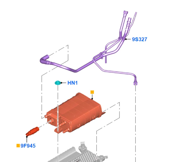

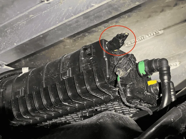

I'm trying to find a part number for a piece that's been removed from my truck and am having very little luck. I believe it to be a vent hose for the emissions canister, and unfortunately the post with the shop manuals for that the manuals are 0 length PDFs
The part I need attaches to a black box on top of the fuel tank shown here in the red-circle
and I believe it to be a vent hose that will end up attached on the outside of the fuel filler with some sort of cap/filter/one way valve on the top from what I can tell, but I could be wrong.
At the moment I can't fill the truck full speed, and it's thrown some Evaporative codes P0451 and P0496 and I believe it to be related to this being plugged and not in place now.
