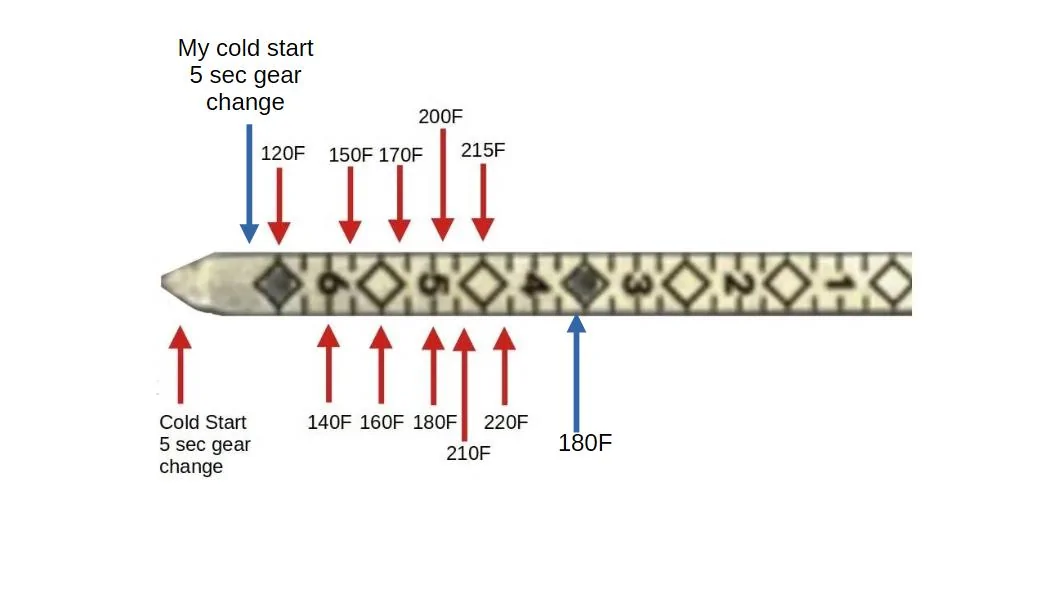

I still think Ford blew it on fluid temps. 160F-180F temp range will increase the life of the transmission. Simply from a expansion coefficient difference between aluminum and steel parts.

This guy makes a good case for a Fitz stick and a regular fluid change interval.
Good video, really informative, Thanks!
