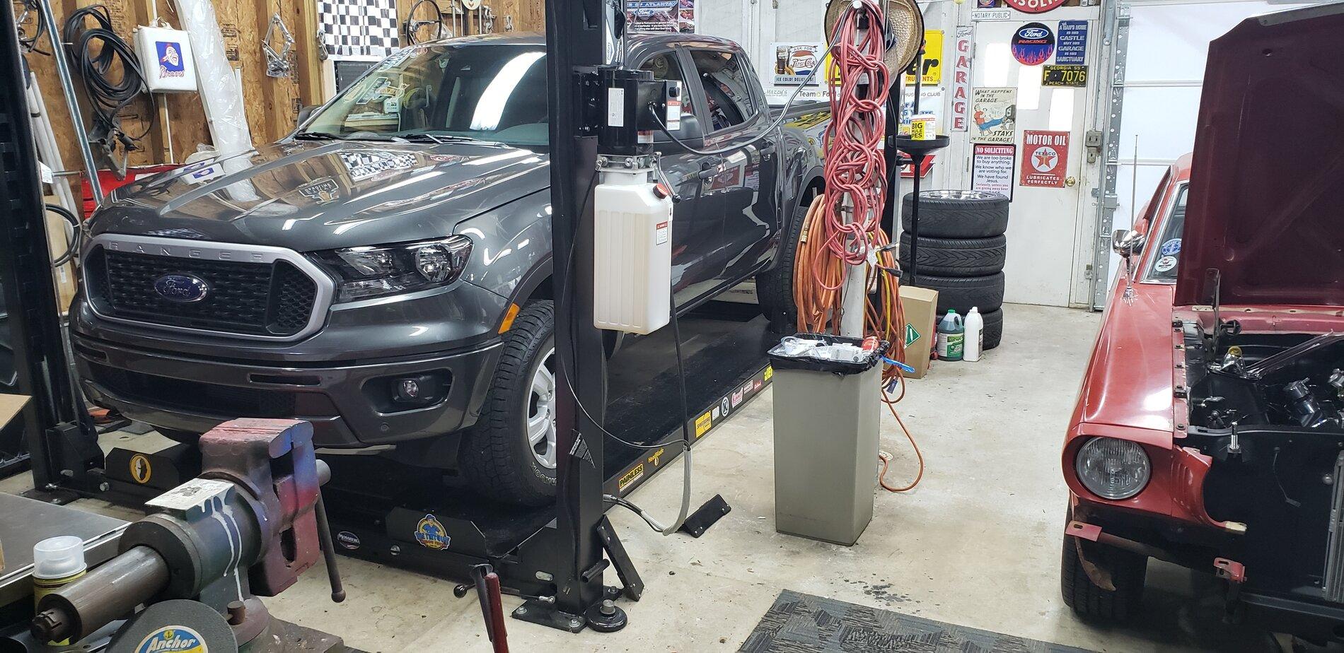

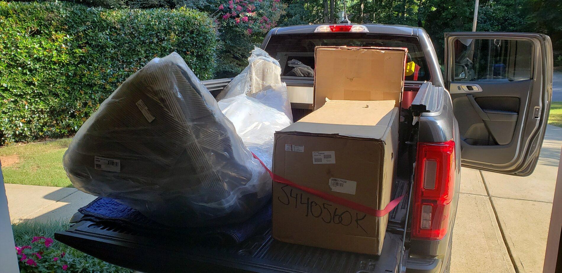

I started Friday morning by loading up tons of parts and some tools. I filled up a cooler with Gatorade, water, and ice, and went over to a friend's house to work in his back yard garage with four post lift to do some stuff to my truck!

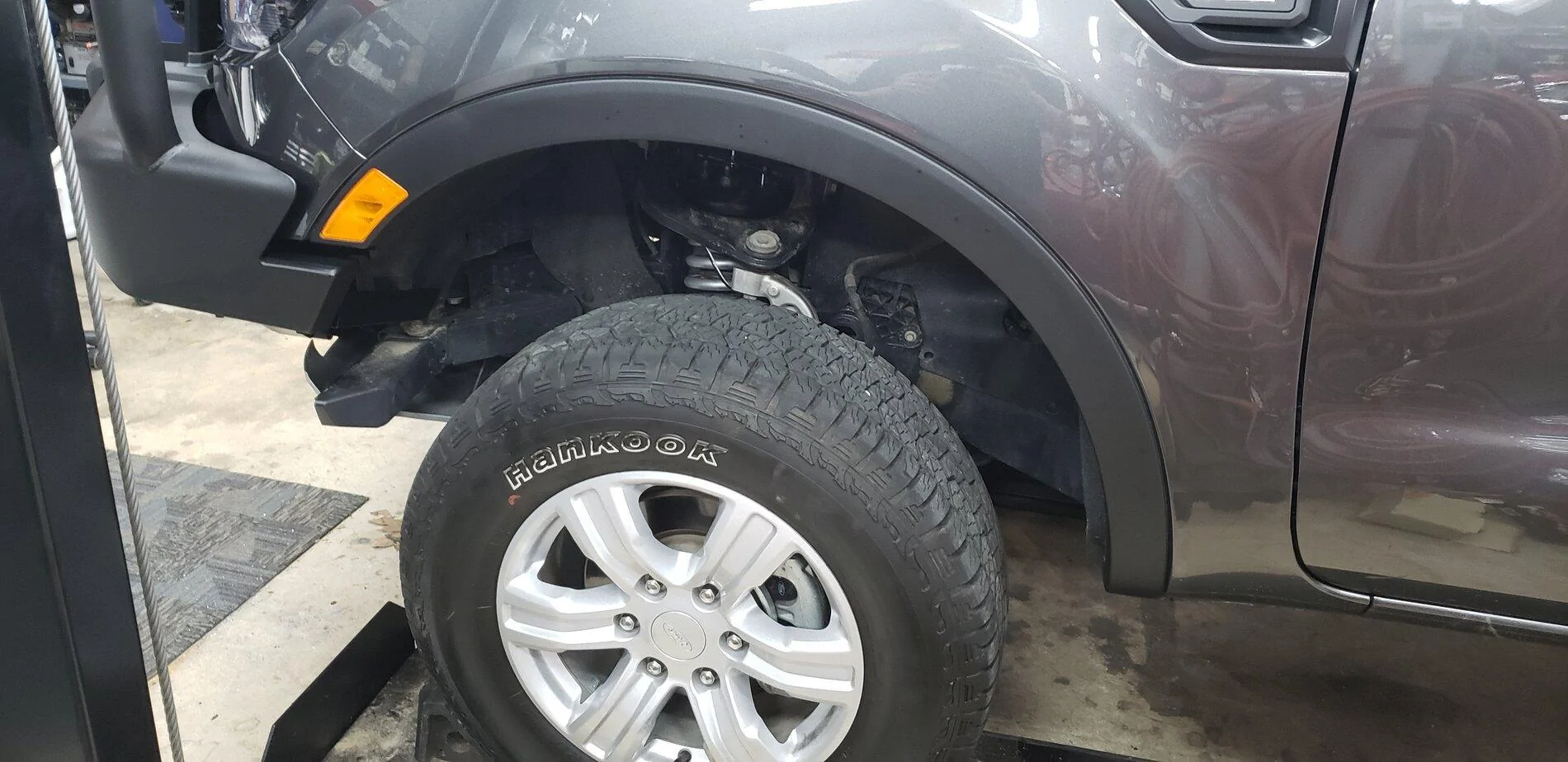

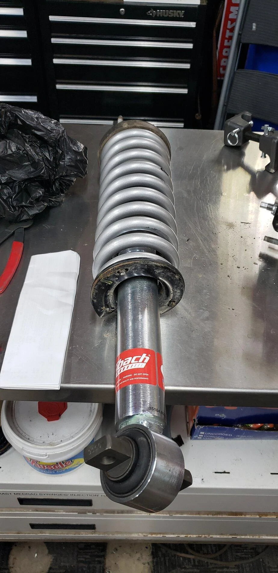

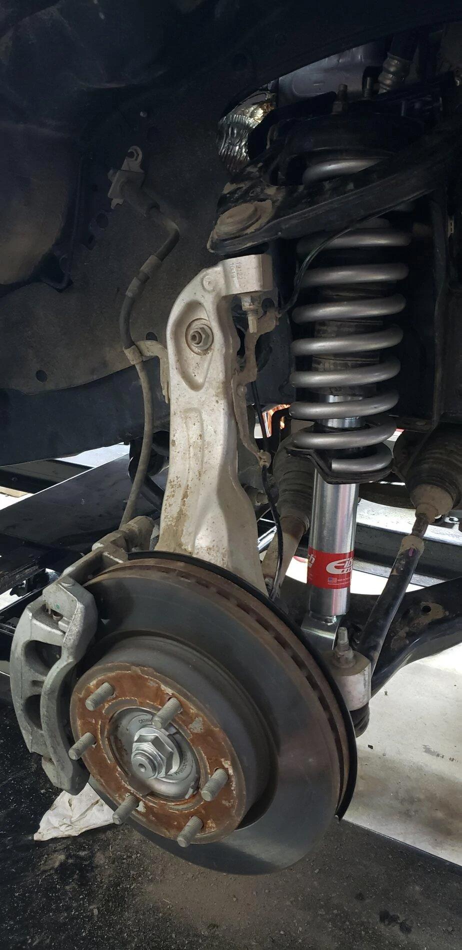

I was working on the truck by noon Friday, and got the stuck front bumper off before another good friend of mine came over after taking a half day at work to help me. I switched from the front bumper and we tackled installing Eibach struts, springs, and shocks.
We had some issues! First; the spring compressor I got from Autozone's loan-a-tool program wouldn't safely fit the stock FX springs and didn't come close to working with the Eibach springs. We had to haul the stuff over to a totally slammed 4Wheel Parts store, wait 40 minutes for them to figure out if they were going to be able to help up, and then another hour and a half wait to get the springs removed and strut hardware swapped over to the new Eibach stuff. It wasn't cheap but it was worth the money to get it done and get it done safely. We accidentally popped the shafts out of the front end, on each side. It was nerve racking but didn't tear the CV boots and got them in with about 5 minutes of fiddling around with it on each side. Then we had issues with the rear shocks because Ebach doesn't ship them compressed and we could only lift the truck so high on the four-post lift.
Oh, and Eibach has crap instructions.

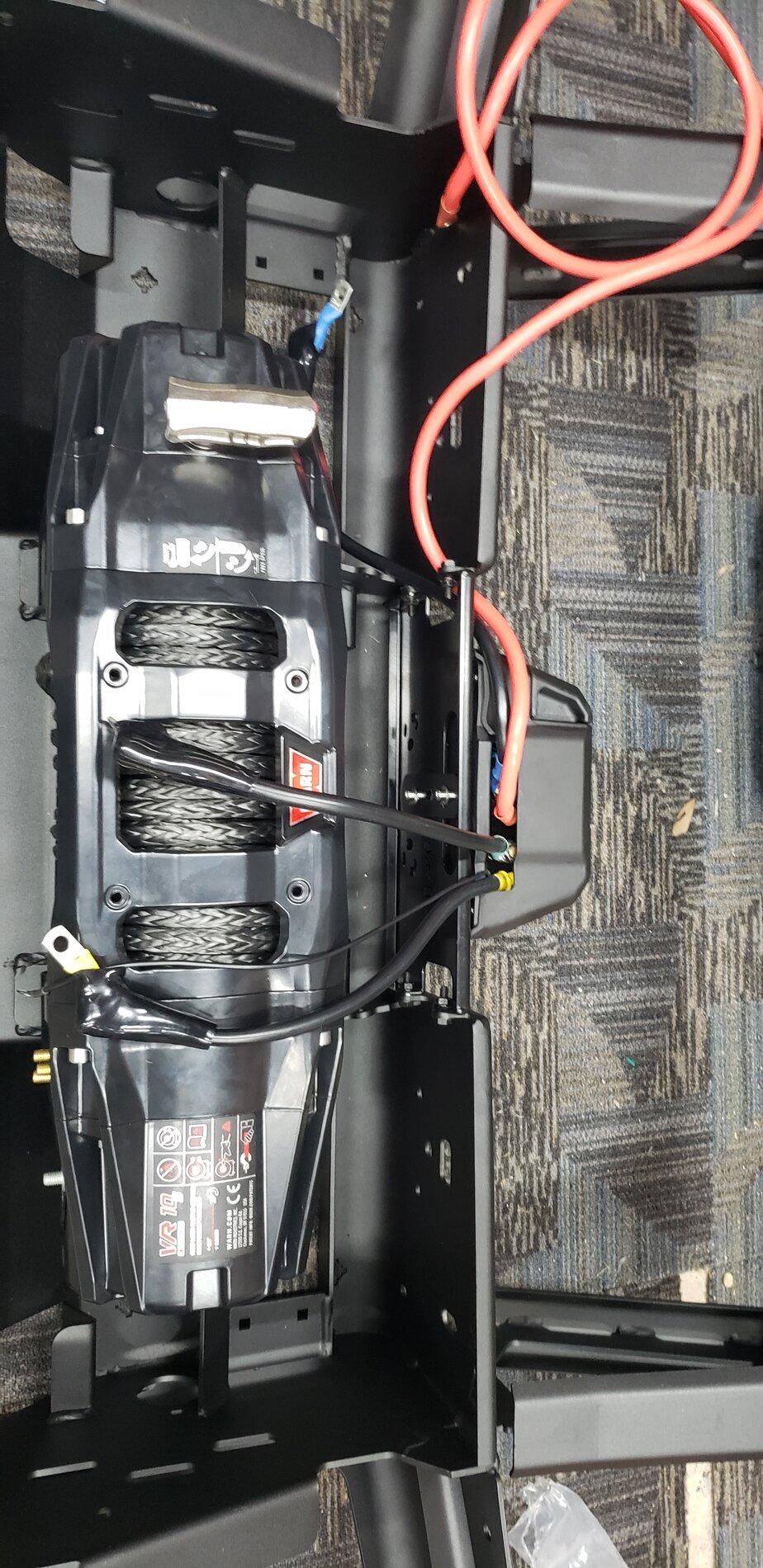

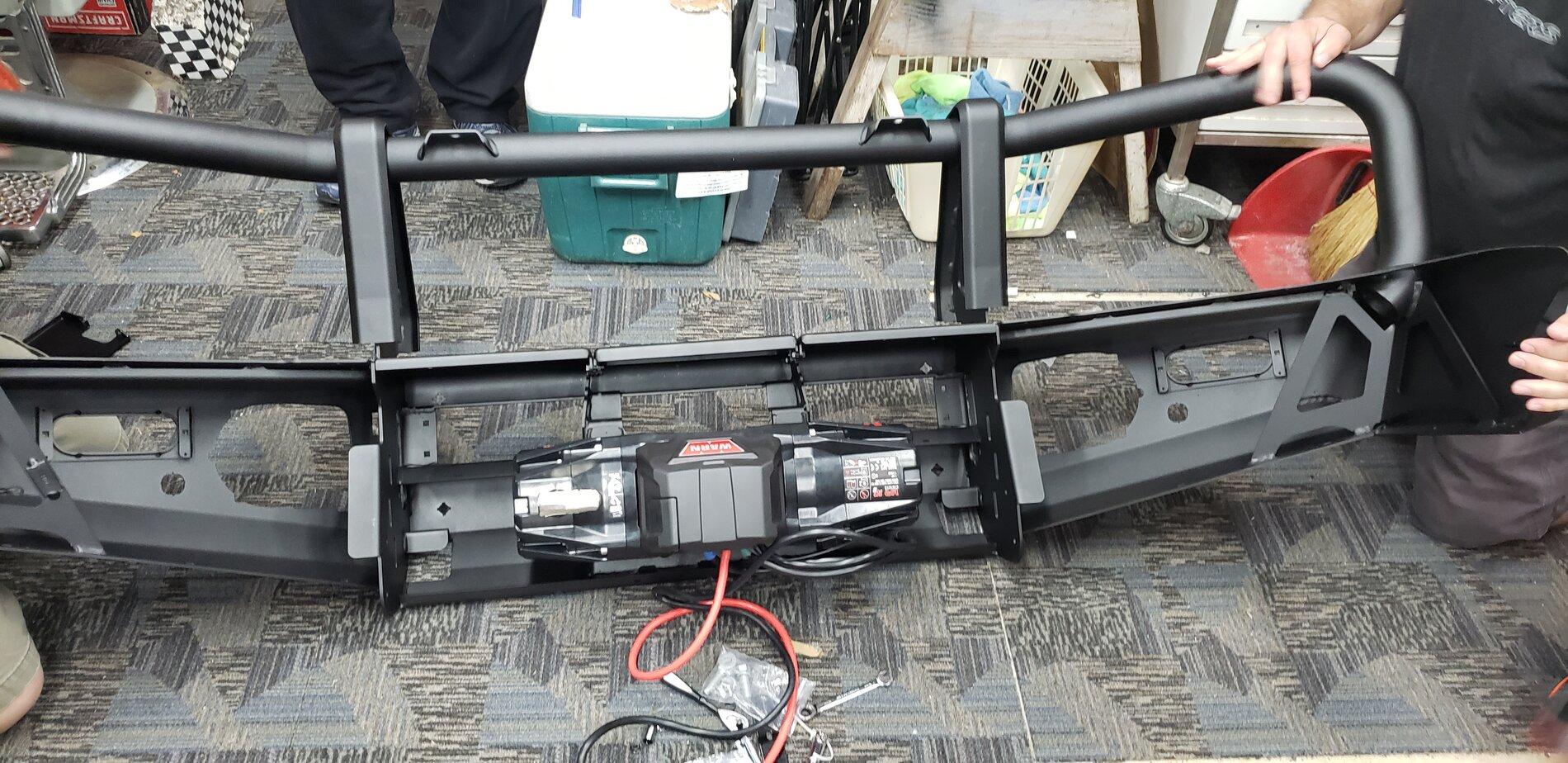

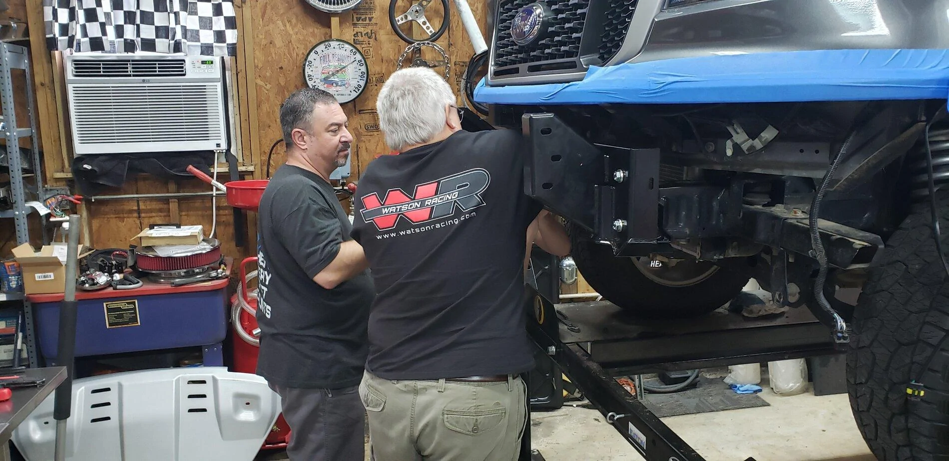

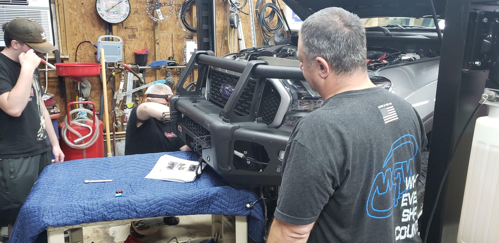

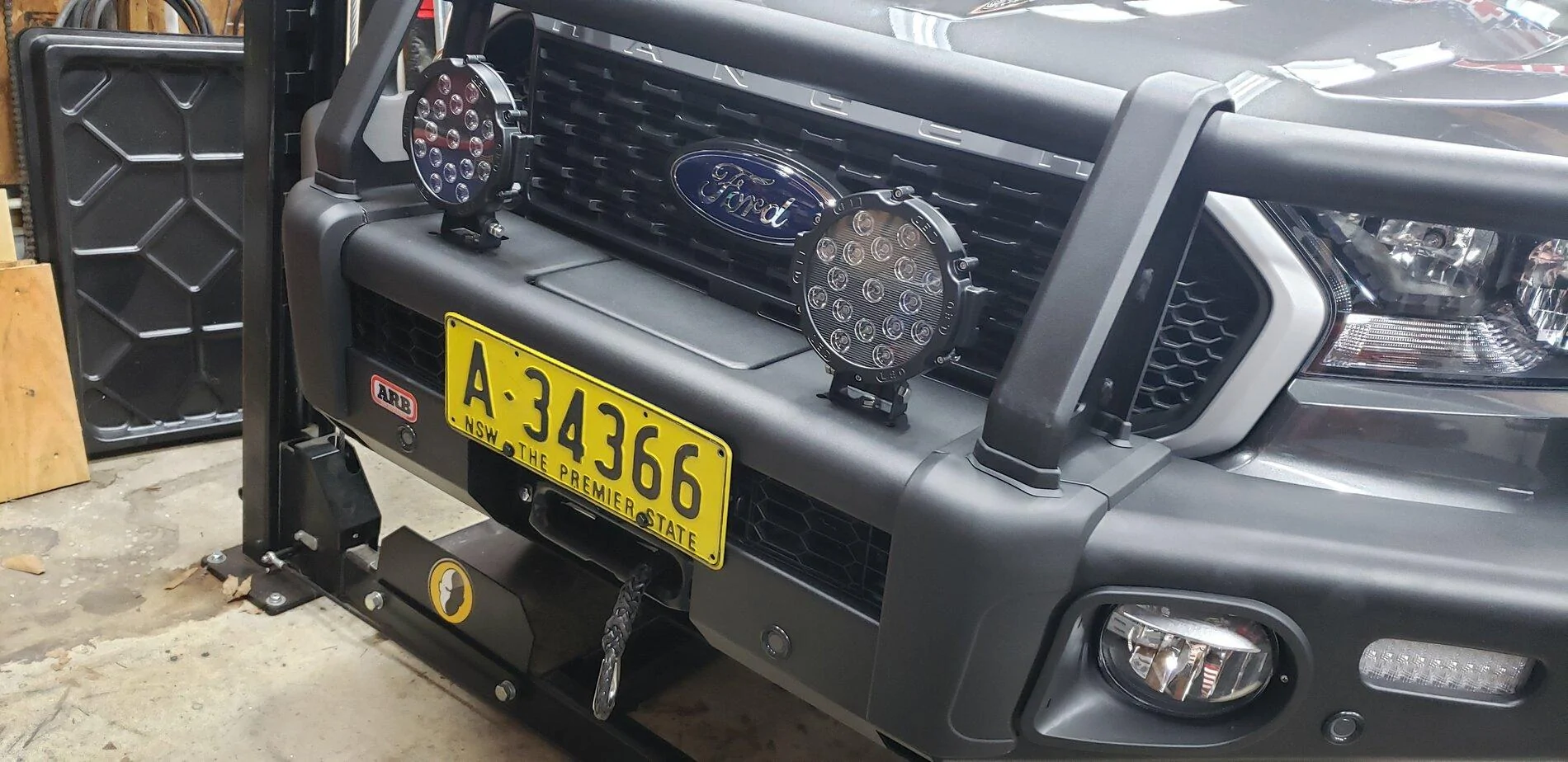

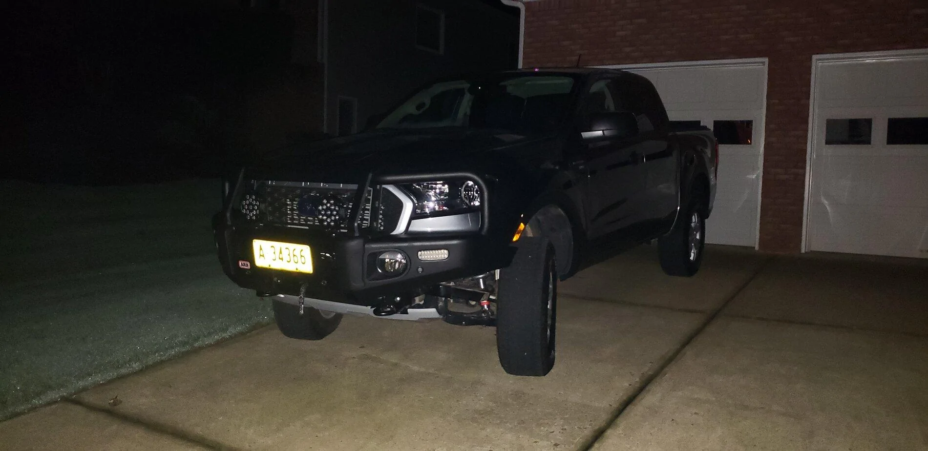

Saturday morning, my buddy picked me up and we went back to our other friend's garage to install the ARB Summit bumper. My gosh it was a PITA! It's heavy, there is a never ending pile of parts and hardware, and some of the instructions are absolutely worthless. The winch install, for instance, took a few hours because of the complete lack of usable installation instructions. A huge help was a third friend showed up with his son and they helped a bunch!

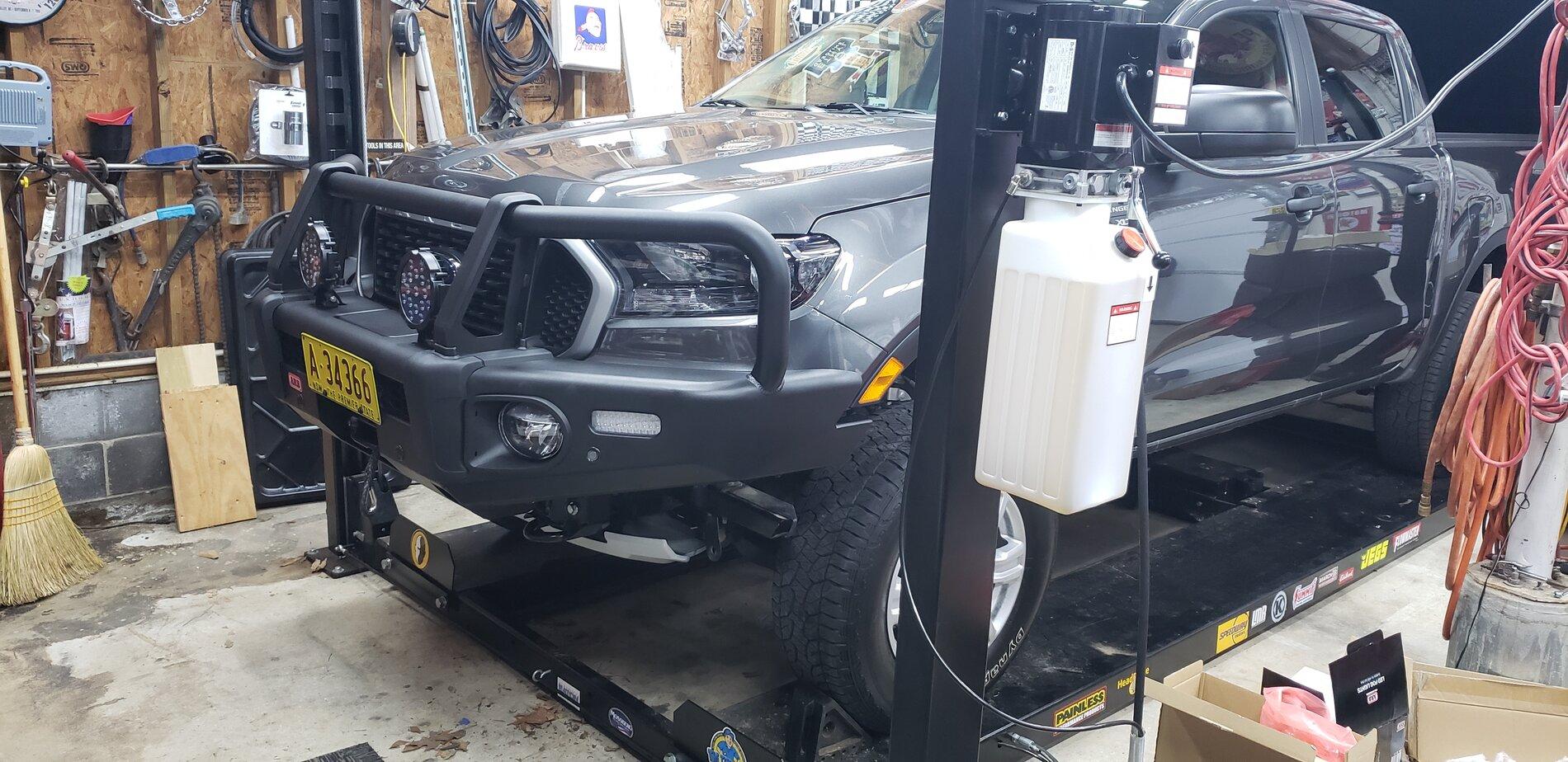

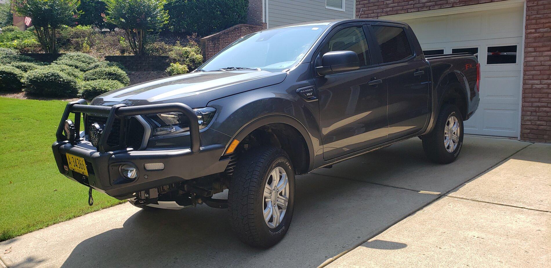

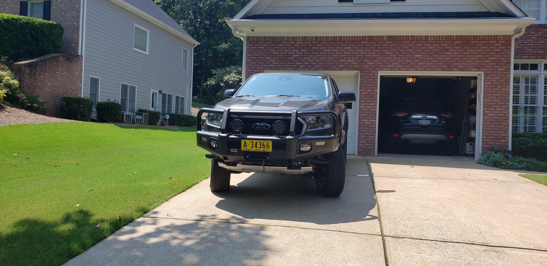

Did I mention the ARB bumper is heavy? It's ridiculous! We used a cart to hold it at a level we could work with it and used the lift to position the truck and get everything lined up. This part was very nerve racking but wasn't difficult. To cap it off, we installed an Australian license plate from New South Wales on my Aussie inspired Ranger.
Overall, I am completely thrilled with the stance and appearance of the truck! The front is slightly higher than the rear right now, but it settled a little bit with the addition of the bumper and winch. I'm really, really hoping it settles after being driven for a little. I really don't want to install blocks in the rear.

The bumper design is bizarre... it's just way to big and bulky. Kind of like installing a battering ram on your vehicle.
And the way it just leaves the front crash bars hanging out in the wind, also bizarre.
They sell close out pieces that cover the crash bars. I'm going to look into how much they cost.

Cost primarily. I got the kit for $495. I knew I have friends that know their way around a suspension so swapping over the spring perch and upper strut mount weren't going to be a problem. I also have Eibach lowering springs on my Mustang and I love how that car feels.
The ride is a HUGE improvement over the stock FX4 stuff. It's weird but it's like a 4x4 sports car!
Considering this is the year of MadMax-ville and it is Aussie inspired...;)
