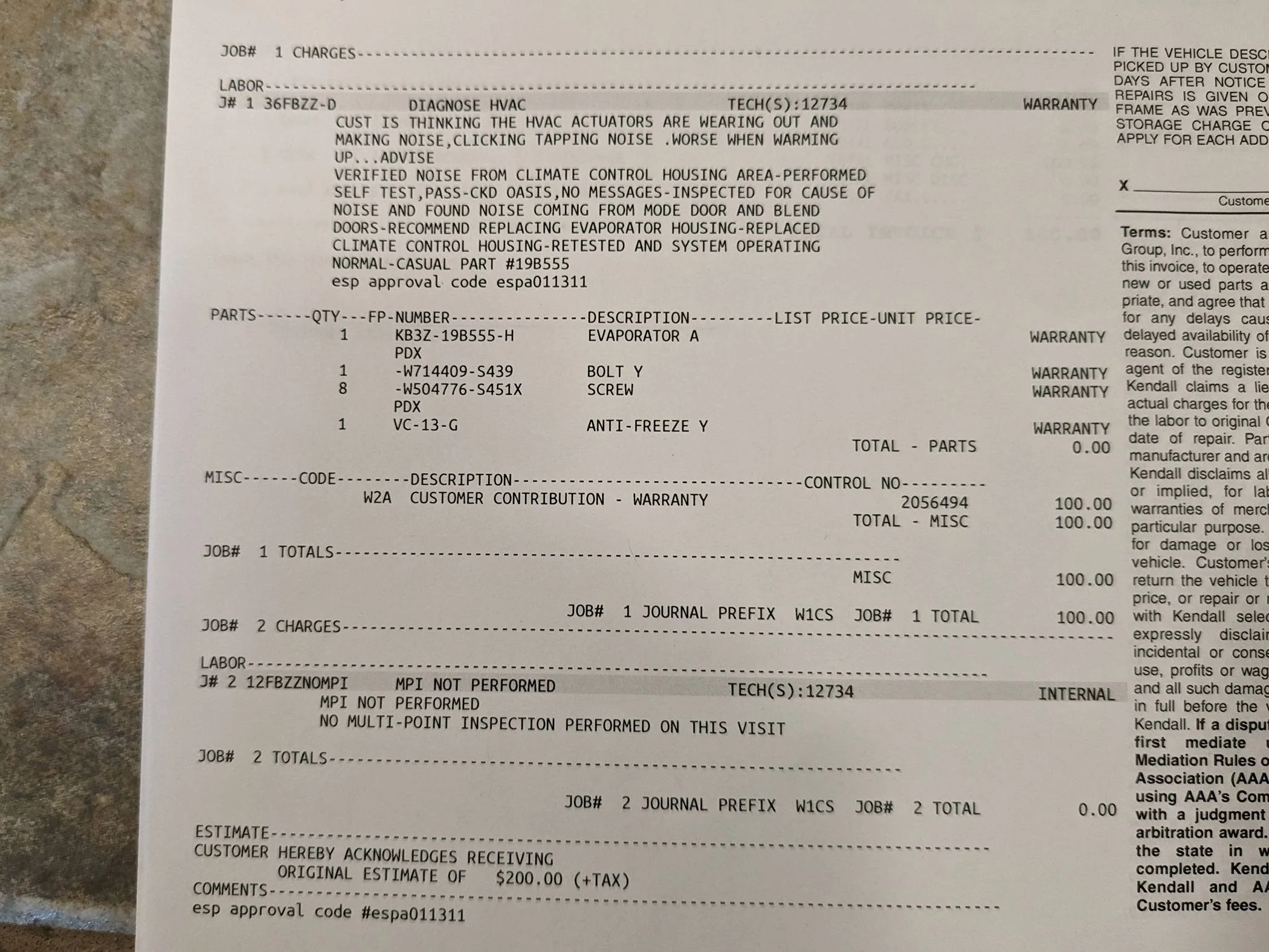

Picked the truck up today. Initially looks good. No damage or rattling, etc. They reconnected my light bar switch, TBC and Auto Stop/Start Eliminator correctly. The service advisor said it was probably the rubber/foam seal inside the heater box binding up the doors. He said they replace heater boxes on all model vehicles fairly often, not necessarily a higher number of them on Rangers. He said Ford Extended Warranty approved the repair easily. The repair is warrantied for 2 years, unlimited miles deductible free. After that, I would have to pay my deductible again. Here is the repair statement.

Picked the truck up today. Initially looks good. No damage or rattling, etc. They reconnected my light bar switch, TBC and Auto Stop/Start Eliminator correctly. The service advisor said it was the rubber/foam seal inside the heater box binding up the doors. He said Ford Extended Warranty approved the repair easily. The repair is warrantied for 2 years, unlimited miles deductible free. After that, I would have to pay my deductible again. Here is the repair statement.

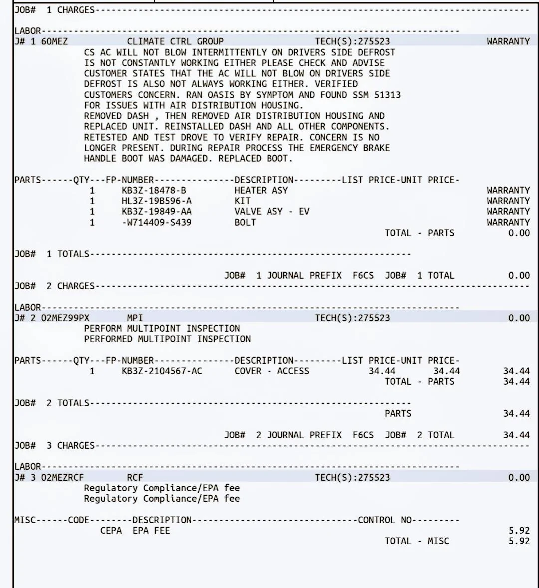

My 2019 truck has about 45K miles on it and I was having intermittent problems with the AC. It took a week but I got the call today - ready to pick up. I bought the ESP and how much did this cost me?
What is about to piss me off is it says they damaged my Red Line leather boot. Someone owes me $50.
