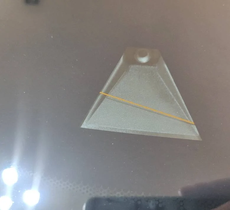

Is this normal?
Trigganometry
Dec 4, 2020
153
5,832
25,367
Engineering
These frontal cameras have many different techs all going on at once. Think newer generation phones. So LIDAR (distance), GPS (figures speed and direction) Image registration (some library type for street sign reading) All this is tied into other systems (crash prevention and lane keeping)
I can’t see that the wire would be in the cameras corrected focal length. Way to close to the lens for it to be in focus in anyway. The cavity the camera lives in is a plastic box that attaches to windshield. That why the heater is in there. It’s a closed space.

I've never taken a picture, but that thing is definitely a defroster. Ice melts right along that line to clear the view for the camera when the defrost is on.
Maybe it's both? The one smart Ford engineer combined the 2 for practicality ?

Basically the lens is able to focus on the point on the left and then the point on the right at different focus points. Then that will come back to the computer as photographic data. The engineering wizards are then able to translate that focal difference into a real-life distance in ft., meters., whatever.
So long story short - the camera takes a picture of the car in front of you, checks it against its little line, and if it violates a certain threshold it will sound the alarm. Does this at probably 24-30 frames per second - mind boggling stuff this technology!
I have to disagree with the characterization that this slanted line on the windshield glass is somehow involved in distance detection. As a disclaimer, I am not a Ford engineer, but with some publicly available information we can be fairly confident that it's not the case. As for why it's a slanted line vs. basically any other shape for the heater wire, I have no clue.
Monocular cameras, like the Ranger has, are the worse possible choice when it comes to distance estimation. If you want useful range estimation from cameras you use two spaced apart (like Subaru) or more (Tesla has 3 front facing cameras). Various Ford publications support an assumption that they're using a common approach which is to fuse data from a single forward camera with a forward looking radar sensor: Radar has excellent distance and speed accuracy but low spatial resolution. Cameras have great spatial resolution but low distance and speed accuracy. The vehicle's computers fuse those two sources together to get the best parts of both. The camera would also be used for other functions that radar is useless at, like visualizing lane markers for the lane assistance features.
Another clue is that the defroster line on the window is so close to the camera that it is almost certainly – and probably by design – out of focus. Rather than seeing a crisp horizontal line in the camera's picture, it's far more likely it's just a hazy blur over part of the image, which I'd guess is then calibrated out during manufacturing.

this is definately more concrete than the standard I read it somewhere else on google therefore it must be true.
Still doesnt explain mine where I specifically went out on a frosty morning to watch and see if it defrosted anything. which it didnt.
Do the wiring diagrams show any specific power wired in the upper harness to power it?
I've come across this pic last night, I am assuming those two dots are the windshield connections.

Well, the service manuals call out that it is installed, but reference this video of another forum member getting his windshield replaced, the installer points out a connector and it is believed to be for the heater. It is for a heater, but it is the Wiper Parking Grid, that was deleted.
You can possibly see the wire harness for the IPMA heater, when the installer is scrapping off his windshield decal (parking pass?)
So, the service manual calls out that IPMA heater is installed, and states that it is part of the windshield assembly.
The IPMA itself (connector-feeds power to the heater grid)
Windshield Replacement makes no mention of a connector on the camera mounting bracket.
Troubleshoot for heater, if bad - Replace Windshield
***I truly think, it is not a full power heater, it only defogs the inner windshield in front of the camera. since it is enclosed, and the truck defroster vents cannot reach that area.
This would be why - we do not see it working.
Which would explain a message I got this winter,
Front Camera Low Visibility Clean Screen, driving home from work, wet snow covered.
So, the pic of the Mounting Bracket, with the (2) wires is the Heater Element, now this Mounting Bracket is part of a new windshield.
So, it is a 50/50 shot if we actually have this on the bracket and or the wire harness for it.
Might pull cover of and see,
See attached for the references to the heater grid and connector.

svgrdr
Elton
Nov 11, 2021
53
Maine
2021 Ford Ranger XLT
Heater to clear ice
Edit: At least that’s what I read on here.
I can confirm, I've seen it defrost that little patch up top. It doesn't work as well as the rear defrost, but it definitely does what it's supposed to. You'll notice it when there is just a light layer of frost, not solid ice.
