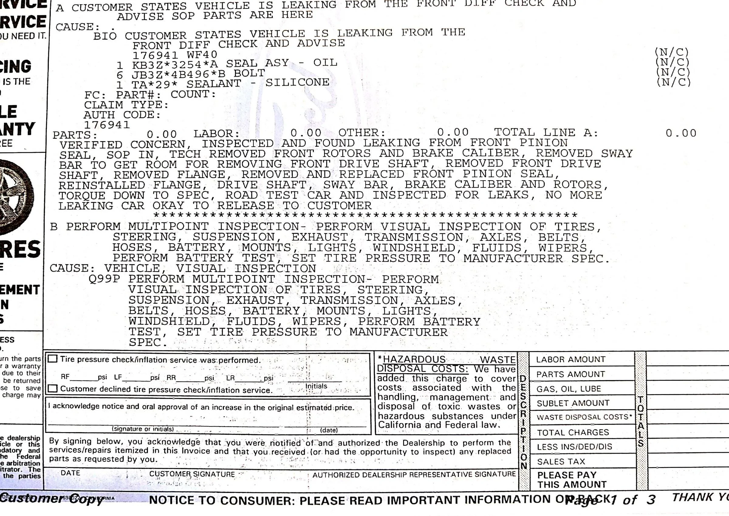

Update 1/25 #2 (final update I hope)
Got it back. Put about 30 miles on it dropping off the friend that helped me go get it. All seems good. Verified on the work order that I signed that they did indeed put fluid in it. Looks like it took the tech two hours to swap it out.
On to the next adventure. Glad I got it back in time to make a run up to the snow this year.
