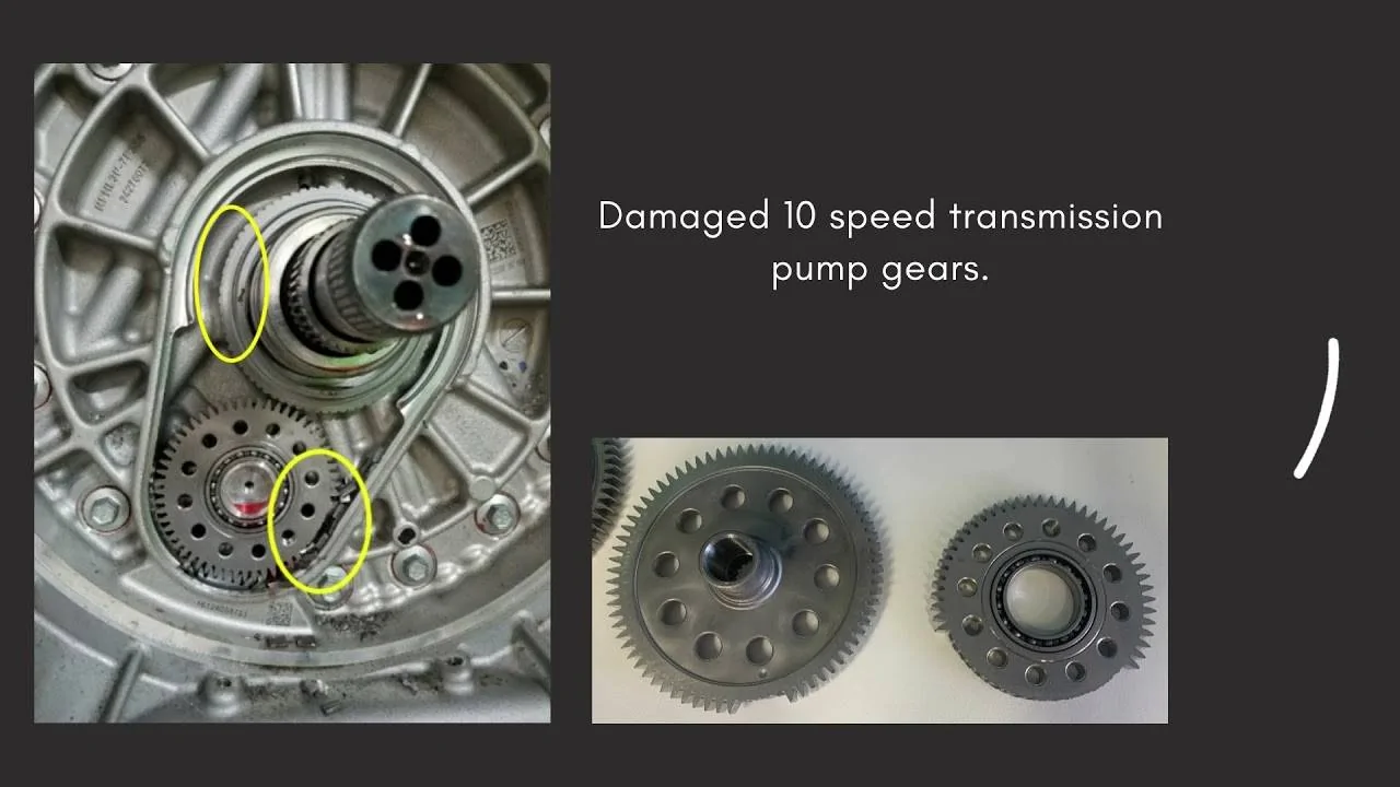

They're straight cut gears, so they rattle a bit (depending on the engine of course) at idle, and whine when the RPM is up. The rattle actually led to them failing in the diesel engined Rangers we have here in Aus, Ford had to go to a more durable material to stop the teeth shearing off.

Pic for detail. The 10R family have a slightly usual oil pump drive, but these are the gears that make the noise. The failures were seen with the 10R80 and 2L four cylinder diesel, Ford changed to a billet gearset in 2020 to address this. No idea if that change was specific to RoW Ranger, or all 10R transmissions.
