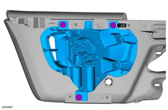

Hey everyone.
With the recent snow, My truck hit a spot of ice on a turn and I took out a mailbox with the front of my truck. No real damage, other than my bug deflector being cracked in half, and my passenger side fog light housing broken (Light still works, just the plastic around it).
I ordered a new set of Fogs with the housing. How difficult is it to swap the trim pieces in and out?

I'd have to look again but from memory, all the fasteners are rather easy to get to.
Remove the three, unplug connector then they should freely come out.
Little more involved than that, while not hard, there are various layers of trim you have to remove.
First are the black plastic covers, then the metal brackets, then you can access the actual housing and housing trim.
Well I guess you can skip the black trim top layer if you feel like working in a squished area. Trust me, remove all of it for a less frustrating experience of trying to maneuver your wrench and screw driver in odd angles trying to remove the stuff. With all the layers off you have a giant open area to do the work.

random loop back - as I tried blindly to "pull the plastic trim out" today . . . is there a write up some where, with pictures on how to do this from inside? All the videos I have found show pulling the front of the bumper off as the easier way to access the lights. . .

the cali raised video which is the best video I have found yet, shows 3 bolts (goto ~1:30) that hold the plastic to the bumper, one of which is one top and I don't see how it would be accessible from underneath . . .
