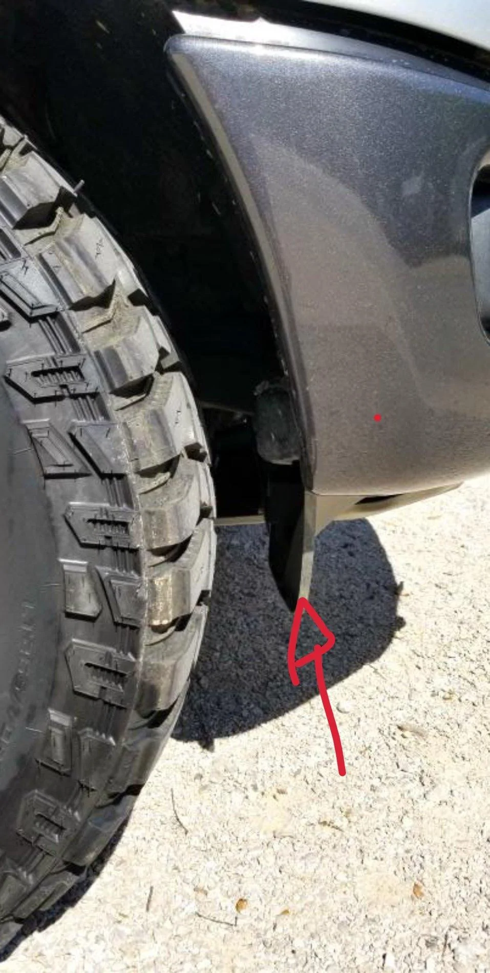

Digging around i can reach the bulb and remove it from the housing and put it back. However there is not enough slack for me to undo the bulb from its connector.
So what are the proper steps to access the fog light bulbs?
Thanks!
Bobby-C
Robert
Dec 7, 2023
128
99
Indiana
2019 Ford Ranger Lariat
Local 1 Chicago IL Ironworker (retired)
Remove the connector first than twist it out
