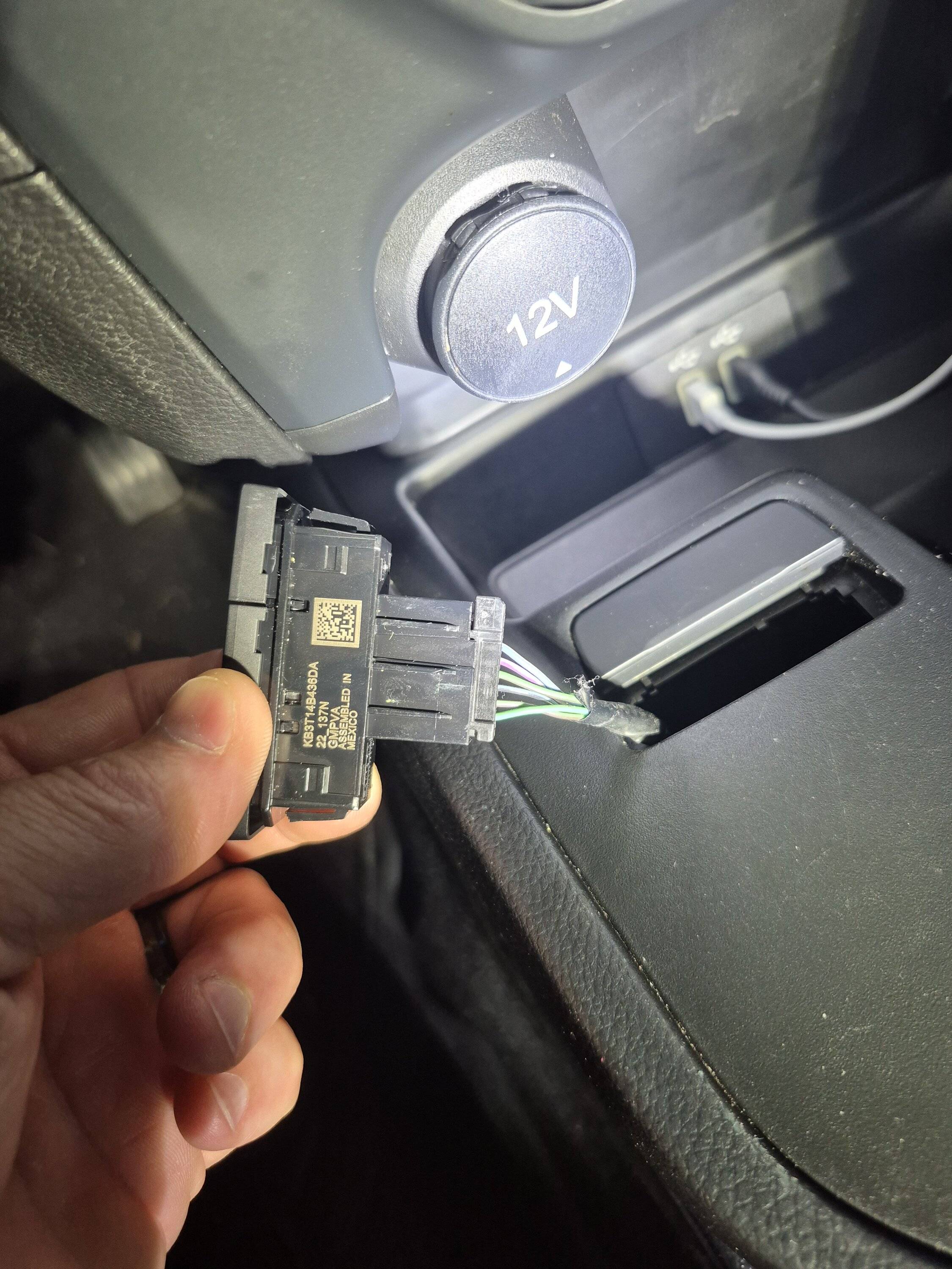

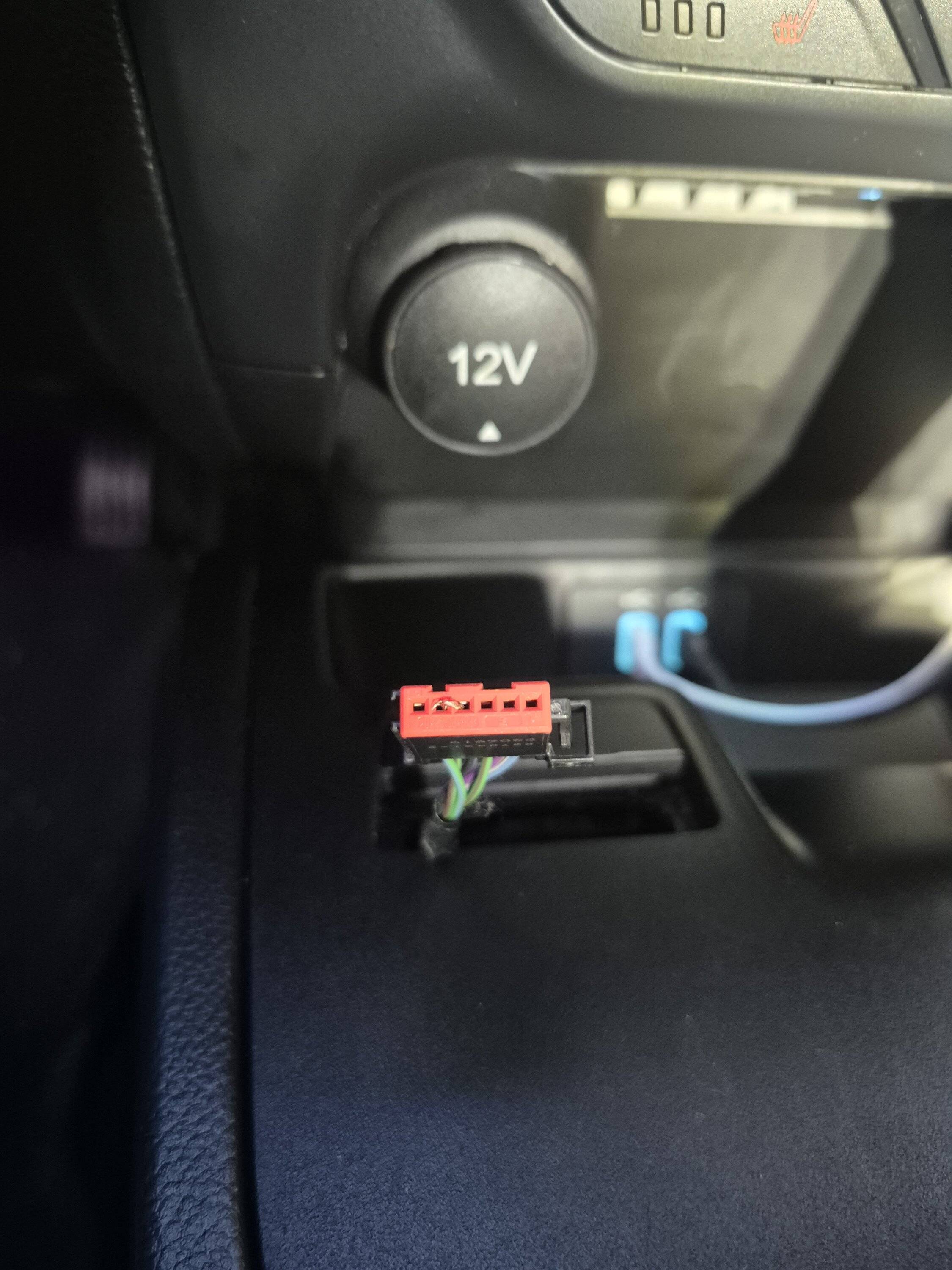

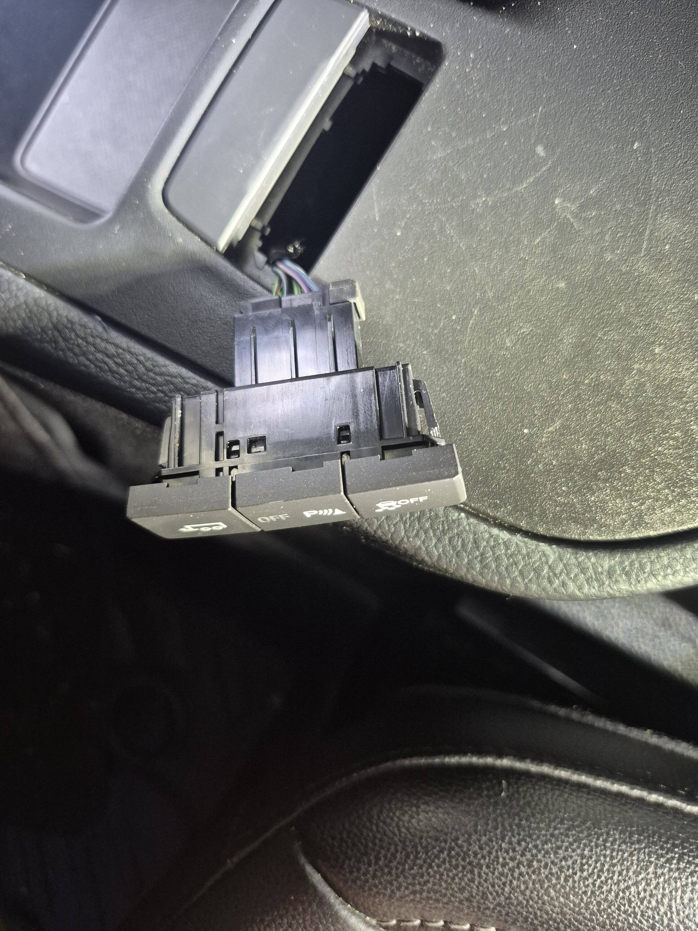

I have seen this question asked several times and I prefer to drive in Tow mode. **Note** this will prevent from going back into "normal" mode unless you cut a wire put an actual switch inline.
So I discovered if you press and forever hold the switch it will start and stay in town mode with no other adverse effects to any other system (everything continues to work as intended). So after doing some digging all of these switches ground on a main wire which is black/blu stripe. On my plug it is the third wire from the tow button side. The tow button wire is the second wire which is green/brn stripe. So the two wires that need jumped are side by side. I pulled the switch and incerted a wire across these two pins in the plug (see pic)
The best way to test the buttons is pull the switch and check the pins with a OHM meter. But I suspect all 5g will be the same placement. As I said this has not affected any other function of any system.
To pull the switch, use a plastic pry tool and start behind the shifter at the cup holders and work your way up each side. It will not come completely out but it will lift high enough to depress the clips on each side of the switch (see pic) Then the switch lifts out of the plate.
This is all that is needed, I have been driving with this for some time with no issues whatsoever. This mod is very easily reversible and as I said earlier if you wanted to be able to still switch drive modes just cut the Grn/Brn and run through a switch. That will allow consistent normal mode or consistent tow mode.
