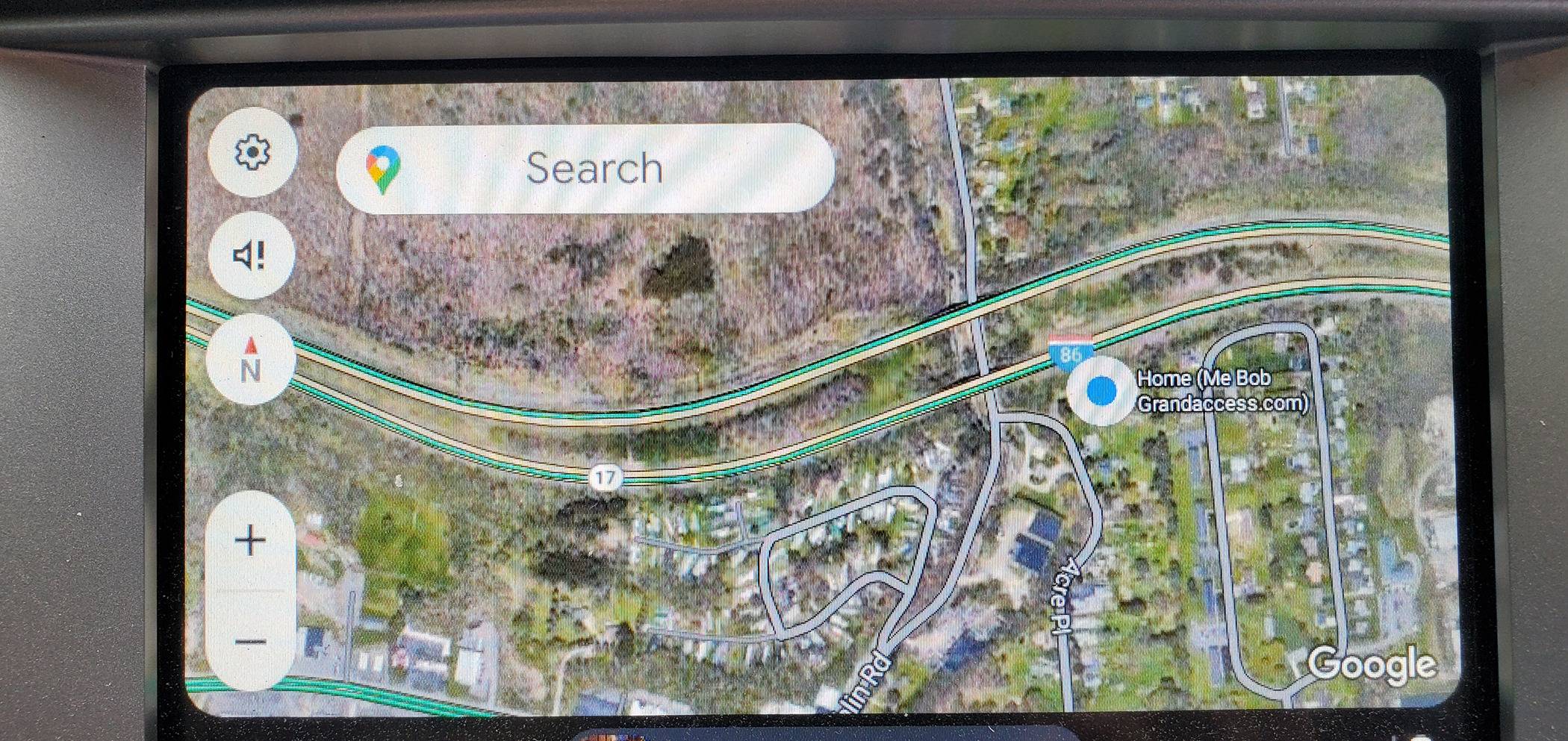

Google Maps on the Phone is so much better, you dont always have to be updating/upgrading
its real time traffic and cops alert and I like the Sat. over view so I can see buildings and parking lots around me, why would I download maps to my radio?
