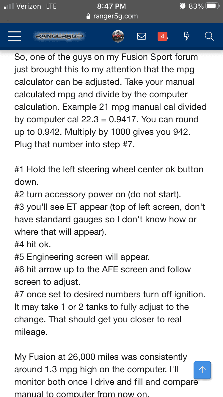

Hey everyone! Just curious... How do you reset the mpg? I've tried with the buttons on the steering wheel but didn't find anything. It's a 21 XLT Fx4.

push and hold the ok button

You can also “dial in” the MPGs if you want it to read accurately.

That's pretty cool I'll keep an eye on mine and see if it's accurate.
