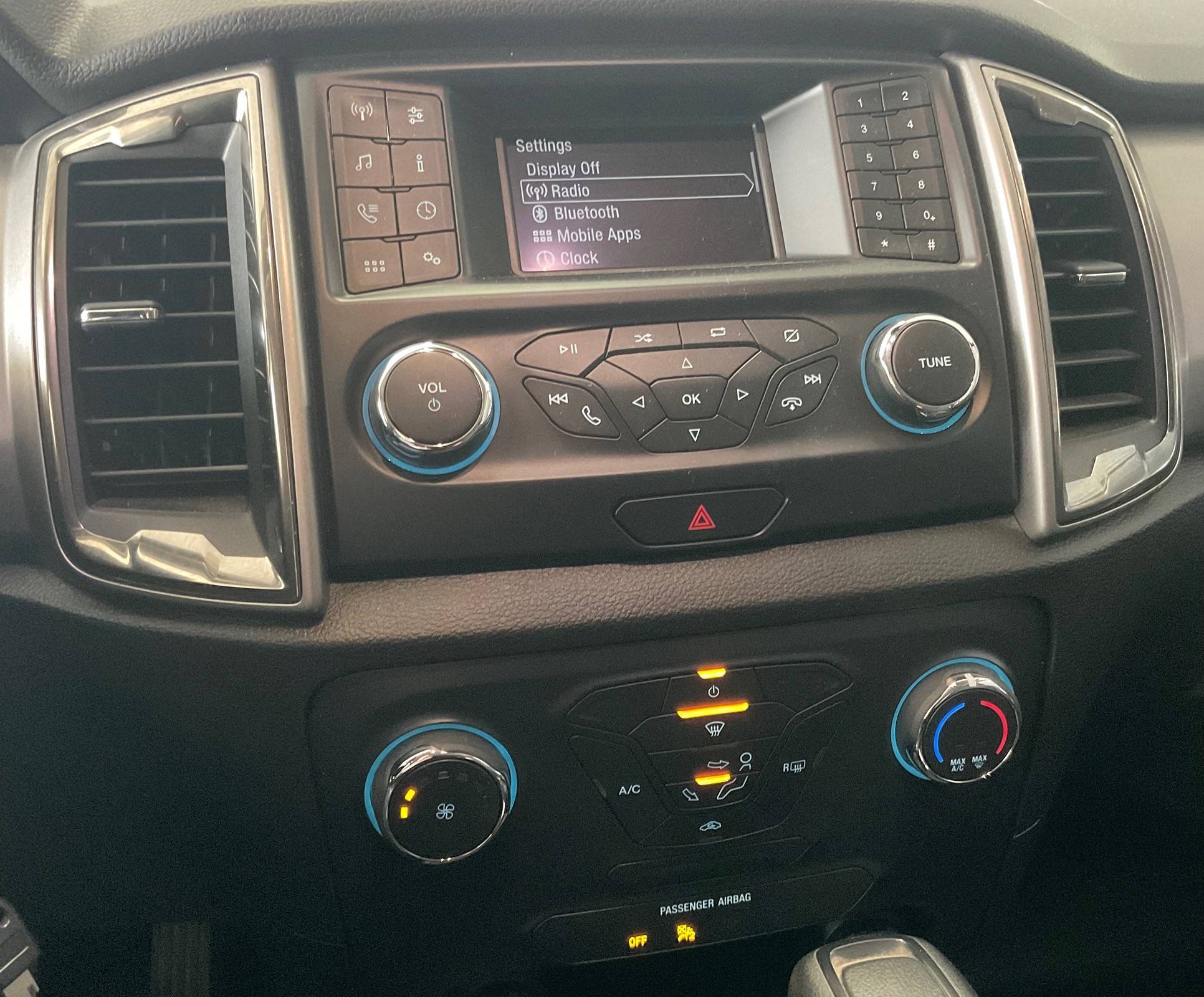

I think there may be something to this. When I put the key into the cup holder as if it was dead, the screen boots 3-4 times faster and I dont get the low battery message either. I havent tried the other fob yet, but I will, just to see if there's a difference.

I get a "Low key battery" warning about 2-3 times a week. Key has a brand new battery in it. But beyond that, I have to reboot the entertainment/nav screen using the power and FF buttons at least every other day. Sometimes a couple times per day.
