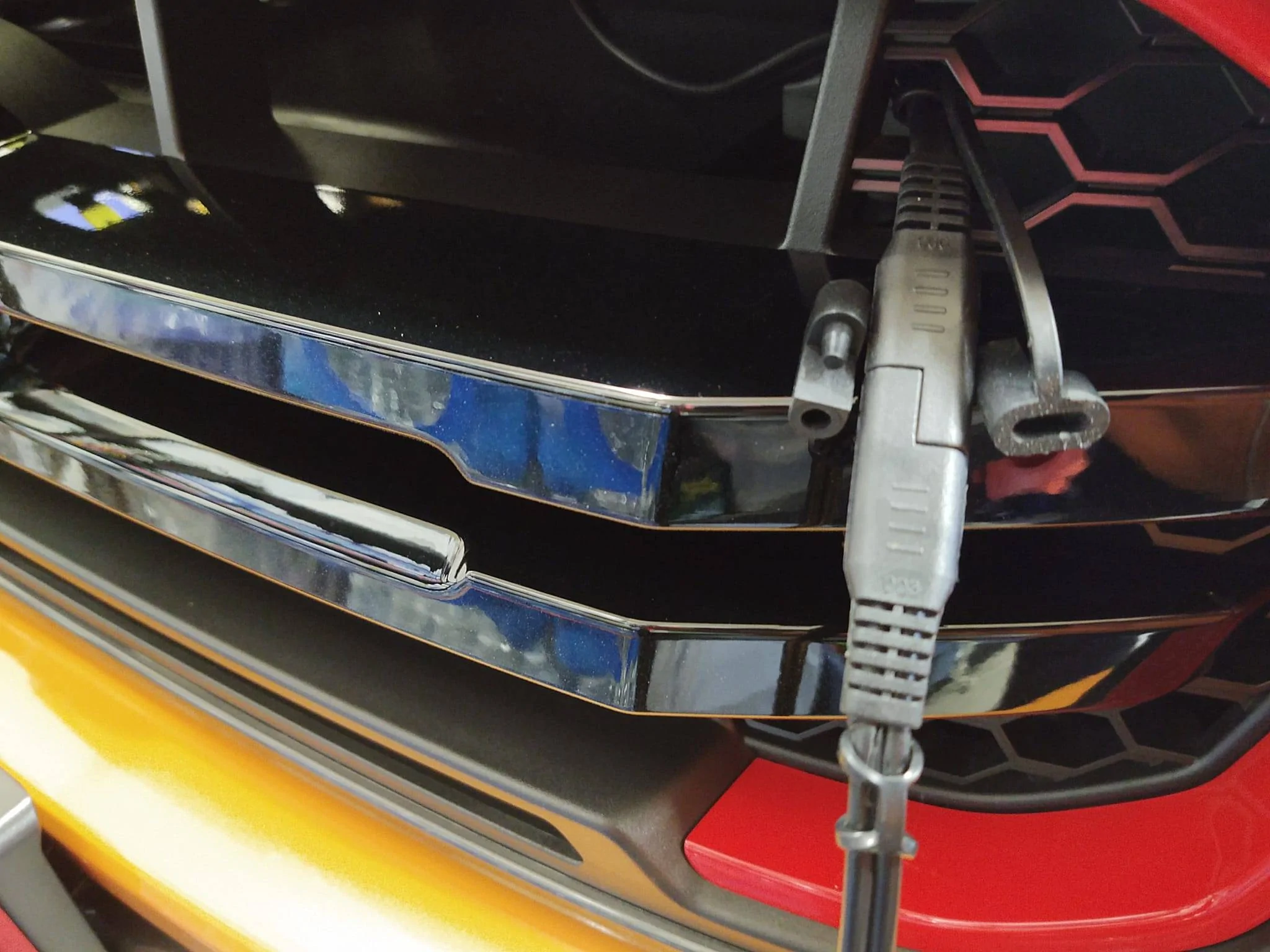

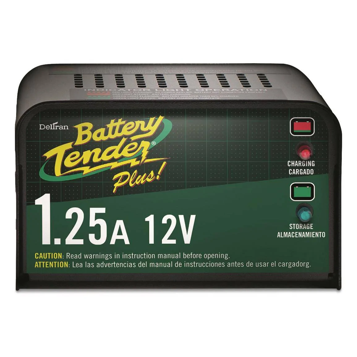

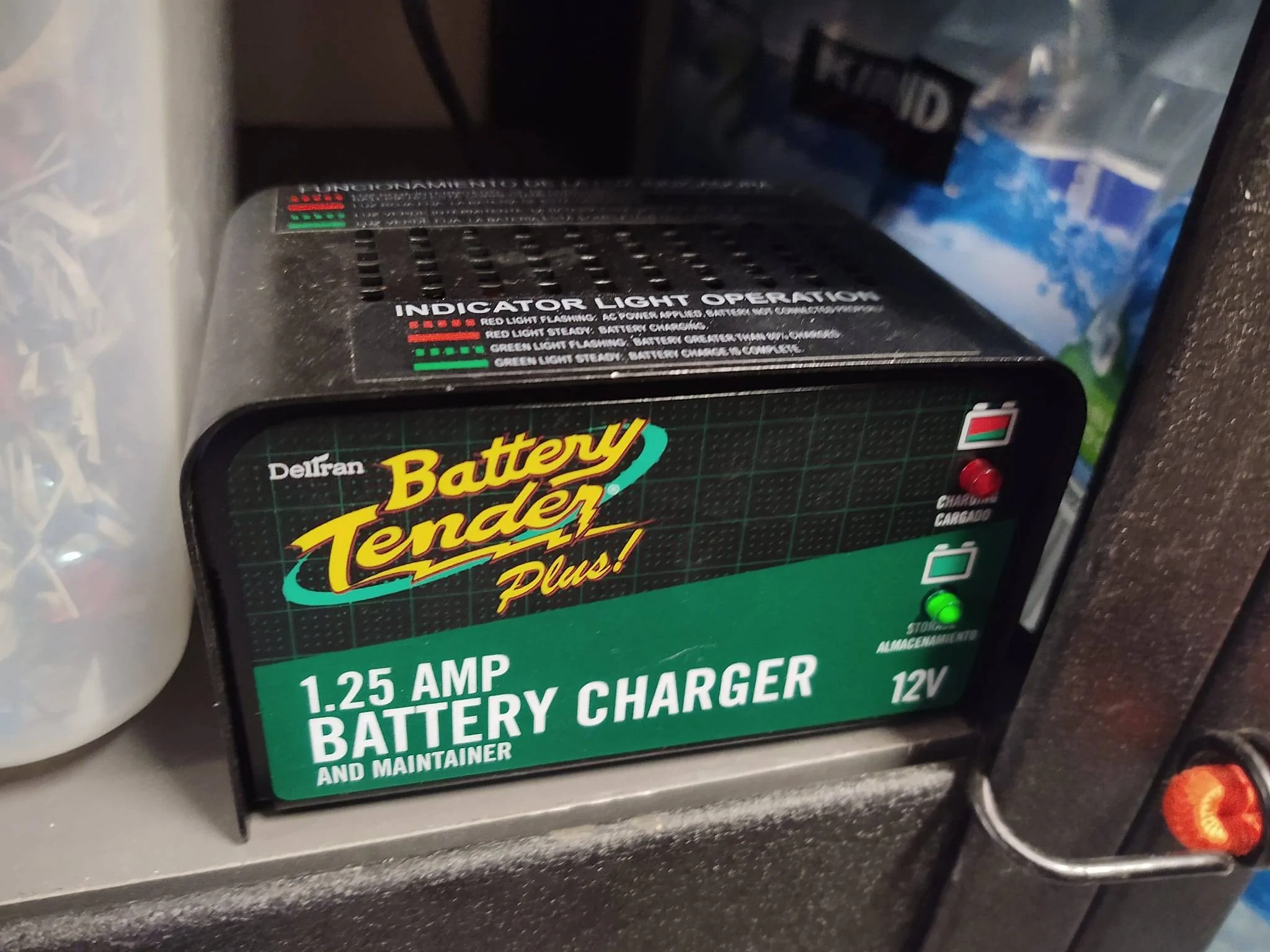

So a quick question for those more familiar with the electronics and battery maintenance (an apologies if it has been asked before) - How often is often enough to start and run my Ranger that would eliminate or greatly reduce the need for a battery minder? Typically, I am in my Ranger going somewhere at least twice (sometimes three times) per week, although it is possible that those trips may be less than a mile each way. Is that sufficient for battery maintenance, or do I need to think about a installing a battery minder?
Starting it up and just running it is really not a good thing to do. I would just get a battery tender and use it. I use the Deltran Battery Tender on everything we own. My Tremor is plugged in 24/7. This will lengthen your battery life and your truck is always fully charged and ready for the road. I have the quick disconnect coming out the grill. A warning though so you don't drive off connected....I got one of those "Remove Before Flight" straps, tied some paracord to it. I hang it from the turn signal arm across the steering wheel. This reminds my to unplug the Tender before moving/driving the truck.
