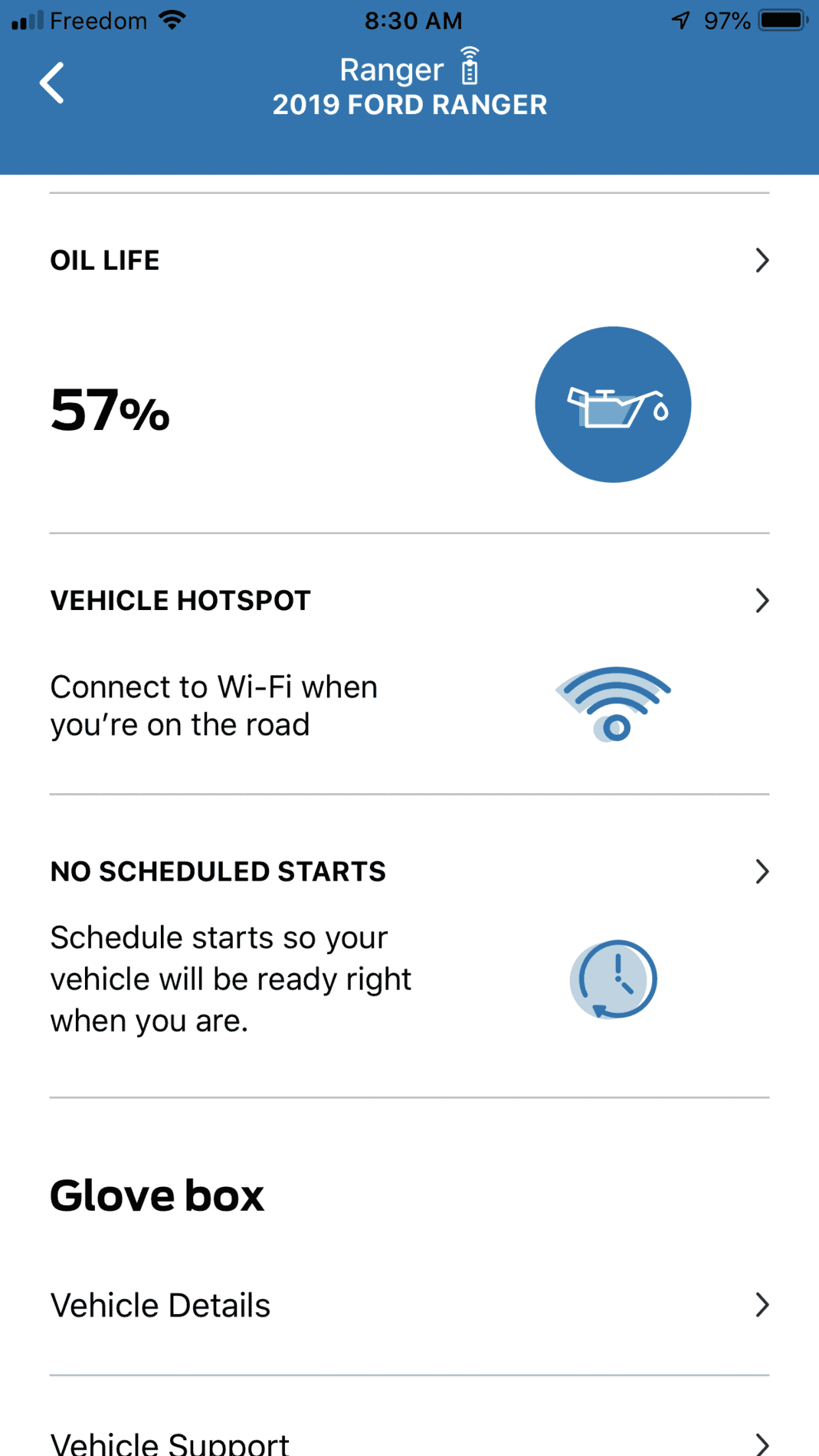

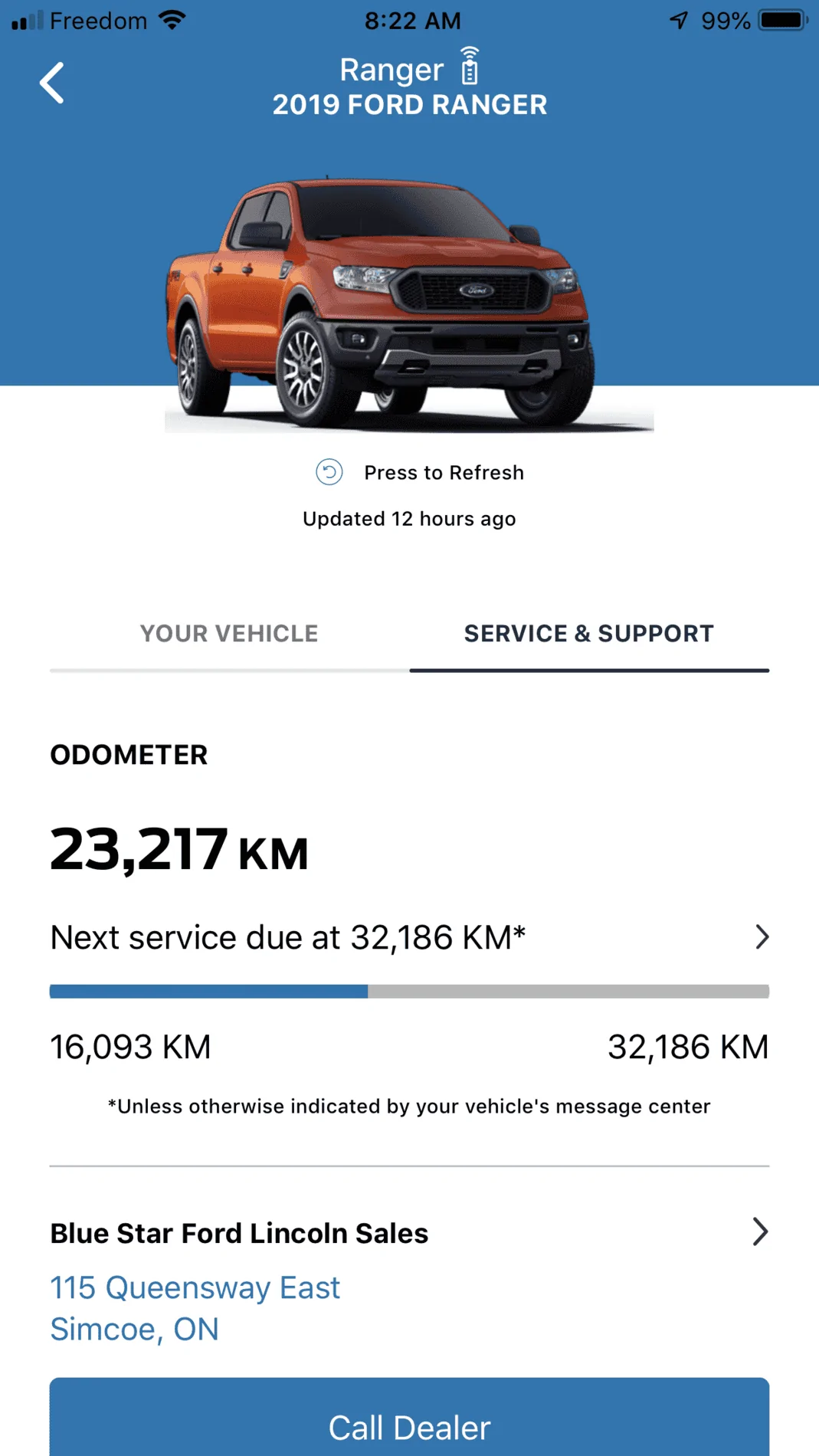

So should I go by the oil light/ FordPass app that shows my oil life remaining ?
I bought my truck at a dealership about 1.5 hrs away and pretty sure they said to go by it.
So my first service was just before
16k km /10k miles my service soon message came on the day before my appointment
I took it to a dealer near me for service and they told me I should have come in at 8k km /5k miles
Then on the sticker they put 24k km / 15k miles as my next service .
I’m at 23k and My app says I have 57% remaining and to go at 32k km
So do I listen to the app/ truck?
Or listen to the the dealer?

I know there is a lot of varied opinions on this, but I would suggest going with what the computer on the truck tells you. Changing your oil more frequently doesn't hurt anything, but I don't think it is necessarily a good use of money either (I don't think it really buys you a lot), assuming you use a quality oil and filter when you change it.
I'm guessing they want you to come in at 5k intervals to generate additional revenue for them. But maybe I'm just being a pessimist.

my dealer sent me notice to change my oil at 8000km, when Ford Pass was telling me it was due about 16000km.
Since I wanted the truck looked at anyways for a few items, and verify some service bulletins, I took it in and did the oil. They put a sticker on my window for another 8000km due. It was their free gifted oil change anyways for purchasing the vehicle.
Im following the Oil Monitor regardless unless there's another reason why I should take it in early. Im not letting the stealership fleece me for oil changes that are not required.

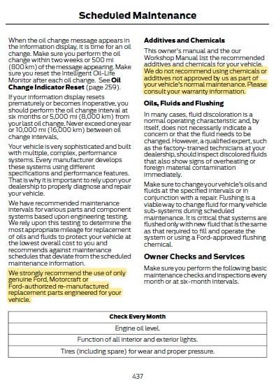

No way I'd go 10,000 miles between oil changes, or tire rotation... I'll be using 5,000 miles for both. It makes sense to rotate the tires at the oil change, since they will remove the front left tire anyway during the oil change to access the oil filter.
Why 5,000 miles? Do your research on direct injected turbocharged gasoline motors. Most manufacturer's (including Ford) have an issue with carbon deposits accumulating on the back of intake valves. Keeping the oil as clean as possible will help with that issue... and using 100% synthetic oil such as Mobil 1 (not the blend recommended in the manual) will also help with that issue.
In this case the dealership is steering you in the right direction by recommending more frequent oil changes.​
Also note the owners manual of your truck talks about 5,000 mile oil change intervals in the event the onboard oil diagnostic system fails. See below.
