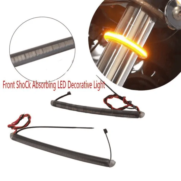

Okay, I'll be the mature one and steer this thread back to lighting.
I want this for my damper:

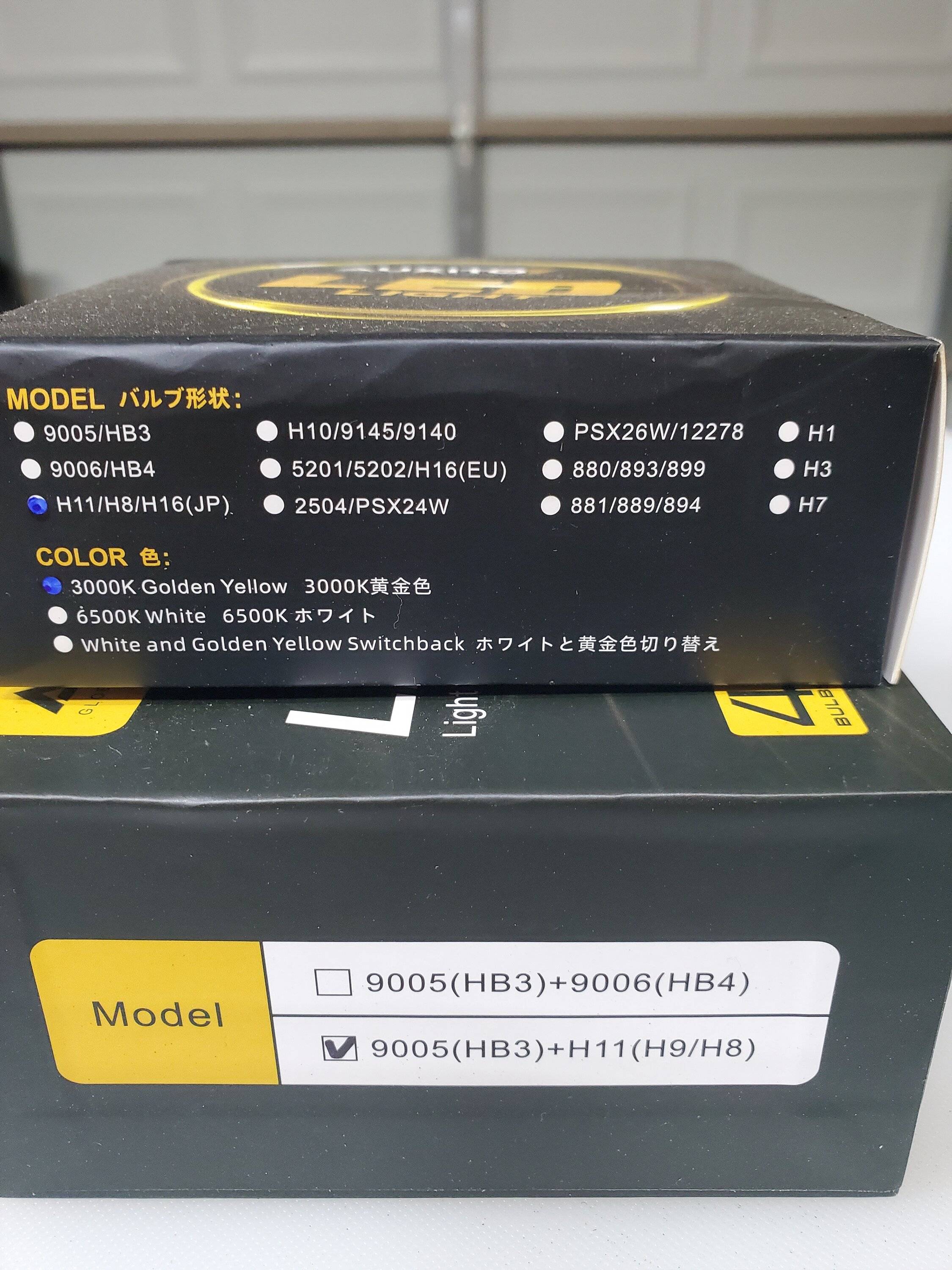

I have Auxitos in my lows, highs and fogs on my XLT and absolutely love them. Night and day difference (literally) and I don't get flashed.
I went the same route (12K Lumens), but chose yellow fogs - 8K lumens. The cutoff is very clear and distinct in both low and high beam... even the fogs had a sharp cutoff. I lowered the beam in both to meet spec. I did this by simply placing painters tape on the wall before beginning the replacement to mark the beam location of the original bulbs. No one flashes me at all. Auxito did a very good job on these LEDs. I noticed that the filament and LEDs were exactly the same distance from the seat of the bulbs. Even the fogs had a clear cutoff line.
Wife even drove out, turned around and met me head on on a dark 2 lane rural road. No complaints about excess scatter. Her words were that "they were no brighter than other modern cars".
I was so impressed with the outcome in the 2020 Ranger I tried the H7 LEDs in my 2005 Ranger... not impressed! No clear delineation and much too much scatter. Back to standard bulbs in the 2005 Ranger. Testing these horrible LEDS got me flashed constantly... and deservedly so.
