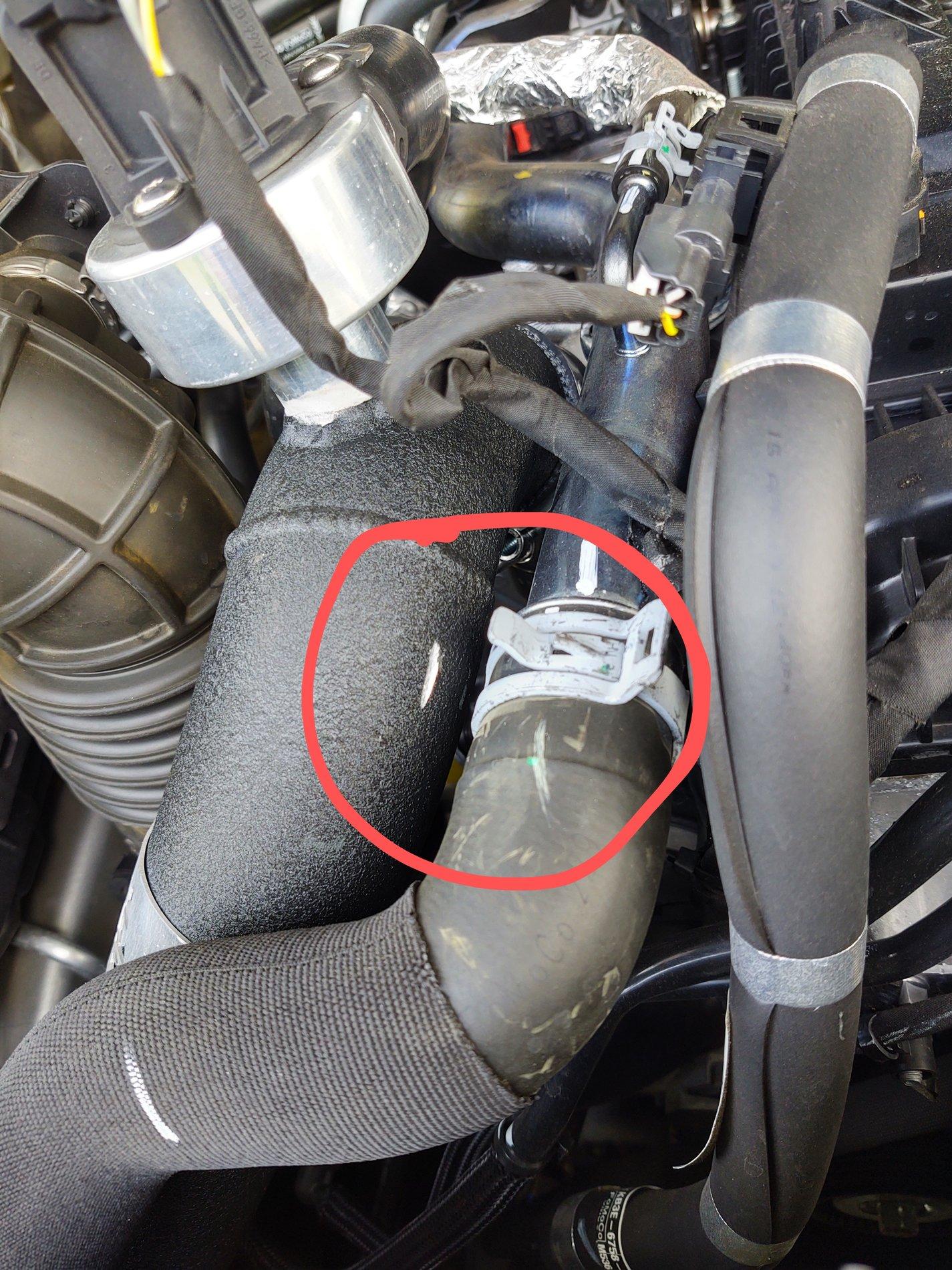

So I installed mine the other day. Be sure to lube the o rings with some vasaline. They will catch n tare if your not lubed n careful.... (Insert tearing o-ring butthole joke here)
It took an hour tops. Just make sure you tighten everything nice. Oh and the hot pipe I found was rubbing on come coolant line clamp. Might wanna twist the clamp 45° so it doesn't rub through the aluminum thin pipe. Pic to follow

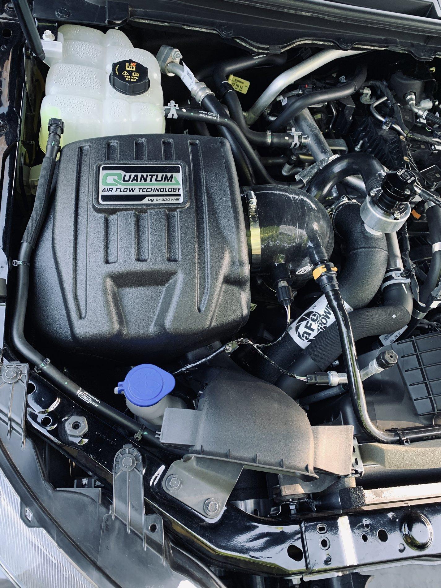

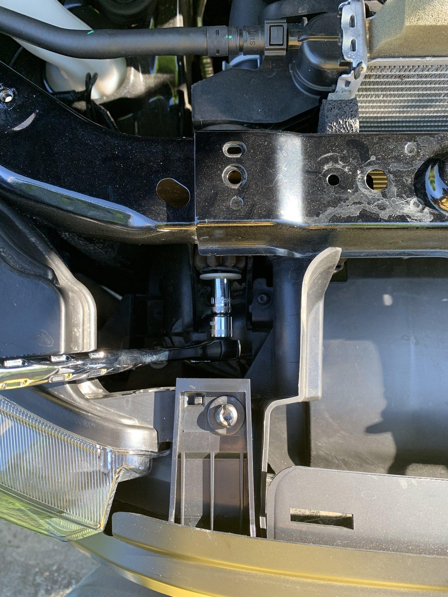

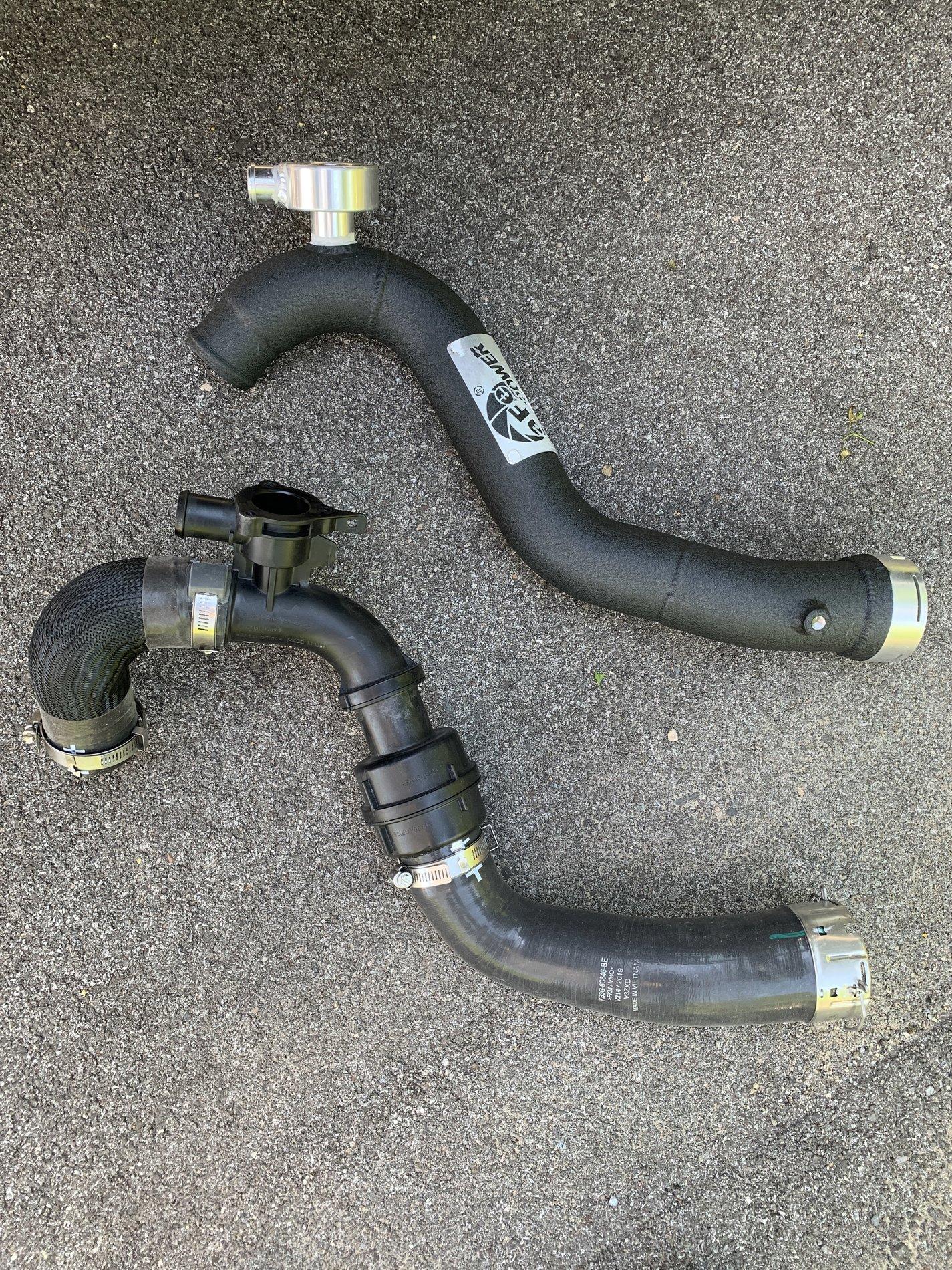

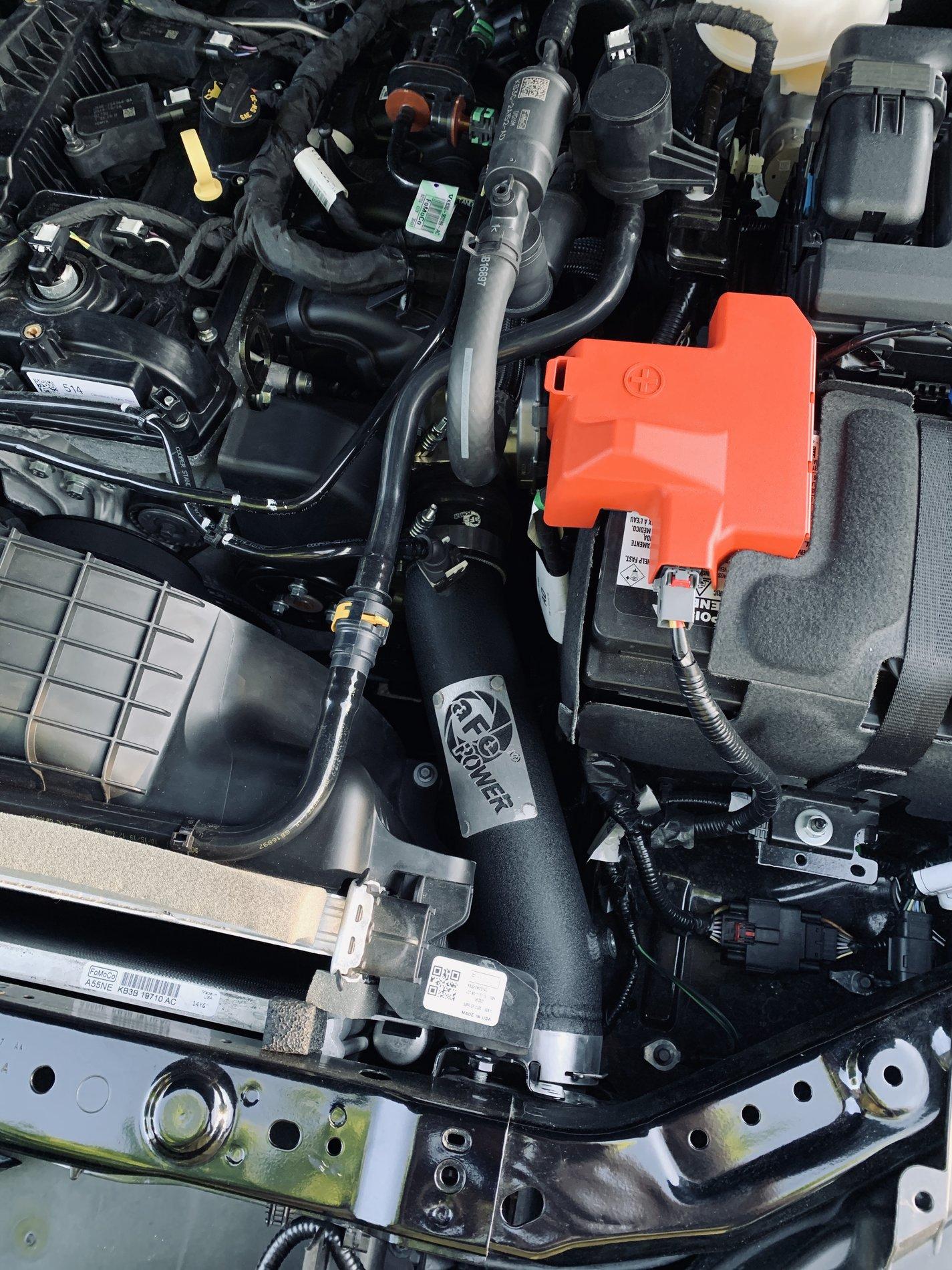

I finally got some pictures off my phone from my install. Overall, not a super hard install, but it definitely took some maneuvering and elbow grease. One huge piece of advice came from this Youtube video, which recommends loosening the intercooler bolts for a bit more clearance. The first picture below shows my ratchet on the passenger side bolt:
Here are some finished product shots and the hot side tube comparison:

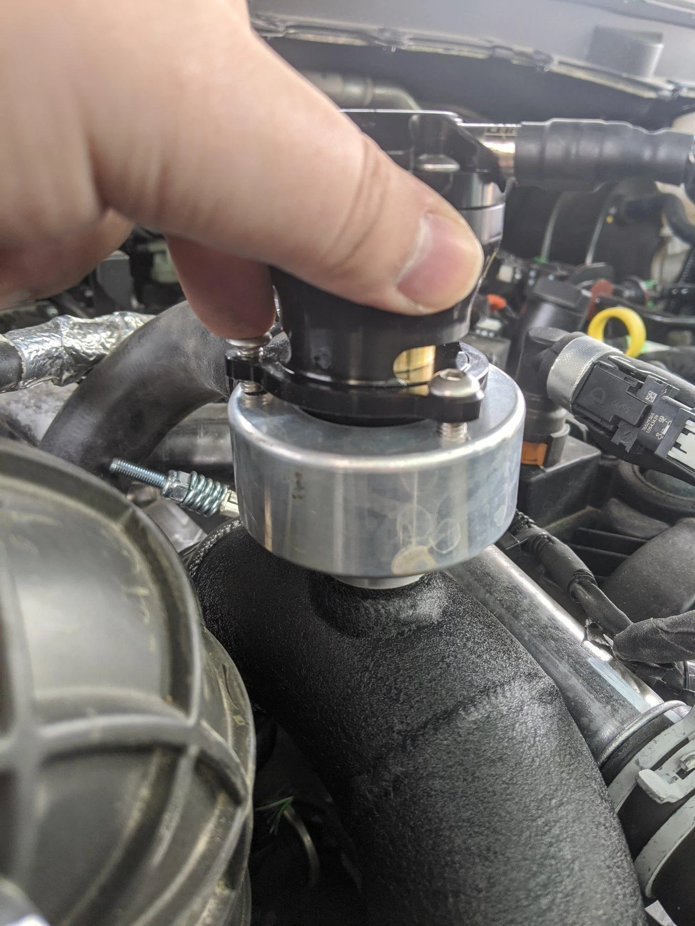

I have a Turbosmart BOV installed as well and I do notice that it touches the hood lining. I have only driven the truck <1,000 miles since install so I have not observed and wear, but it may over time.
