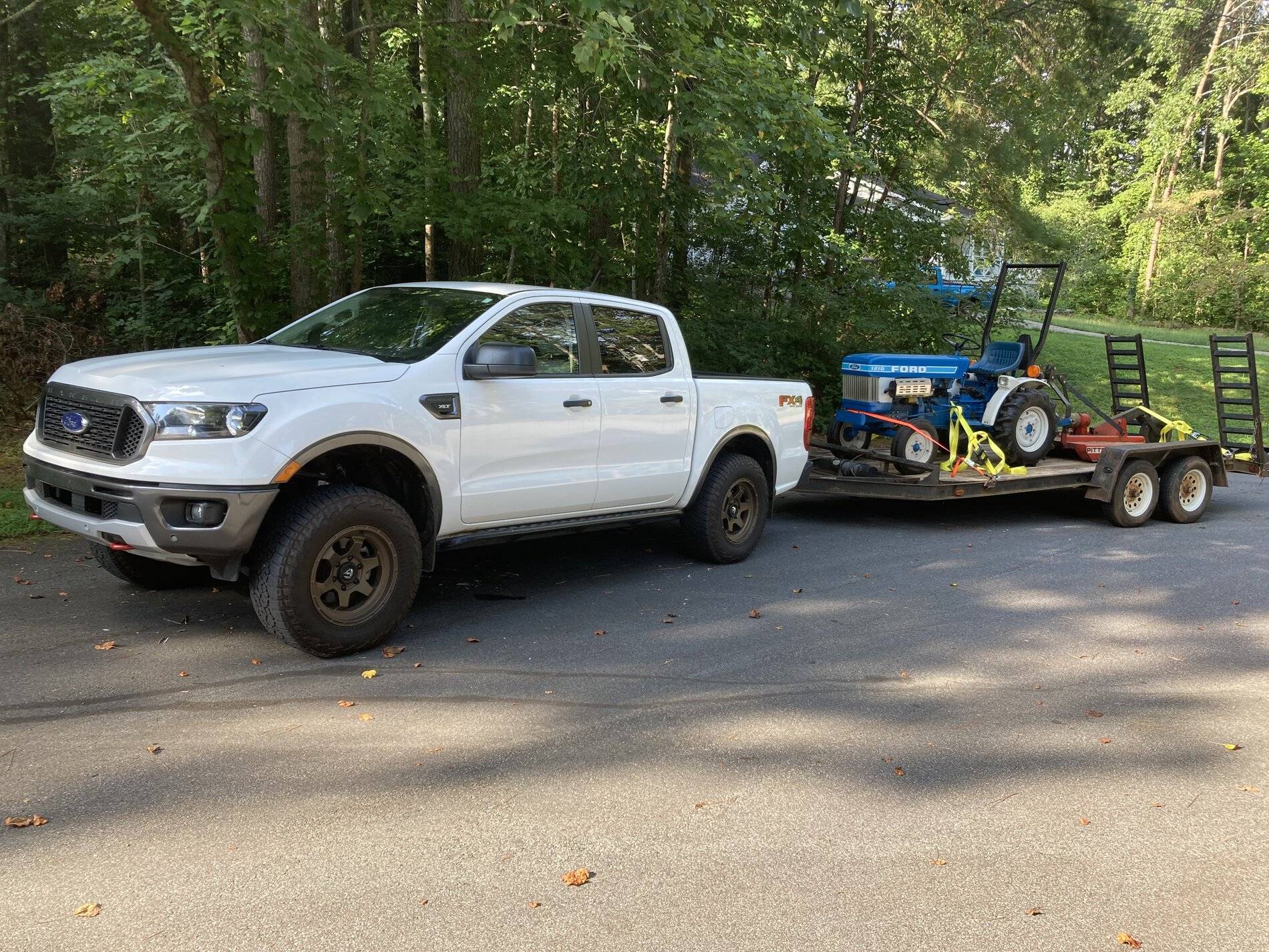

So my first real bit of towing today, even though it was well below the Ranger rated max.
I'm gonna guess around 4.5k lbs total.
Handled it with Zero effort.
Up hills, down hills, never lacking for power.
I've towed this same setup with my Bronco and my old Frontier before.
The Ranger readily thumps them both.
Hey Ford, :like:

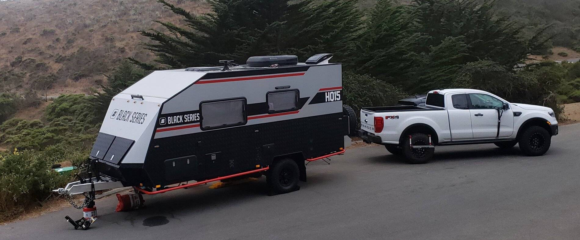

I guess I took Ford at their word that the truck can tow 7500 lbs and proceeded accordingly.
We are towing a Black Series HQ15, which is 4,700 lb dry, ~ 5,500 wet, with the truck coming in just a bit over 5,000 lb (after market suspension, sliders, larger tires, front bumper, winch, limited crap in the back). I am definitely using a WDH on highway and have AirLift airbags running around 50 lbs each. (for the nanny-state snowflakes that can't resist trying to shame me - this combo is 73.3% of max tow and 88.3% of max combined weight ratings).
So far it tows really great! We're not tearing up the interstates at 80, but 60 mph is more or less doable all day long on anything except the steepest grades. The 10 speed and turbo are amazing. Fuel mileage sucks at around 10 mpg, but is within tolerance for a gasser (I have generally experienced 8-12 with trailers this size on gas engines), especially considering the increased ride height of both truck and trailer.
Only about 1,000 miles so far and only a few steep ascents/descents (Donner on 80, doesn't really count; Altamont on 580, which is a decent climb; and the road out to Usal Beach, which is also dirt and was steep enough to get us to air down and pop into 4H). We've been through some pretty gusty (am guessing 40 mph, more or less) side winds and while I sometimes feel a push it's nowhere near white knuckle territory and the truck continues centered in the lane.
Some of this is the trailer, with independent trailing arm suspension and 20,000 lb hitch, designed for off-road action, but so far the truck is doing everything asked without complaint.
To be honest, I didn't buy this truck intending to tow this trailer, and I might switch out to a different truck in a few years or if I blow this one up.
Anyway, here's a pic:
(yes, I know the truck is behind the trailer and facing the wrong direction ;-) )

I have the same trailer. What suspension did you go with on your ranger? Also WDH?

It looks like you have a bit too much tongue weight as the back is squating, might want to load that equipment further to the rear on the trailer. I do love the fact that the bush hog is also a Ford :)

You may be correct but at the same time it is also the result of leveling a truck vs lifting a truck!! The one thing I mention on here and people dont want to understand!! Lol

When you have the proper amount of tongue weight the back of the truck is going to squat a little bit, this also makes it tow very nicely with no fishtailing. Looks good to me.
Yes we’re gonna need that lift versus level thing explained. When you “Level” your truck you are also “lifting” the truck lol.

Sorry couldn't stop myself :) Hauled many a trailer across the country, and yes it you level the front it takes out the OEM 'rake' that compensates a bit for rear end squat. The main issue with that rear droop is in an emergency stop situation, forward force of the trailer is not lateral to the truck, forcing the rear down, thus lifting weight off of the front wheels, and may cause you to lose traction and steering control. This is a worst case senerio but I have seen it. Just my OCD kicking in I guess.

Well lets see here.... When a truck comes to the dealer from the factory is has rake(the enemy of most of you LOL). A leveling kit takes the rake away. What happens when you do that? Well of course its level but what happens when you load it? The front becomes higher and causes problems like not as much traction on the front tires, headlights not hitting the road like they need to be, and also make it where you may not see the road since you now noeed to look over the hood.
A proper lift(as in it keeps the rake) will not have this problem near as much. Also when loaded it doesnt look stupid. Look at exhibit A for a great example of a truck with a lift that also has a load!!
