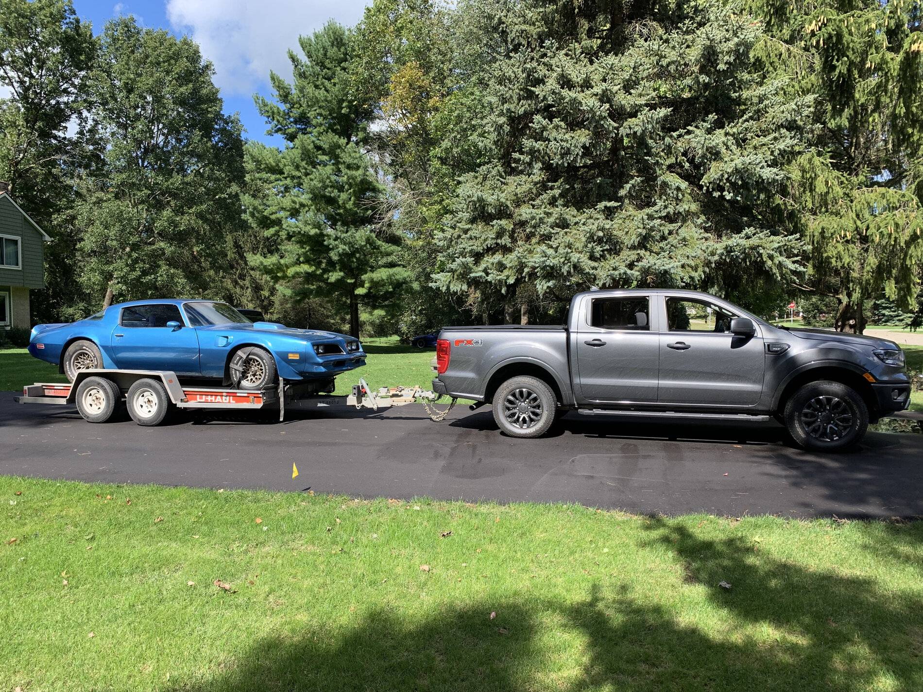

I just got home from a 12 hour tow from Michigan to Connecticut on I-80 (big honking hills in PA). I had the cruise control at 71 the majority of the time and it never faltered, never lost speed and I had the AC on a lot of the time. Fantastic tow vehicle!
