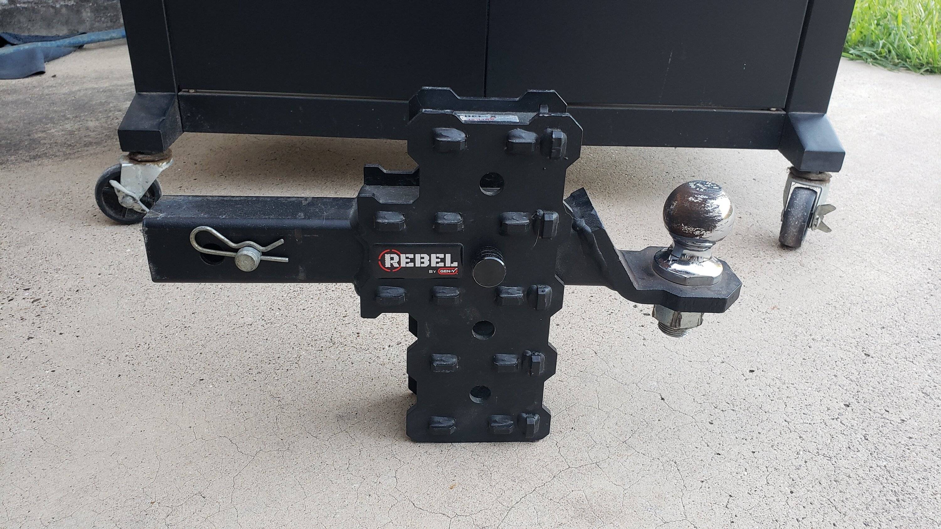

I dont tow tt's. Cargo trailers below 3500 and flat beds with small backhoes and stuff. Cars too. 5 to 7k. No wdh. Don't need one for my purposes.
Just make sure to use a
GEN-Y REBEL
adjustable hitch

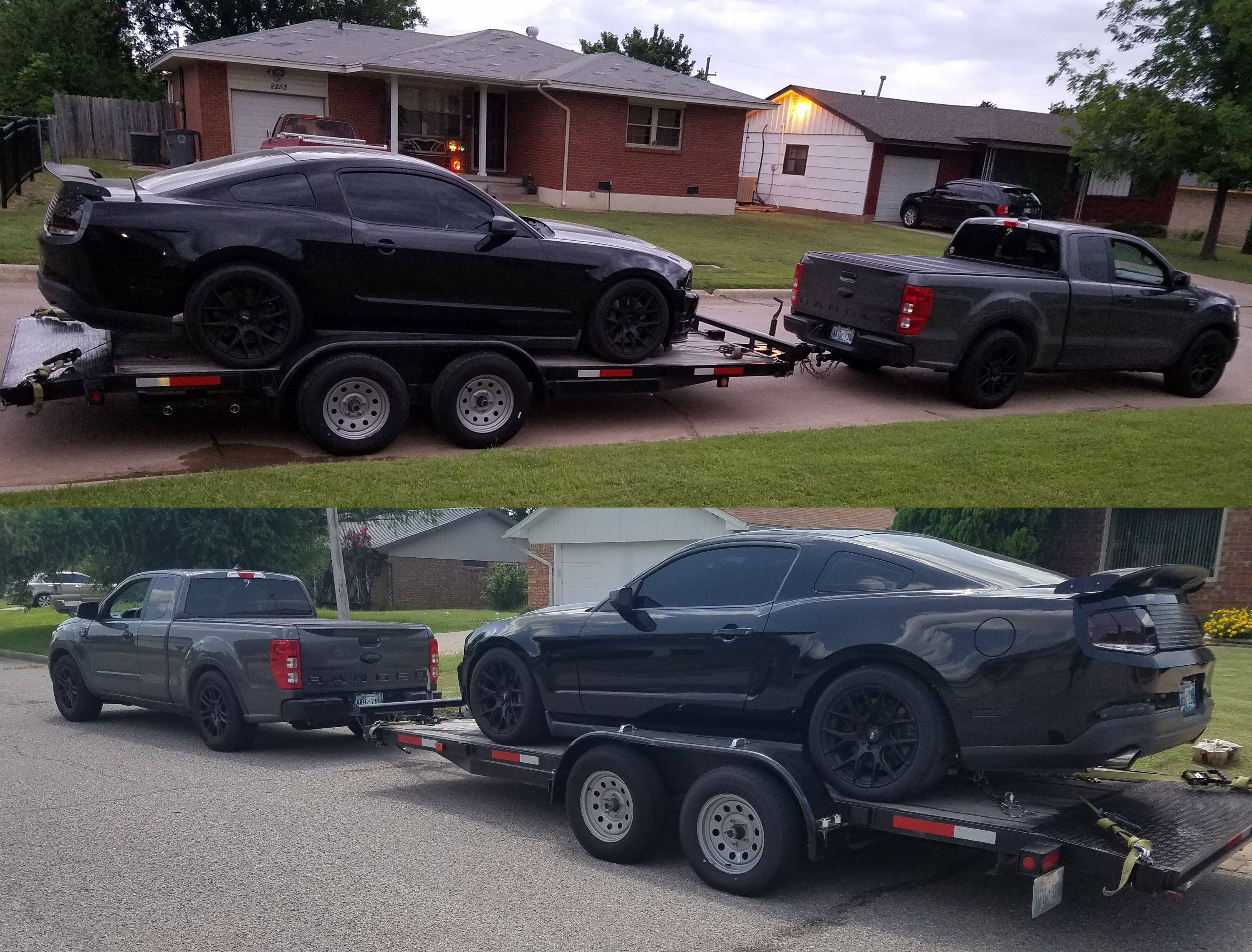

I've pulled the same trailer both with WDH w' friction sway and without with bags. The behind the wheel experience for me was pretty much identical, So I've switch to a normal hitch setup with bags. 5300# trailer with around 600# tongue weight. Top pic is bags, bottom is the WDH.
