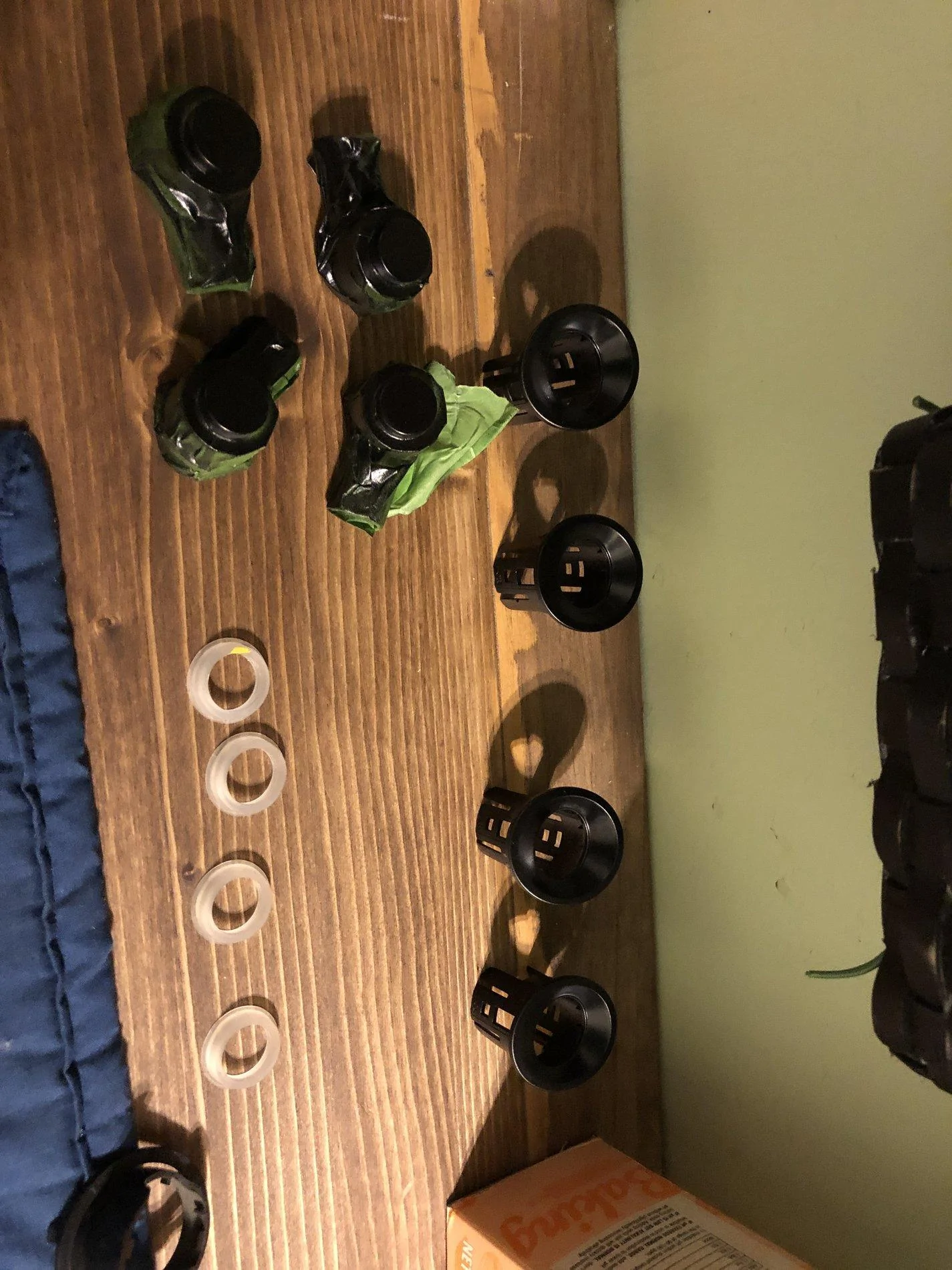

Time to paint parking sensors black to match the new bumper.

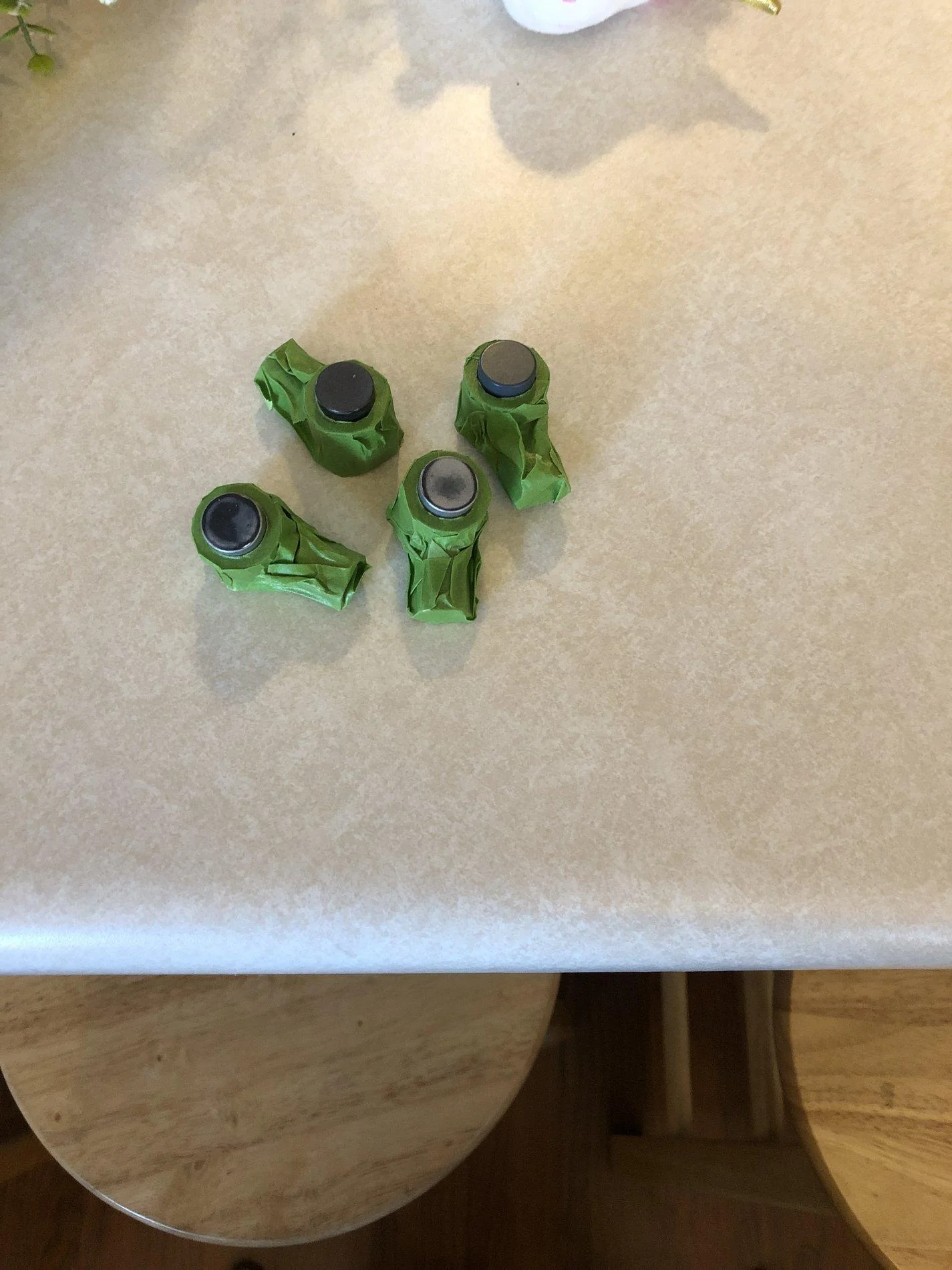

What type of paint are you using? Will the paint choice affect the sensor at all? I'm drawing up my front bumper plans now and want to include the sensors, which I want to paint black also.
I used krylon fusion satin black. I sanded as much of the original paint off as I could. Two light coats of it and they turned out great and function normally.

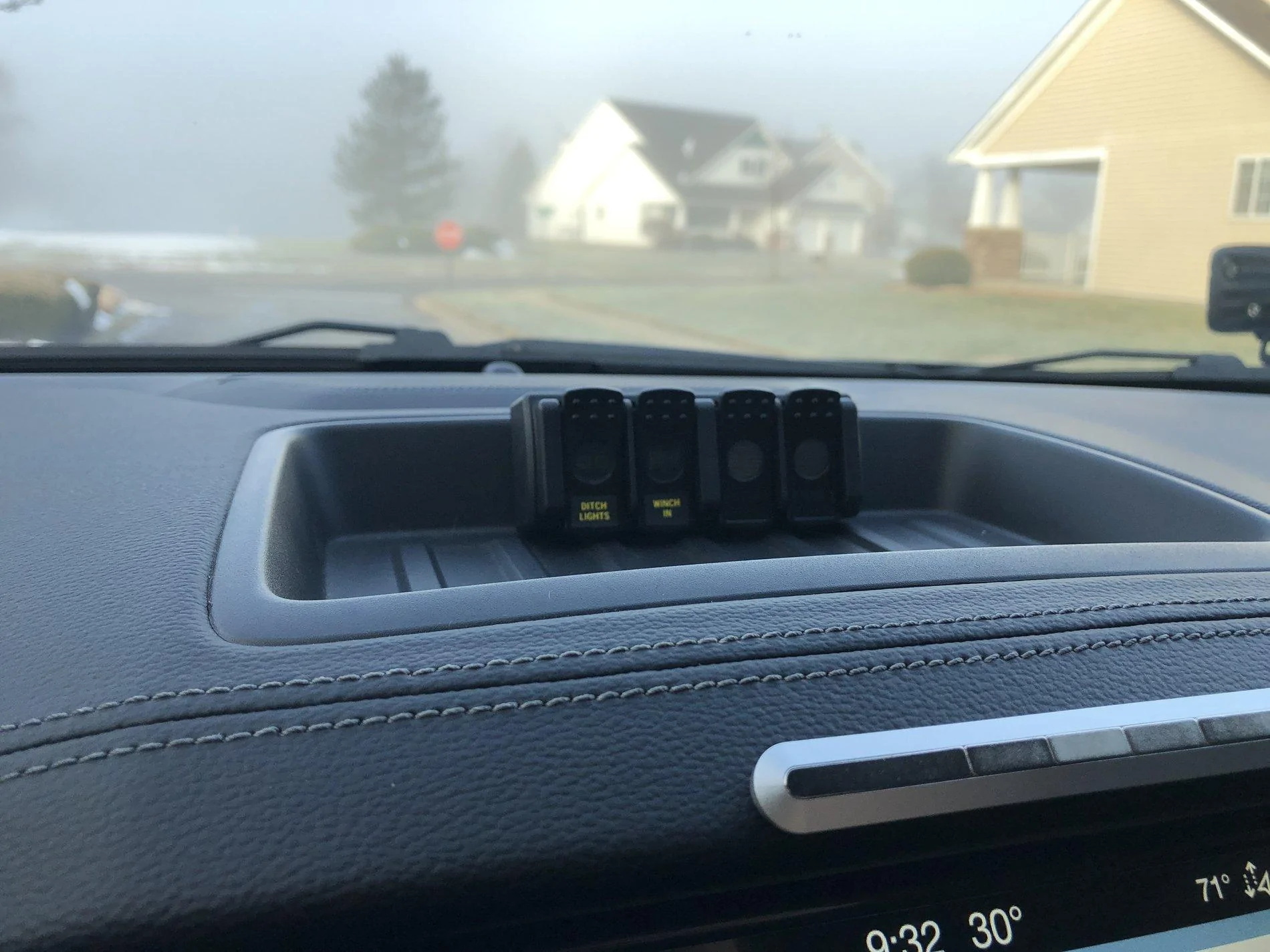

Got the Fab Fours ACC relocation put on. Works great so far. Also got my trigger switches mounted finally.
My first set of switches constantly malfunctioned. Sent them back for a new set. Don't like leaving things in the sun so modified the tray and mounted it flat in front of the shifter and tray. They offer a flat tray also after I busted their chops about the jeep roll bar attaching and not catering to the rest of the market.
Nice truck! Nice work!
Oh that’s good to know. I’ll hit them up. Agreed, no clue why they send the roll bar base with the universal trigger models. If we had jeeps we’d order the Jeep kit.
I asked them.... Because they are a small company and Jeep was their first investment. I said, "Fine, but if you want to be a big company someday, expand your web site so it looks like you support all vehicles"....

BTW, you can carefully pry off the rounded base they give you and grind down the screw posts. Also a wasted effort on their part. The metal plate does not need to be screwed in. Simple silicone or a glue is all it needed. If you do that, be careful. The top tray piece is wimpy. But you really need the rim to hold the switches in place. Fill up the bottom with epoxy.

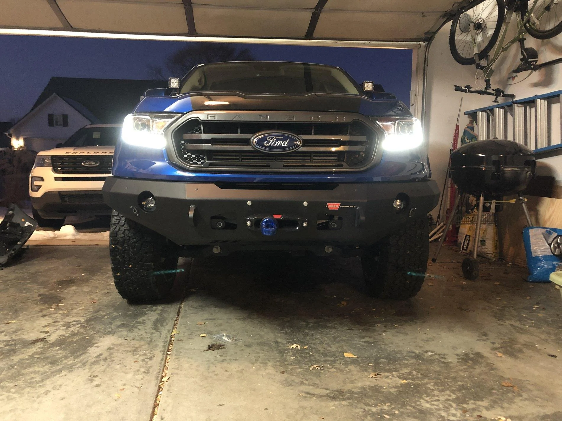

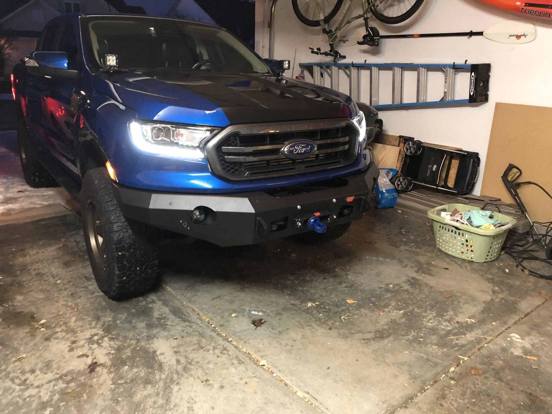

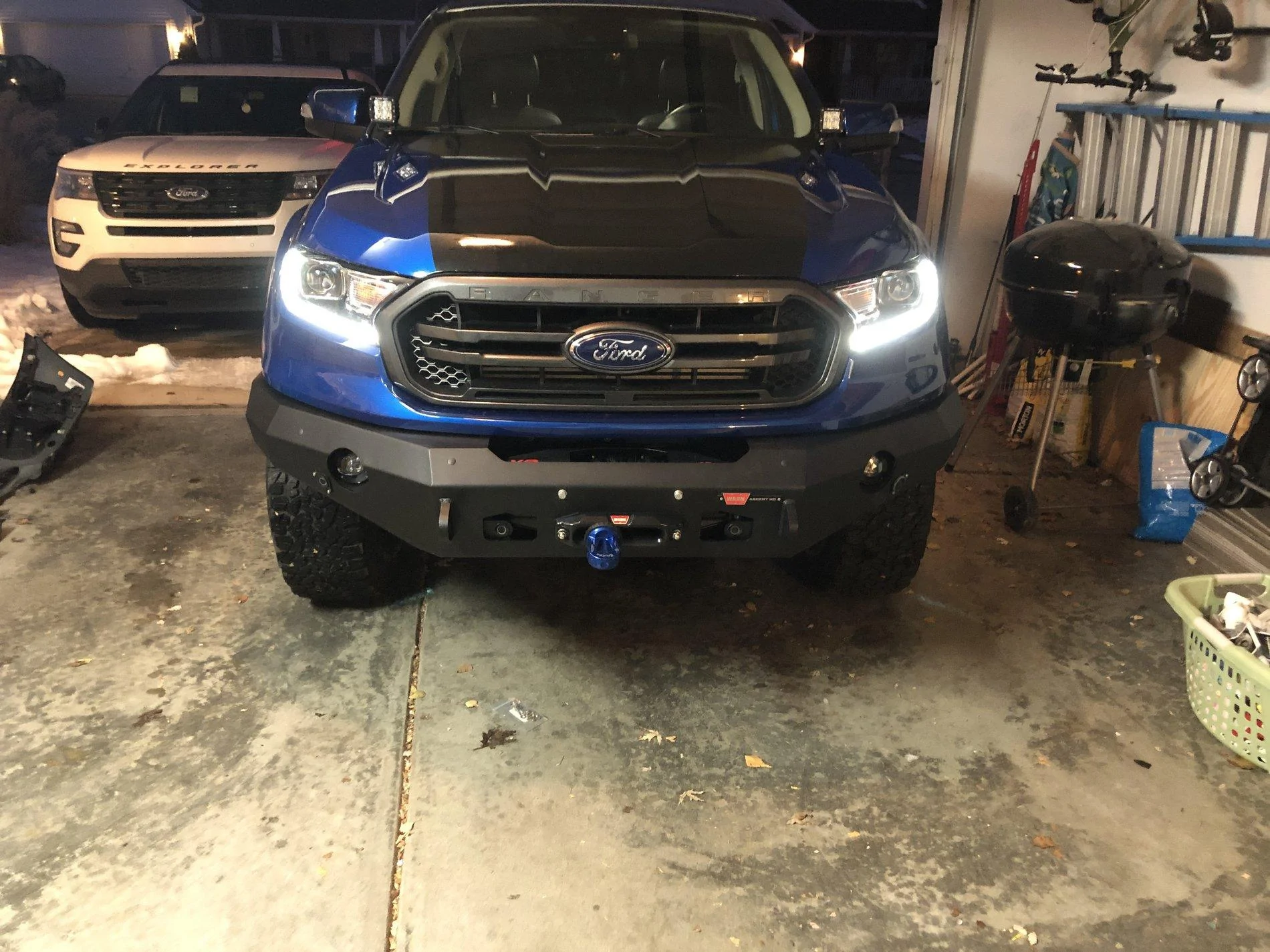

Thanks for the kind words!
So yes, the ride changed a tad with the bumper and winch. The front end felt a tad bouncier. With that, I did also lose around 3/8ā€ on the front height. At that point, the coilovers were set at 2.5ā€ of lift (with stock bumper of course). I spoke to Icon and they said that the extra weight on the front end would help negate any reduction in ride quality by adjusting the coilovers beyond 2.5ā€ and moving closer to the max 3.5ā€ they allow. As such, I adjusted the coilovers another 1/2ā€, or four full turns on the collars. Without the extra weight on the front end, ride quality would’ve suffered when going up more than 2.5ā€ but Icon was absolutely right, adding another 1/2ā€ with the extra weight on the front returned the ride quality, less bounce in the front end, and got me back up to the original height. In the end, the ride now feels just like it did before the bumper and winch were installed.
On the sensors, the mounting points are there for the parking sensors. It seems another member has found that a roller fairlead causes sensor interference but my hawse fairlead doesn’t cause any interference and they function perfectly just as stock.
There is not a place to mount the Adaptive Cruise sensor on this bumper. I purchased the bracket from Fab Fours for $99 and loved it up to the grill. It has worked great so far in that location and the bracket does allow tilt adjustment to the sensor.
