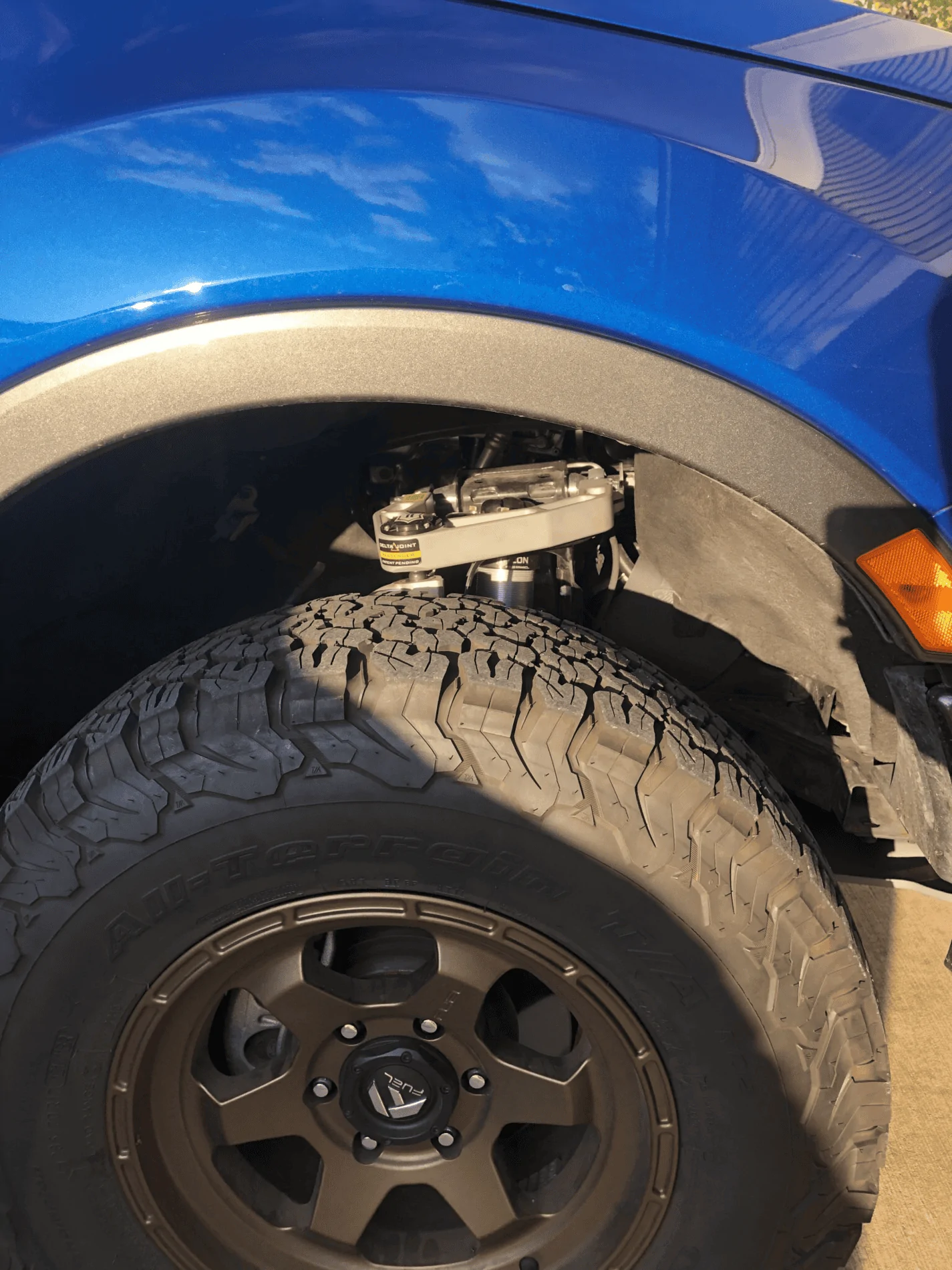

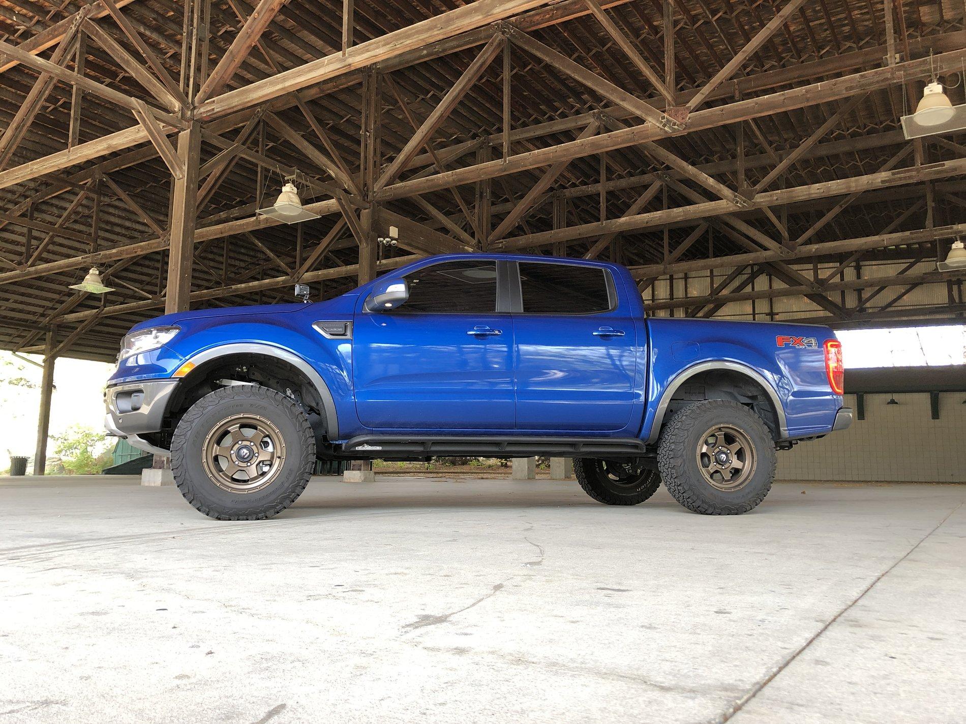

Do you think the Icon can reach the full 3.5" they advertise?
HoosierT
HoosierT
Tyler
Feb 1, 2019
958
1,559
Fishers, IN
Excellent build, brother!
Yes I’m pretty sure you can based on where the collars are on my coilovers set at 2.5”. But from what I’ve read, compressing the springs that much will cause horrible ride quality and coil binding. Seems there are two options if you want more than 2.5” up front: put heavier spring on the icons, or supplement them with a top spacer.

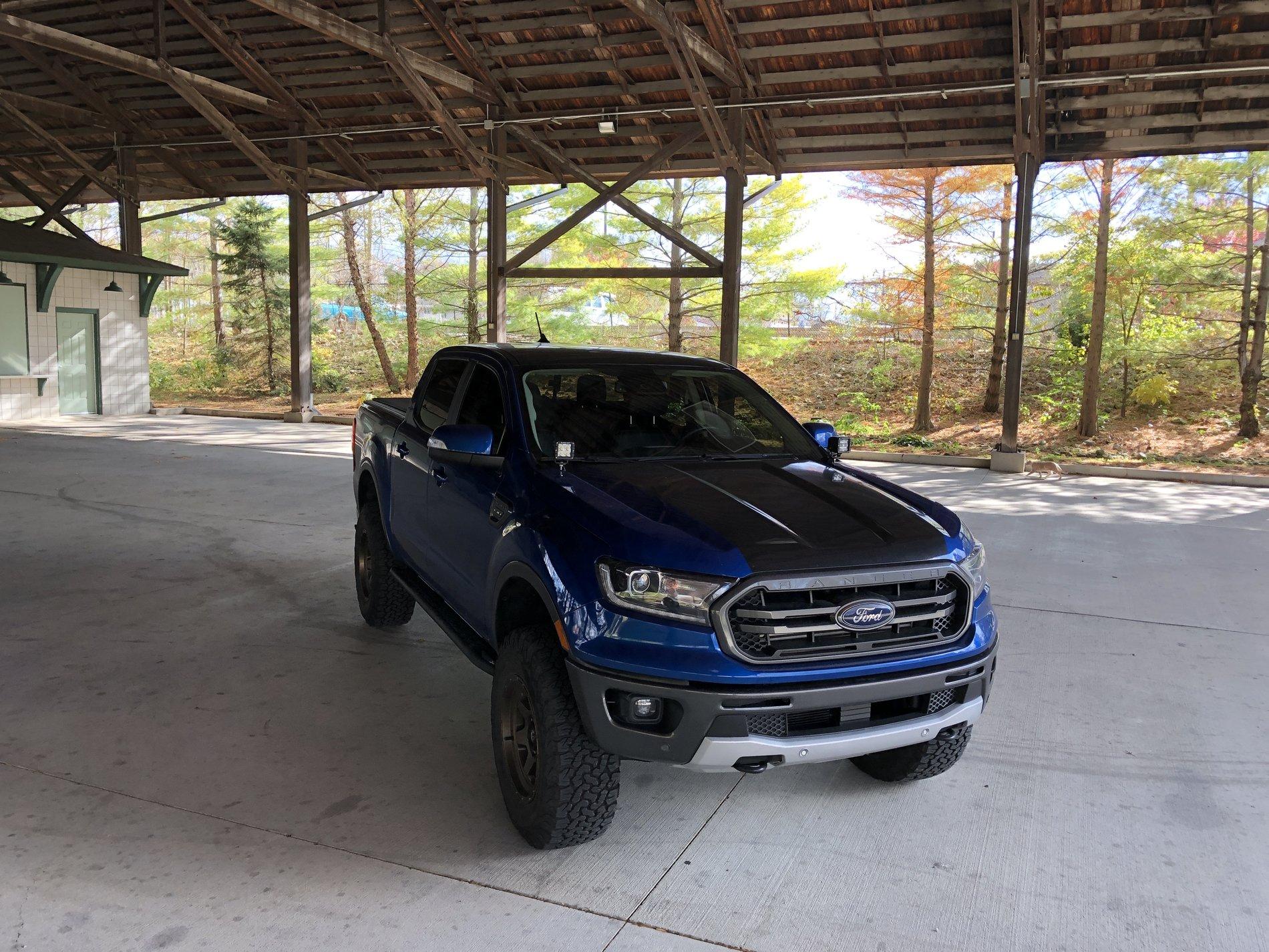

Adding a few more photos

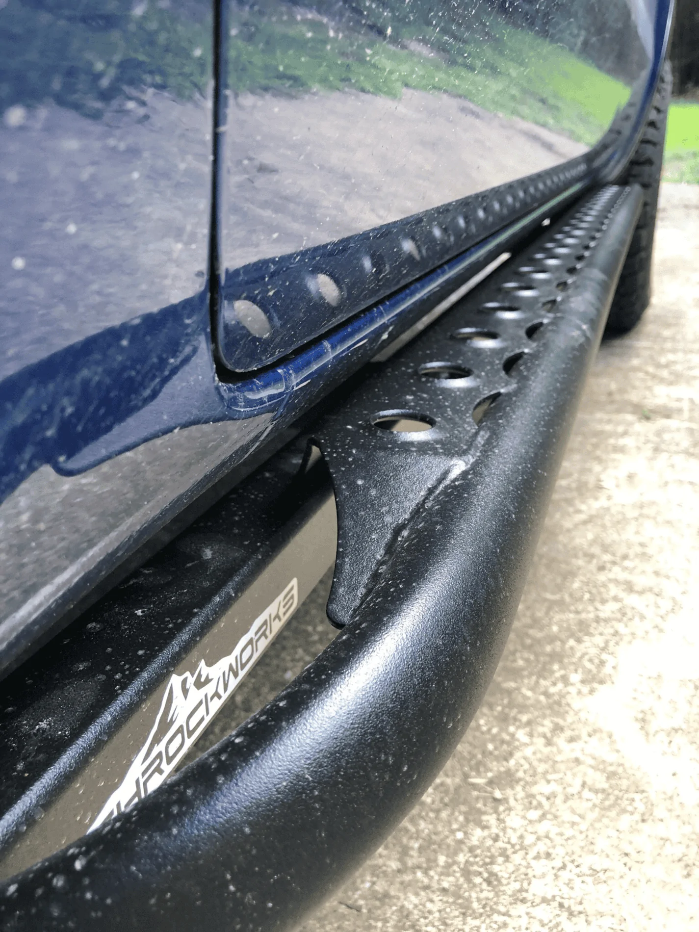

Are these the textured powder coated sliders? If so I'm definitely going with these. I just don't want ones that are overly textured like bed liner material. Definitely like your taste a lot! Sweet build! :rockon:
HoosierT
HoosierT
Tyler
Feb 1, 2019
958
1,559
Fishers, IN
Yes sir those are indeed the textured powder coat. Perfect balance of grip and look imo. Thanks for the kind words! I’m just after a clean and very functional build. Very happy with the results so far.
