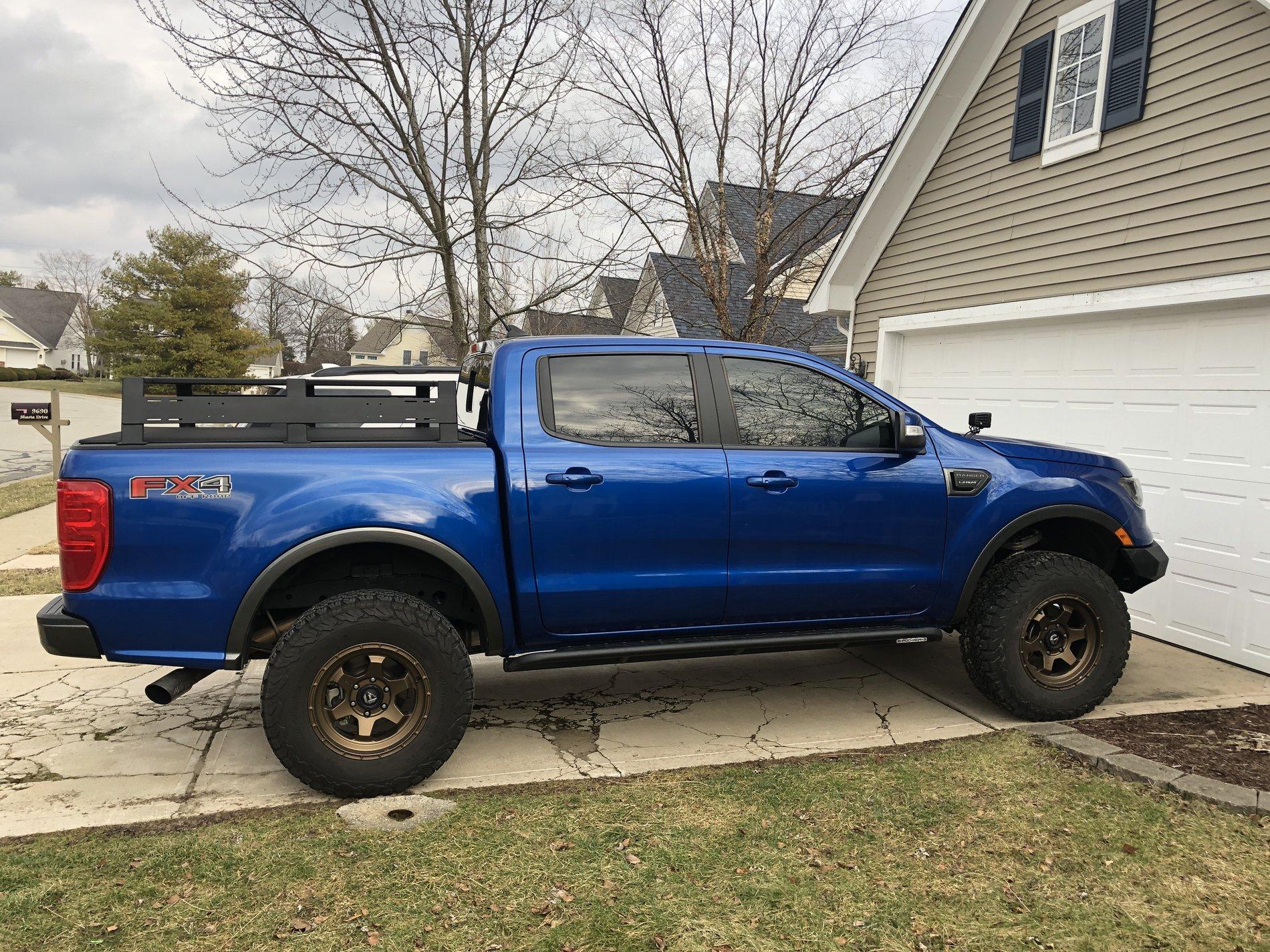

Finally got the rack painted and put on. Only slightly intimidating drilling six holes through my bed rails but it’s done.

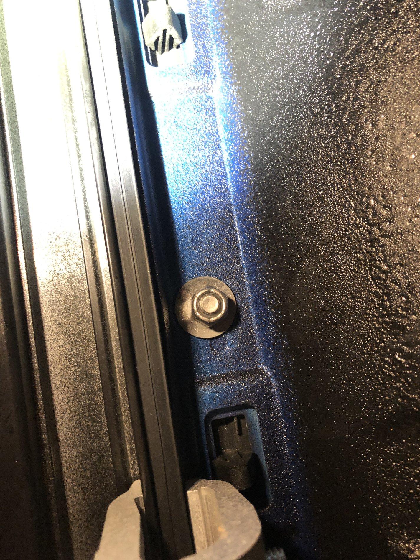

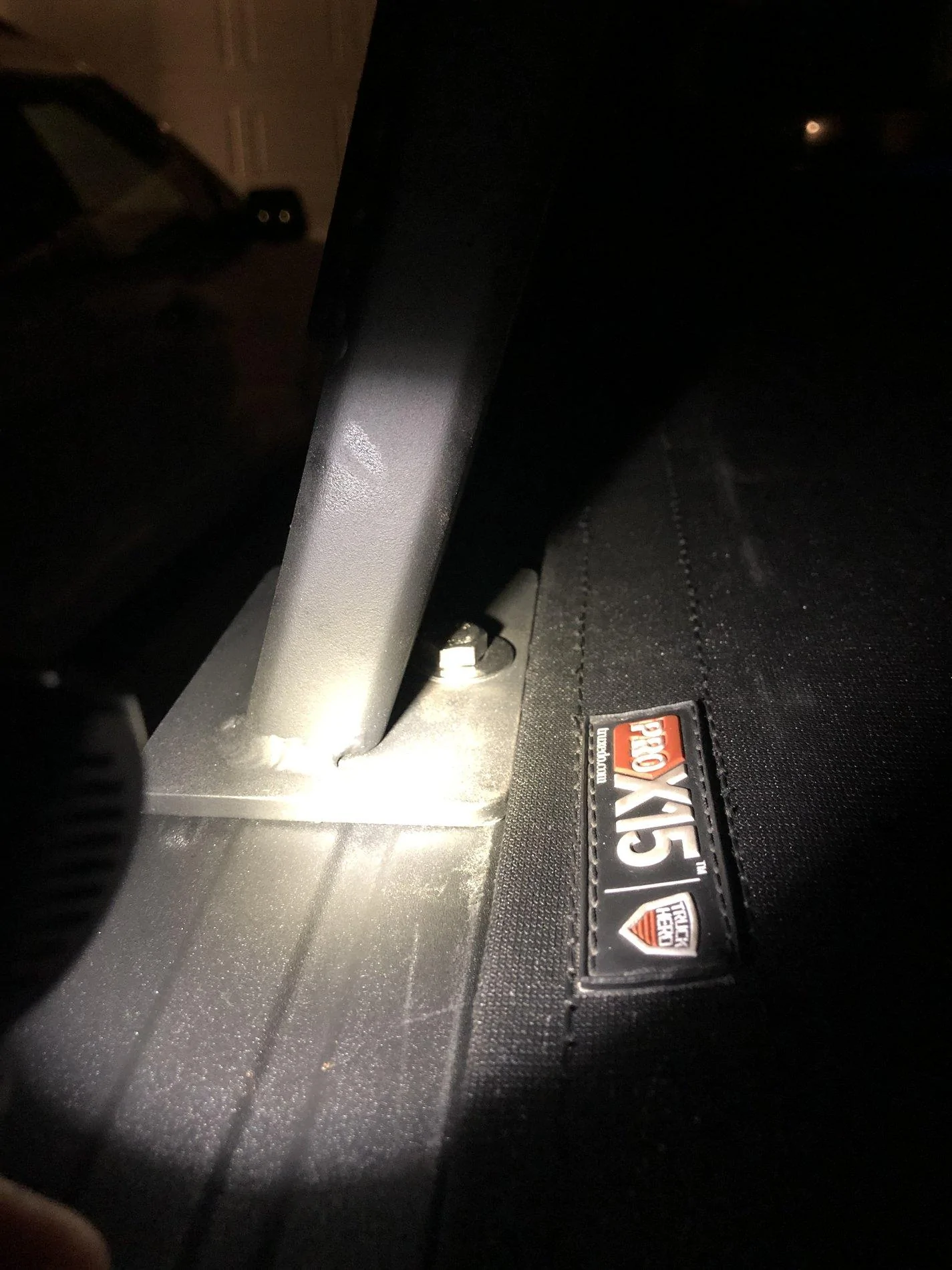

It’s dark but I grabbed a pic of both the top and bottom. You’ll see that if I use a bar and drill my own holes off center, I can actually go a tad wider than what the washers allowed.

Hi Tyler,
Great! Looks good...the aluminum plate will be better but you have done a great job in thinking ahead!:thumbsup:
