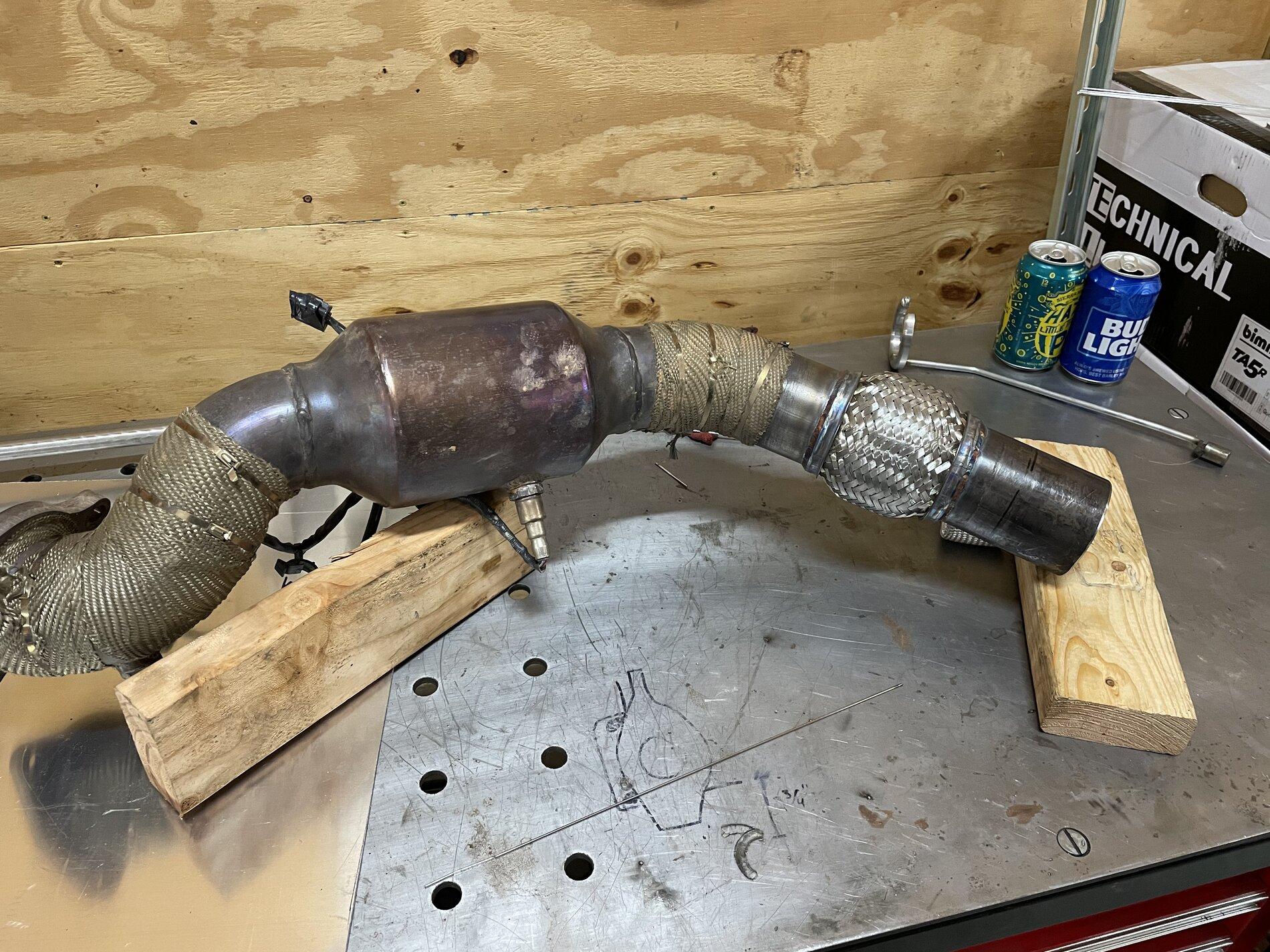

Nice! did you change anything else besides the down pipe?
I’ve modified the overall exhaust a bit. Added a small resonator to the MBRP 3”, cut the 2.5” reduced section out of the beginning of the MBRP for full 3” and replaced that with a flex pipe that’s welded to the actual downpipe. And of course the truck is tuned from 5star.
