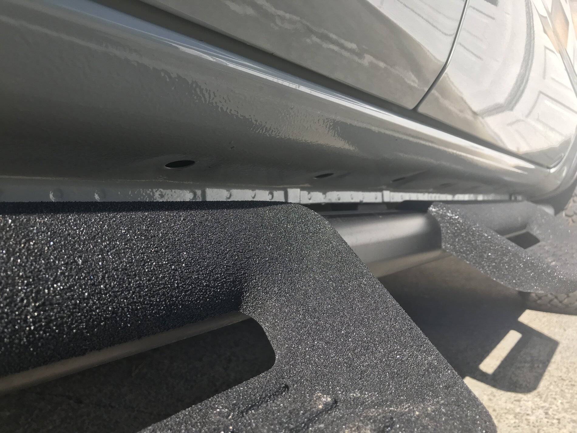

Do all 5G Rangers have these gaping holes on the rocker panels? Hard to believe these are the best design alternative when considering all factors.
Many contaminants and water are invited to enter here on my 2021... So weird, when compared to EVERY other vehicle I have seen or owned.
Would love to hear an explanation for these - that makes them seem right not wrong.
Hi Ben,
The holes and rubber plugs are part of the body assembly from what I can tell from the shop manual as access points for robotic welding. Being a chassis based, I am not familiar to the degree I would like in body assembly, but the even spacing looks designed for robotic access. JMO
2021 Tremor with unplugged holes. Just like the OP.

I'm curious why they're unplugged. Makes me leery about getting another Ford. I think mines going to go for sale this weekend.
JaysOnTheEDGE
Jay
Oct 17, 2019
805
1,489
Office Equipment Technician
looks like the plugs were deleted on all of the '21s just from skimming the posts. maybe supplier issues, or ford being cheap by not installing parts
