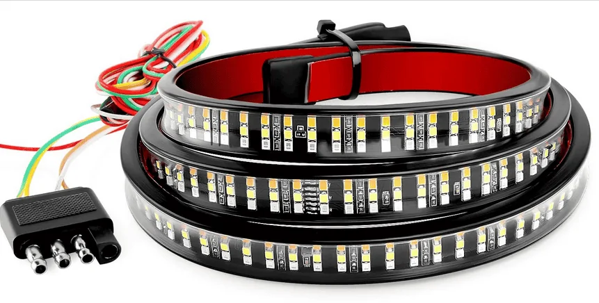

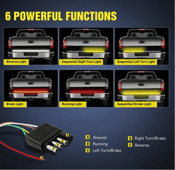

The part in question is this: Nilight TR-04 Truck Tailgate Bar 60" Triple Row 504 LED Strip with Red Brake White Reverse Sequential Amber Turning Signals Strobe Lights,2 Years Warranty
It connects to the Ranger with a 4 pin trailer wire and a fifth loose wire for reverse lights.
Since when do 4 pin harnesses not have a reverse light? I always thought that was part of the deal?
A - Ground, B - Left (turn / brake), C - Right (turn/brake) and then D was reverse. Did something change when we went with all digital LED lights?
Any way.... Here's my quandary.
How do you install this thing? According to the instructions I plug it in to my trailer light harness and leave this unsightly plug hanging out there. Then I hack the reverse wire somewhere and put the extra fifth wire on it.
1. I do not want to put in a cool light bar and then have a towing pigtail poking out under my tailgate.
2. I do not want to have to hack into a wire for reverse. It defies and defeats the purpose of waterproof plugs.
Is there a better way to install what I have? I don't mind purchasing an adapter that goes behind the bumper and hooks into a wiring harness. That's how I added trailer lights to my 93 ranger back in the day. Walmart sold it for like $10. You unhooked a harness from the main and then this add in harness sat between the main line and the rear harness. Worked out BEEEEE-YOOOO-tifully.
Or a different option. I've got $45 sunk into this light. Getting an adapter to make it work is probably another $20 to $40. Is there a Sub-$100 light kit that is as good / better than this one that installs easier? If so I can return this and just get that one.

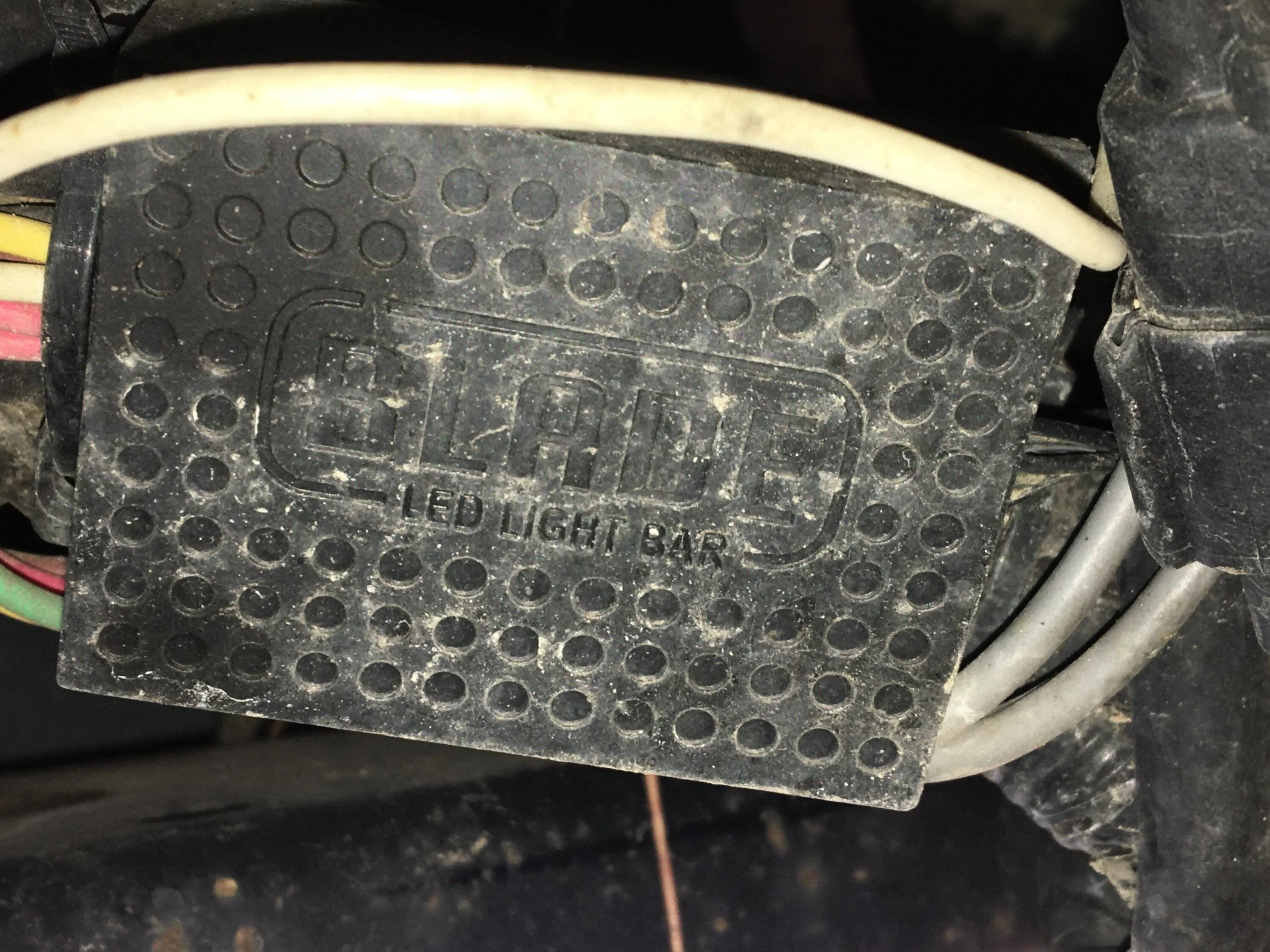

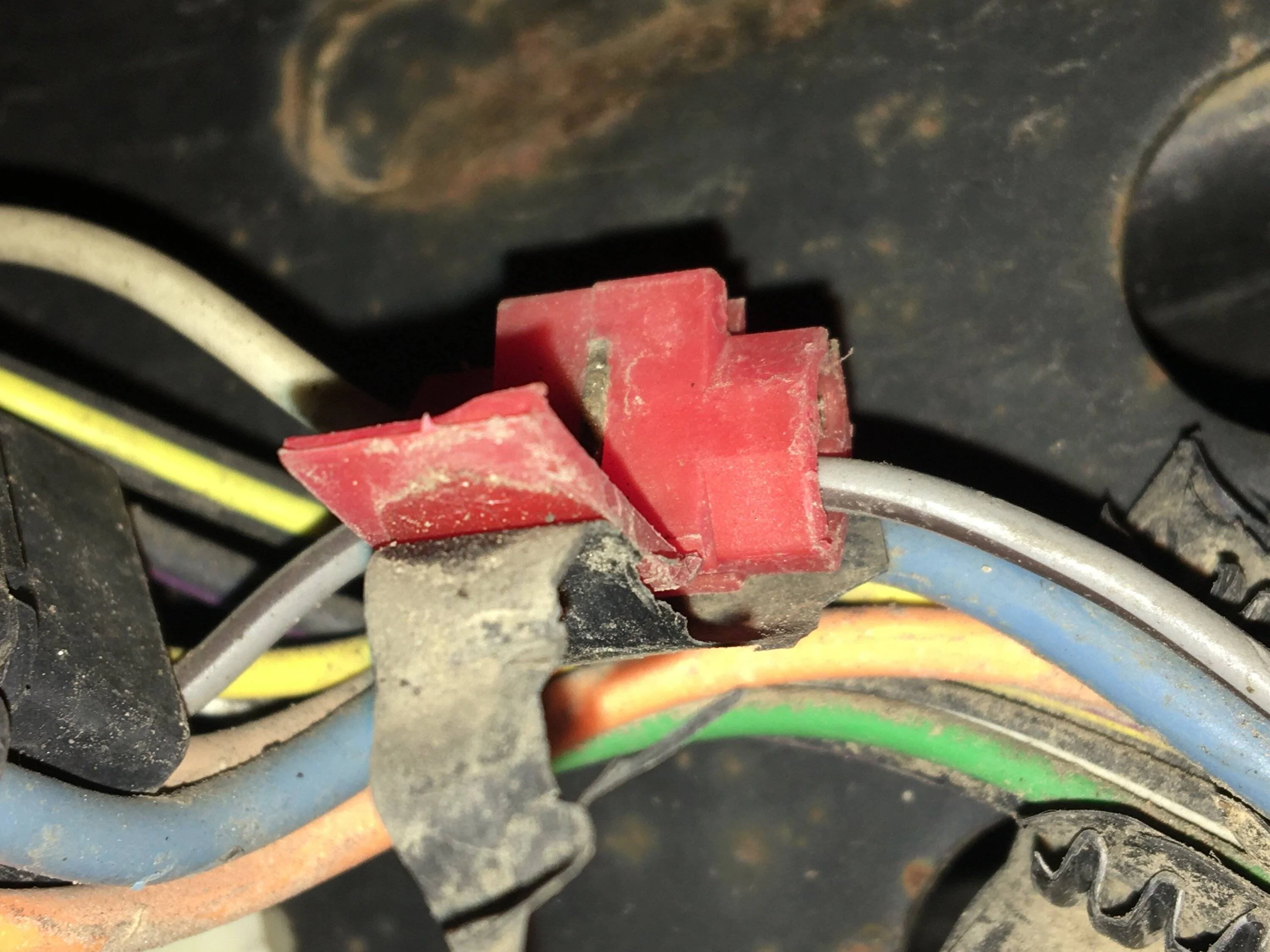

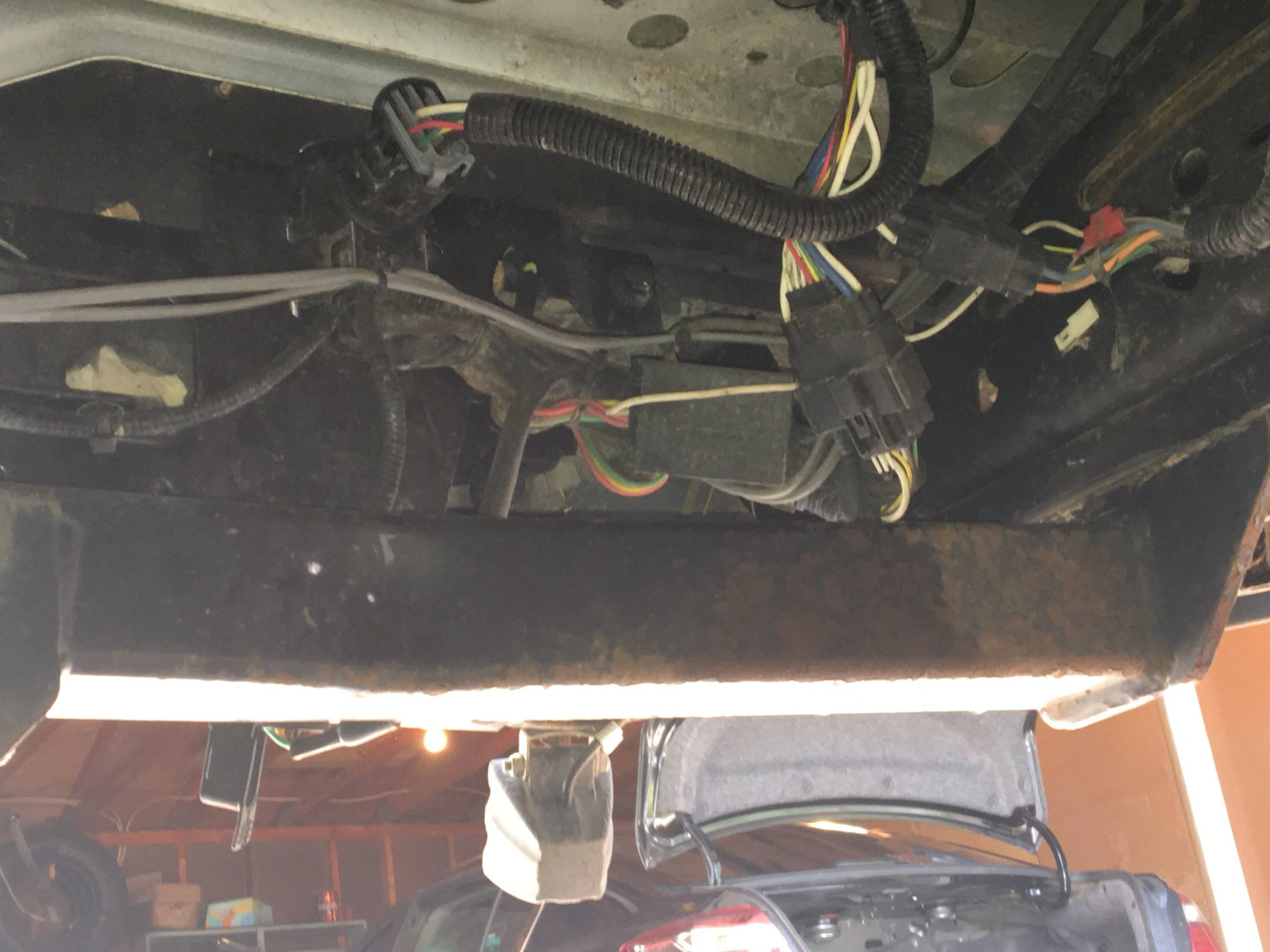

I didn’t want to pull it all apart but this is what I think is going on.
The black box is connected to the four way and the white wire is tapped into a grey and brown? wire from the truck harness. That must be the reverse.

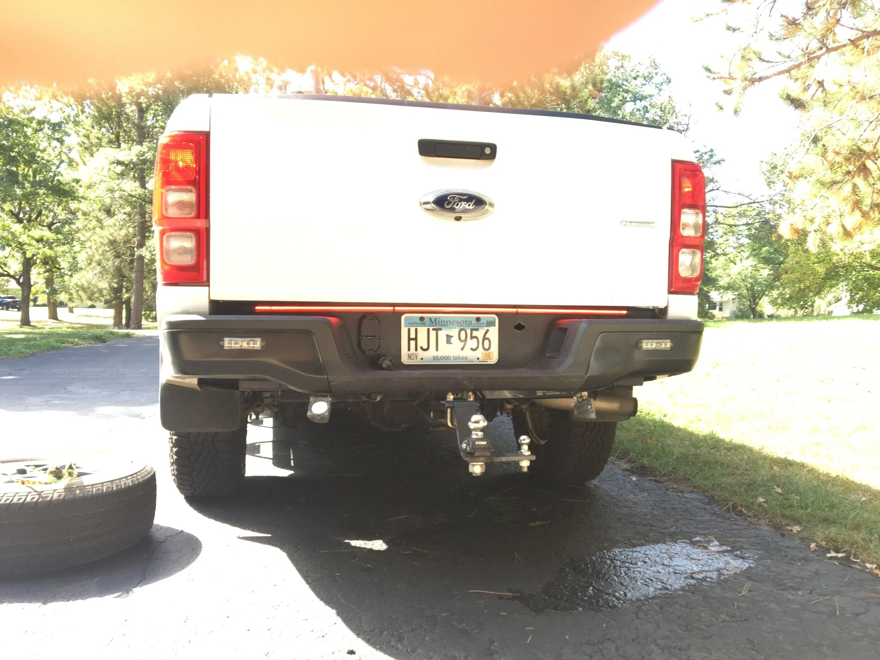

View from the rear, the 4 way plug doesn’t stand out too much but I’ve got a lot going on back there.
Excuse the potato quality photo and finger half over the camera. The sun was in my face and a wasp was after me. lol
Does yours think the truck is towing a trailer all the time?

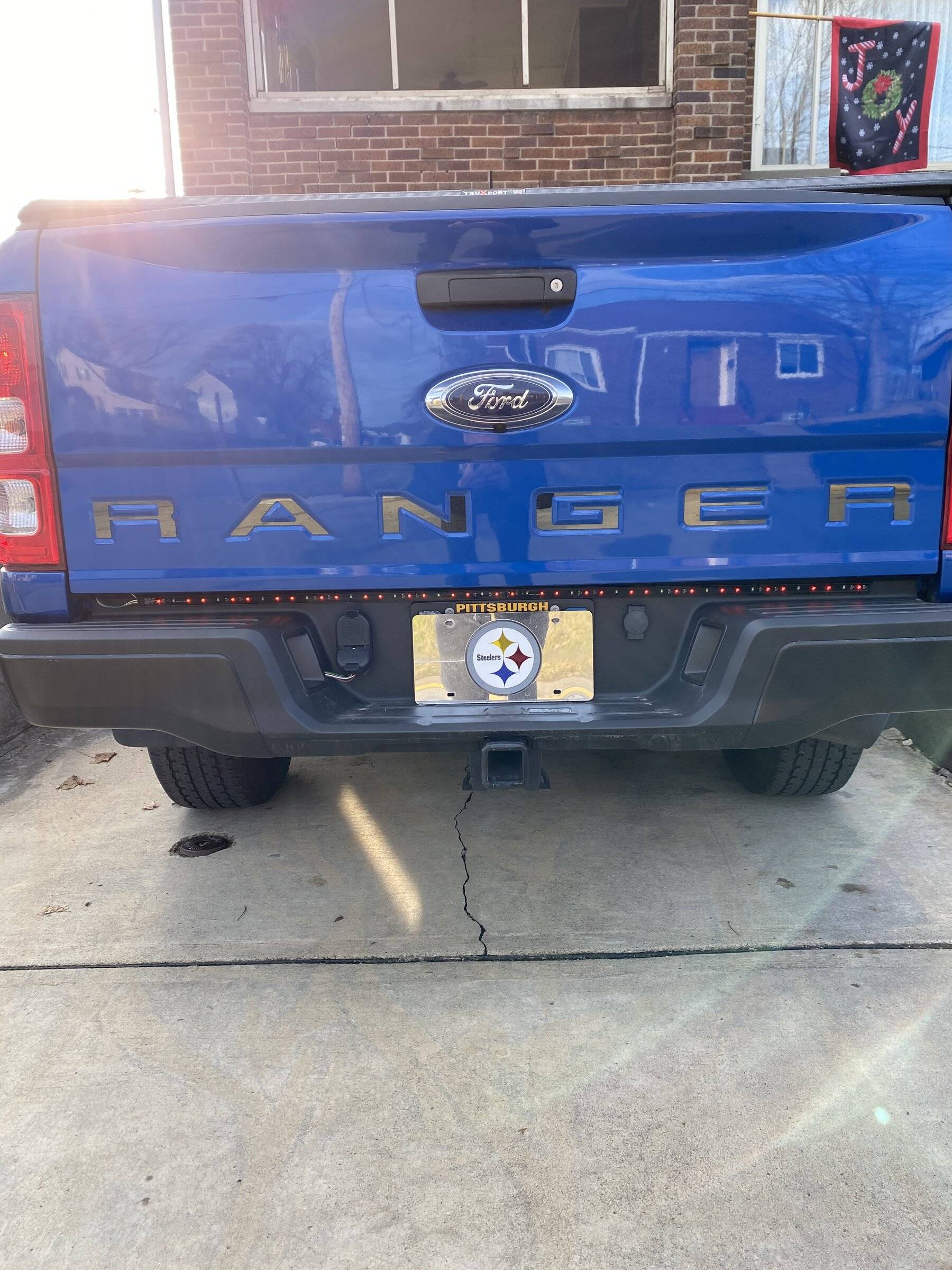

I ran the 4 pin plug wires down behind the left side of the bumper, attached it underneath with a zip tie or two, popped out the license plate light, and plugged it into the 4 pin plug. I have the tow package with both plugs next to the license plate.
I ran the backup light wire up to the left taillight and connected it to the backup light wire with a Scotchlock connector. If memory serves, I connected it to a yellow wire. There are two wires to the backup light socket so I had a 50/50 shot of being right and I guessed right the first time.
