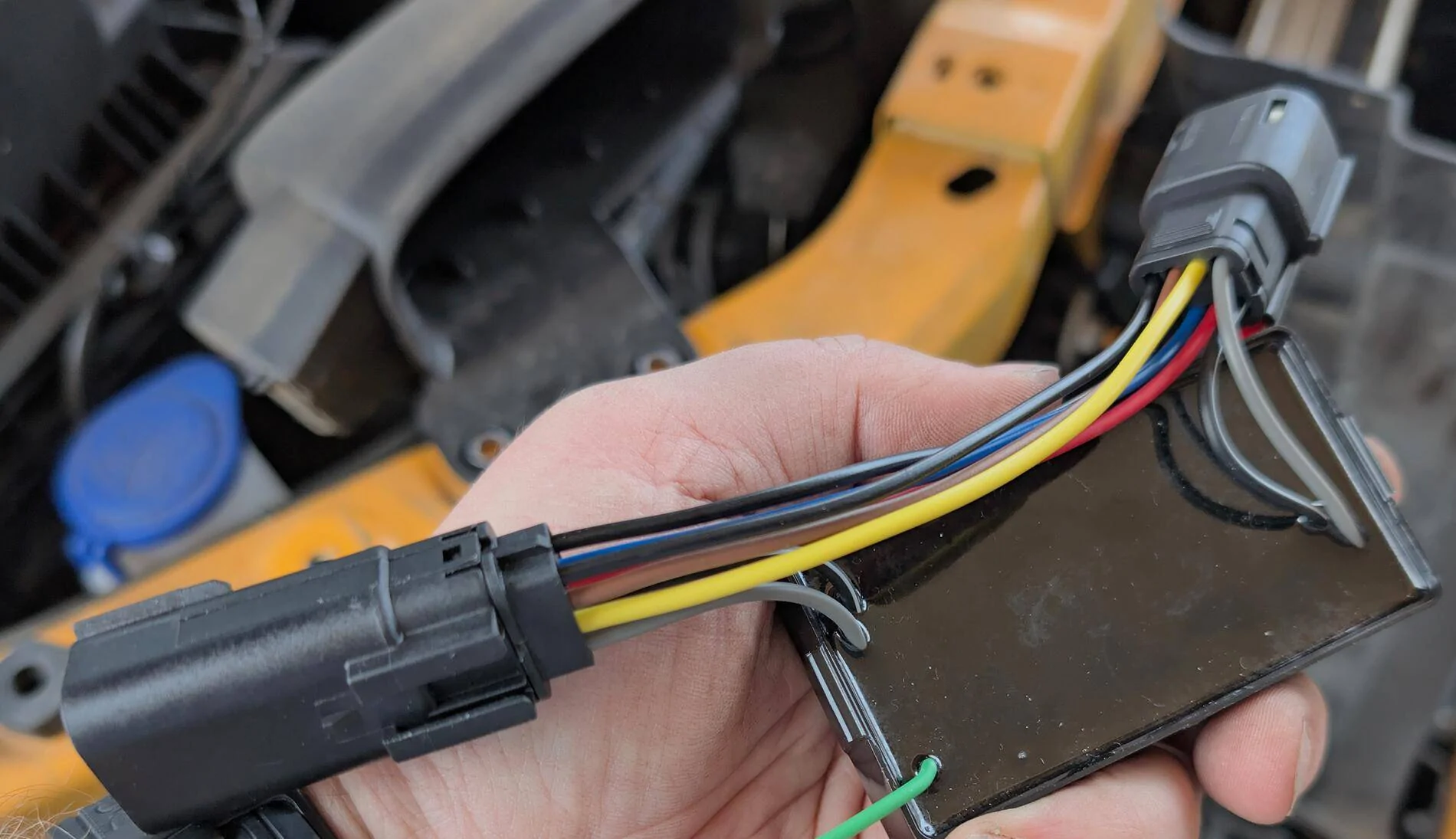

Thank you @ControlNode would you be able to provide a picture of that DRL spot on the connector? I am having a suspicion that since they erased my LED headlight and fog lights on my lariat they set it up just like they would a XLT with halogen lights but I don't know how to confirm that. I was looking at the alpha Rex pro series for right around 580 and then throwing in some Amazon LED bulbs. I will definitely give the anzo a look but it blows my mind that a $1,400 pair of morimoto's could have such issues.
I think you intended to tag me. Anyway, in this image the yellow wire is the one I added to fill the hole. it has no connection inside, just fills the hole. I know my XLT as the wiring on the chassis side to support the LED DRLs found on the Lariat trim. But, the connector on the halogen light housing has a plug in where I put the yellow wire.
